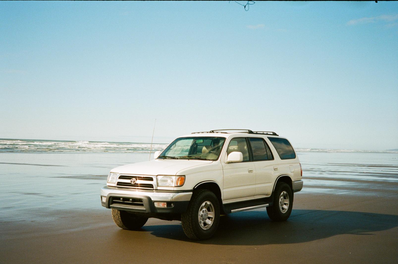

I spend 3-4 months per year on the road, living out of my vehicle and rock climbing. Planning to build this out as a function-focused rig optimized for use as a portable base camp.
The story so far:
- Purchased rust-free at 168k miles in Astoria, OR
- Taco antenna mod
- Installed Sony XAV-AX1000 CarPlay head unit
- New set of BFG KO2 265/75/R16 tires
- Minor fixes to solve some codes and annoyances (new throttle position sensor, O2 sensor re-grounding, AC flush)
- Tundra Brake Upgrade (199mm Caliper)
- Lifted (OME 880/906 + Bilstien 5100)
- LBJ replacement
- Radiator replacement (just in case)
- Killed the door dinger
- Sherpa Adventure Co roof rack with custom end caps
- Yakima Skyrise roof top tent with custom mounts
- Rear slide-out kitchen build (detail thread)
Upcoming projects:
- Locking hatch struts and a custom around-the hatch awning

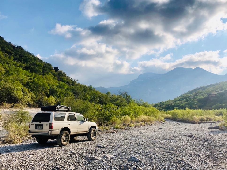

The biggest new addition is a roof top tent. I was able to pick up a discontinued-model Yakima SkyRise tent for about $770. This is my "solve for stopover" - most of the time living out of the rig, I'm base-camped in a nice comfy ground tent for 2-4 weeks at a time, but the RTT is going to come in super handy for 1-2 night stopovers while I'm on the move.
The Yakima mounting hardware was both over-engineered and didn't seem like it would hold up (way too much plastic and too many failure points). Instead, I direct-mounted the tent to a set of Sherpa Equipment Co. heavy-duty crossbars for a really clean, low-profile mount. Will post pics when my film gets back from the lab.

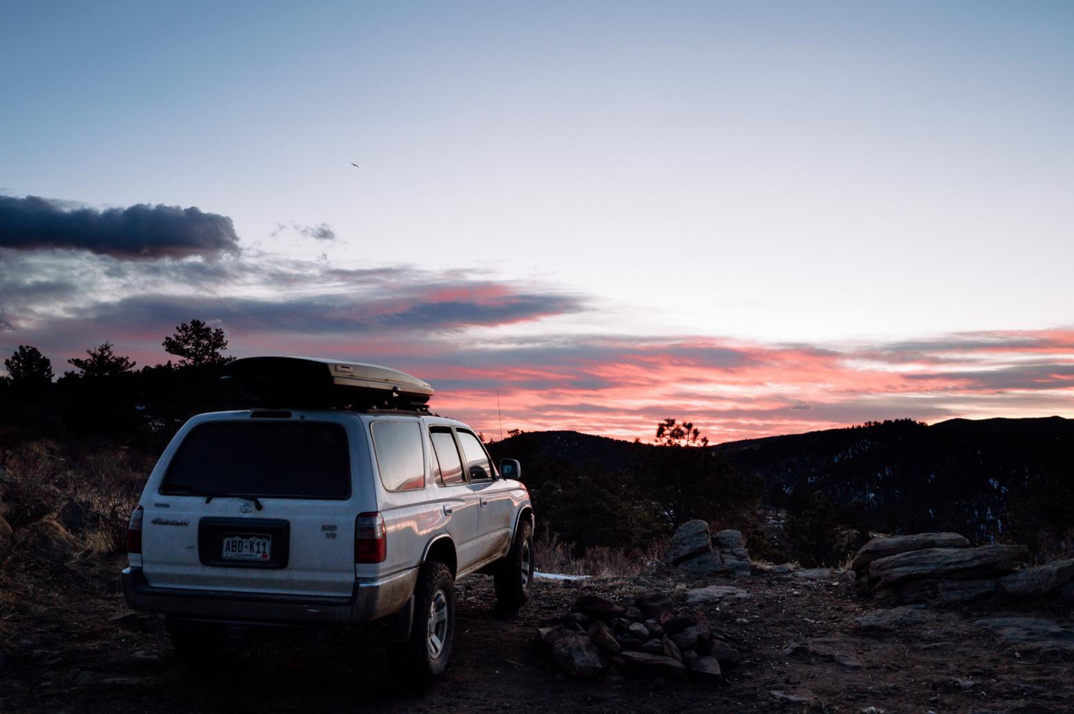

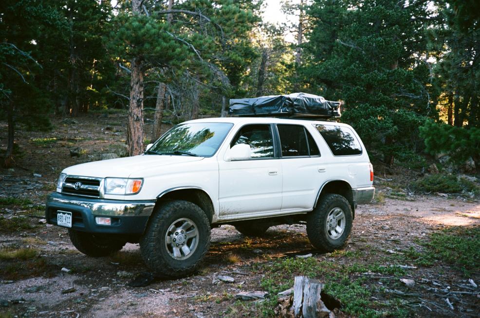

Quick pic from a recent camping trip. Custom RTT mounts are doing great.

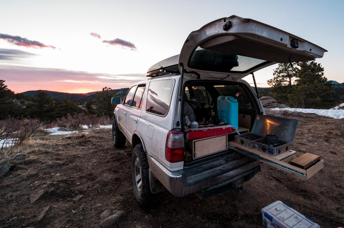

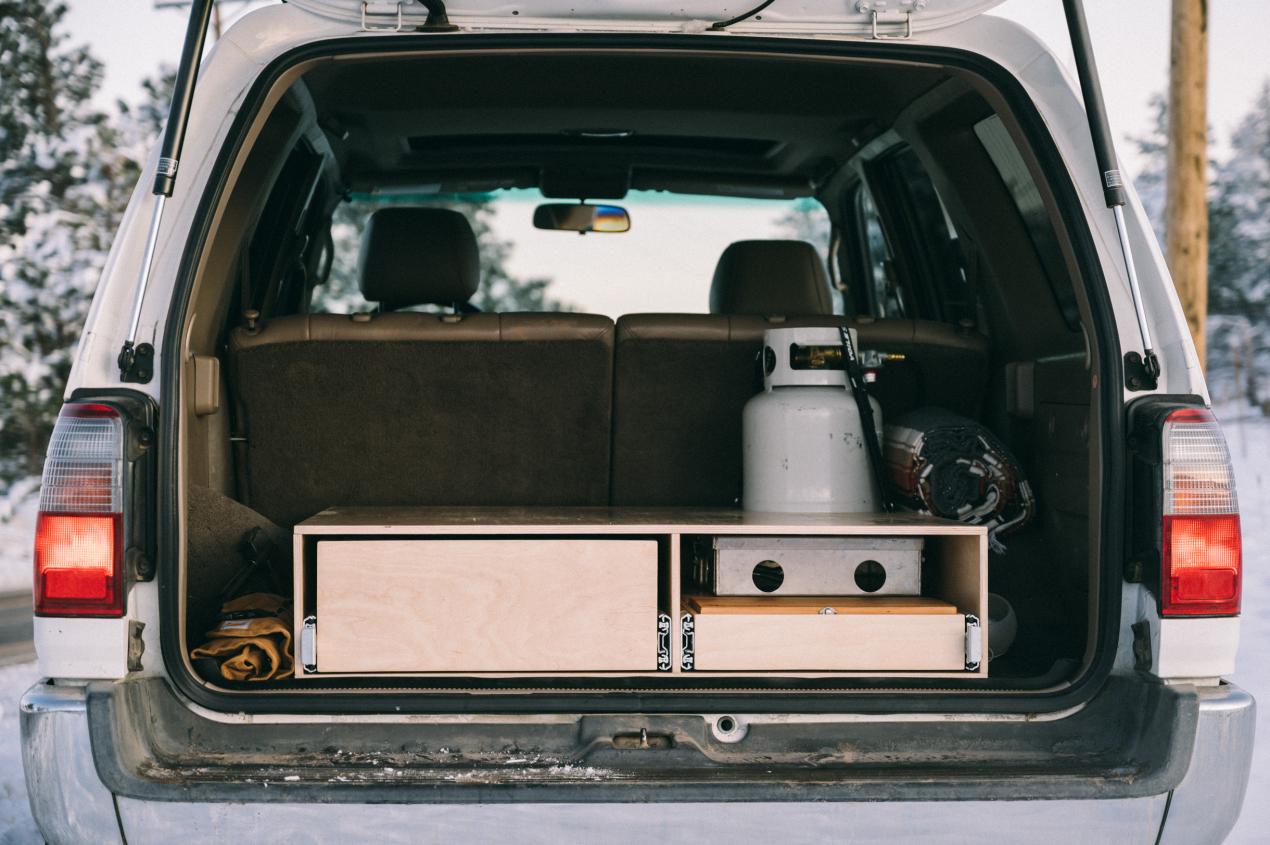

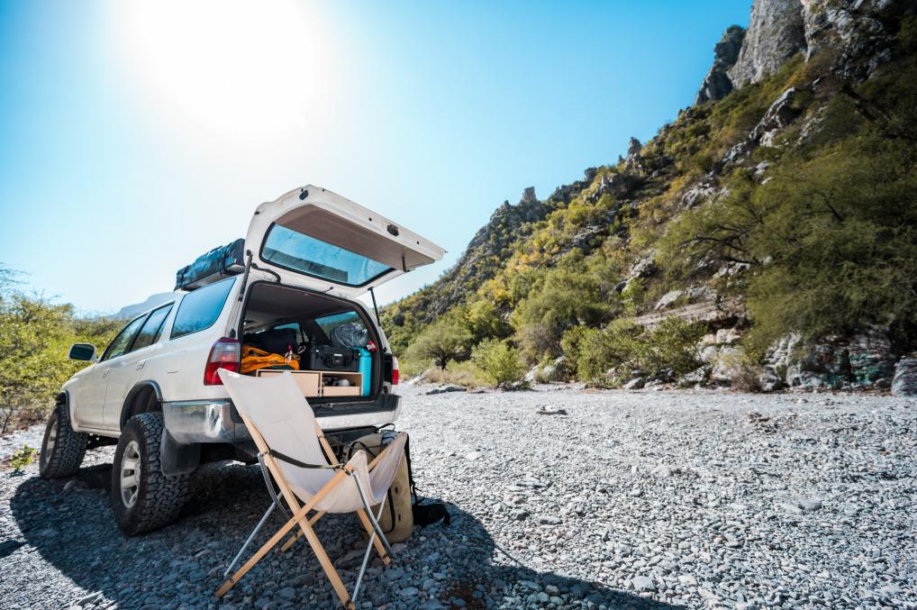

Kitchen drawers build was completed a couple weeks ago, and I've already done about a week of camping with it, in Escalante Canyon and Indian Creek. So far, I'm super happy with how it turned out, it's made food prep dramatically more efficient, with zero gear shuffling required to start cooking!
I've got a ton more photos and details about the kitchen build in this thread: Super clean cook drawer build

Been hanging around northeastern Mexico for the past two months on a rock climbing trip, here are a couple photos for your enjoyment! (climber in the picture isn't me)

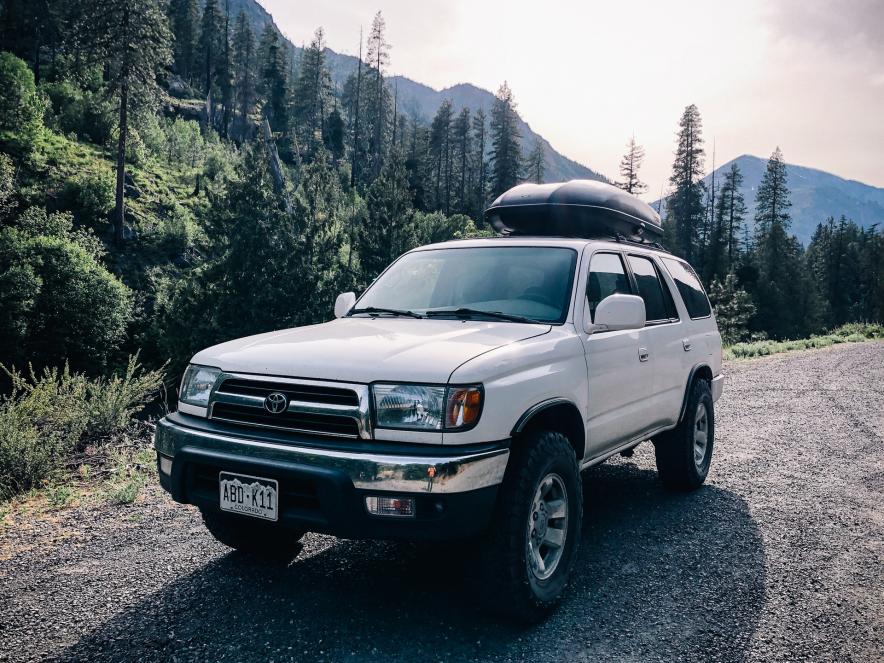

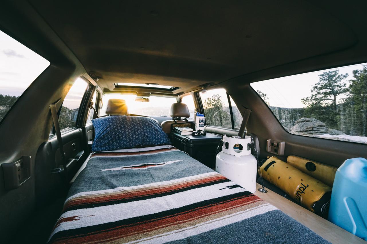

Back in Colorado for a quick pit stop. Ditched the RTT in favor of a more USA-friendly setup: sleeping platform inside and a big cargo box up top for all the mountaineering gear I'll need to haul for spring adventures. Getting the timing belt replaced this week, then it'll be off to Indian Creek for some desert climbing.
