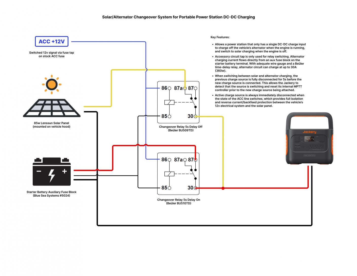

Currently in the thick of a new project to upgrade from a cooler that was perpetually full of melting ice to a solar panel + battery bank + powered cooler setup. Will probably do a separate write-up at some point but for now here's a preview:
