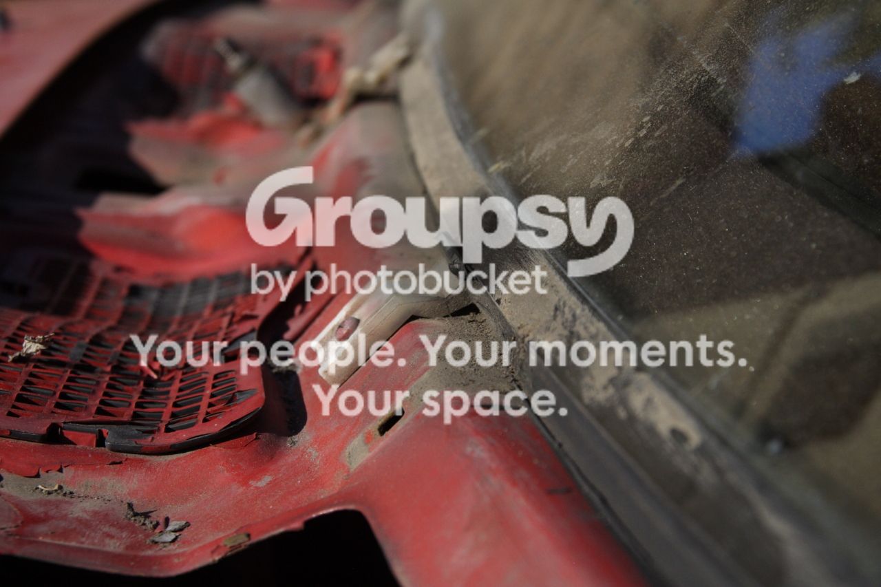

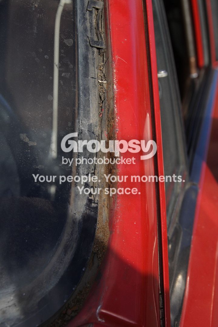

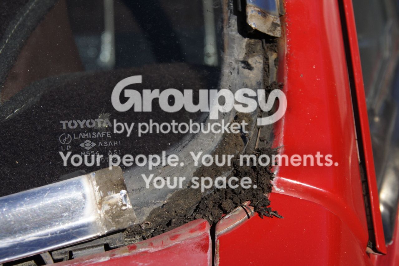

The Problem:

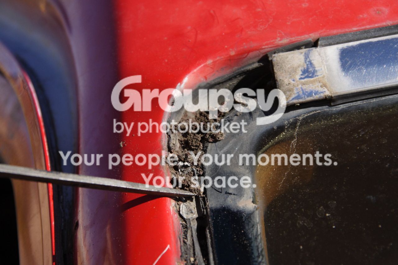

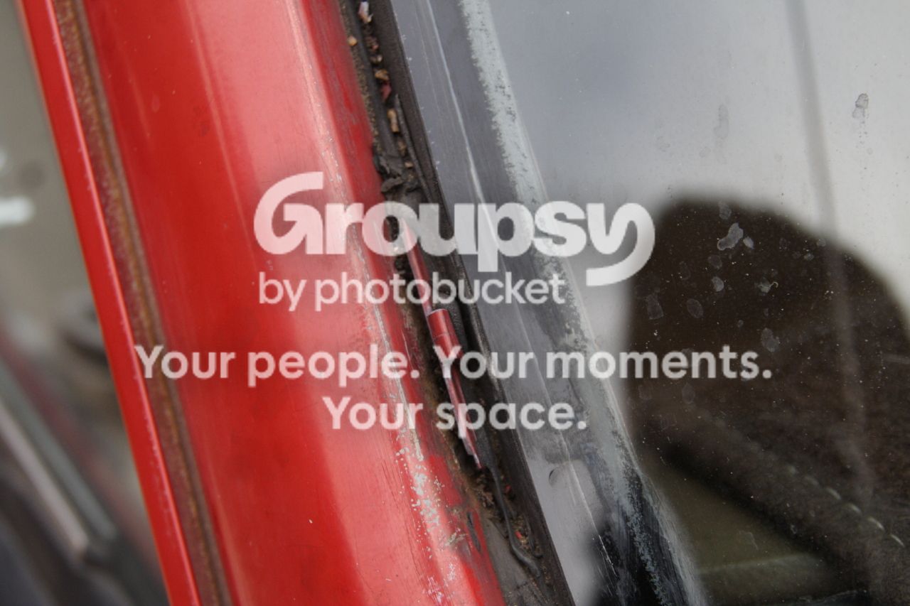

  • Chrome trim collects debris, catches and retains water, and worse yet, saltwater from ocean sports equipment.
  • Water prevented from draining or evaporation by being absorbed by debris and hidden behind the chrome trim soaks area around windshield. This hastens rusting, possibly by galvanic corrosion: 2 Different metals in an electrolyte (like saltwater or water with debris dissolved in it)
See how much debris it collects?
003_zpsaf0812fb.jpg~original
001_zpsd172d114.jpg~original

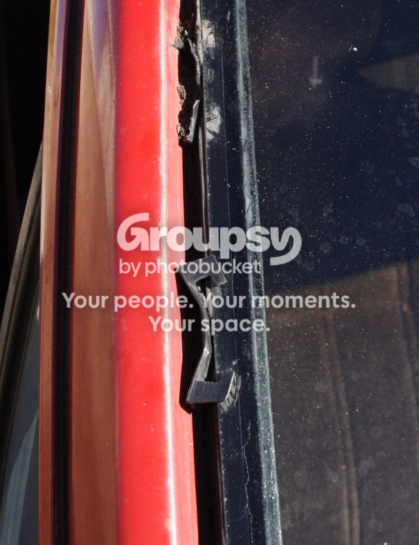

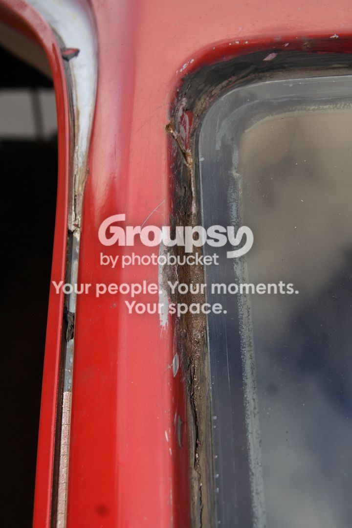

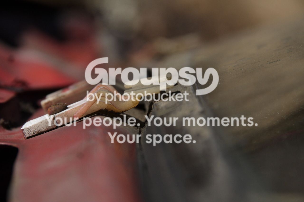

Rust is worst around this clip (Perhaps because there is a thin gap between the clip and the body that traps water):
024_zps434590d8.jpg~original
Clip above is near top corners and bottom corners:
026_zps613d9890.jpg~original
018_zps8e1d7d65.jpg~original
For some reason, the areas near this type of clip are not as bad (as you can see, gap between this and body is bigger, less likely to trap water):

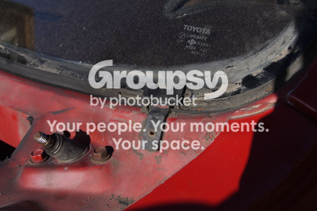

The windshield rests on two of this white clip below, so this is probably structural. Needed to keep windshield in position when installing:
017_zps3c7e9df0.jpg~original

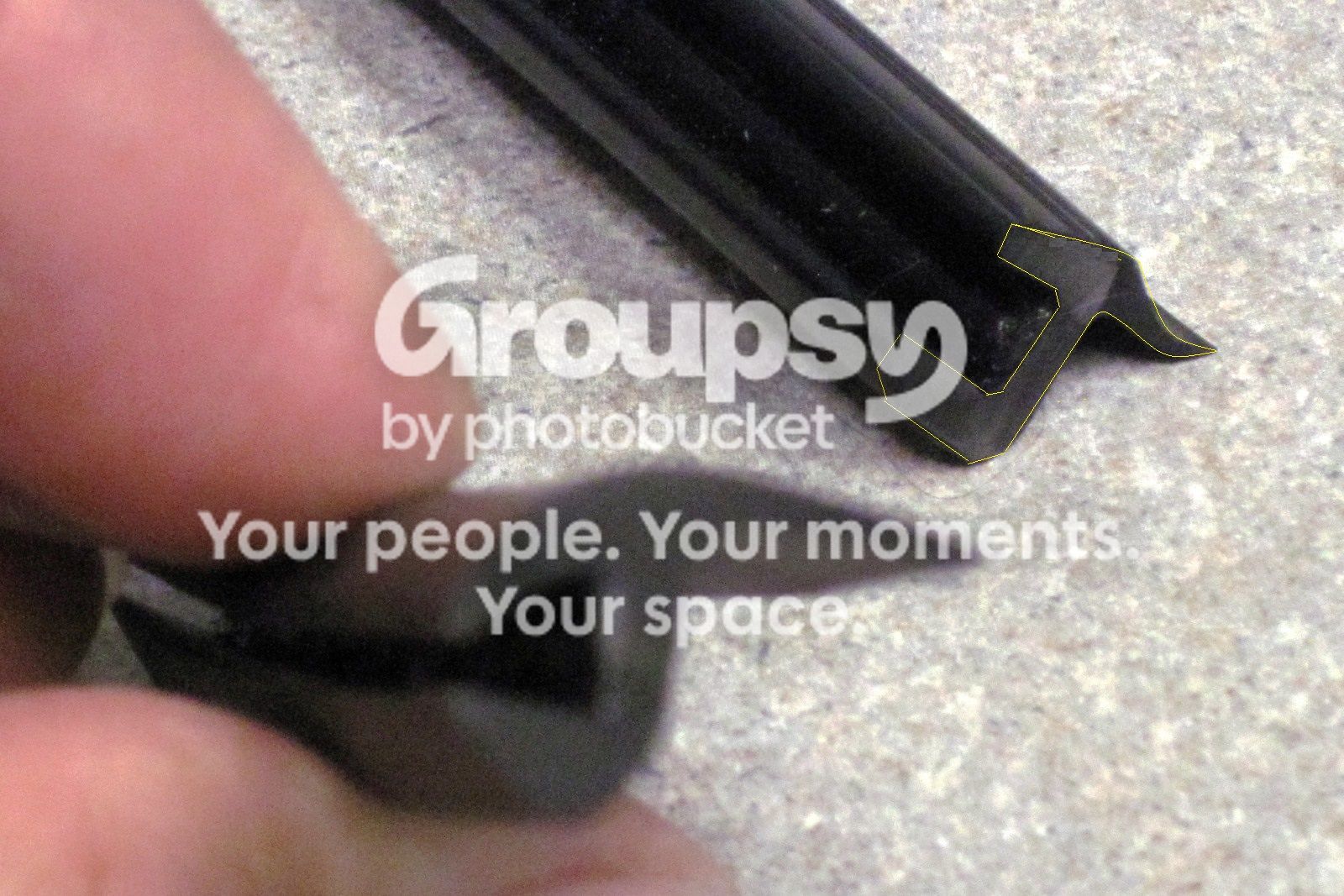

Update 20140304:

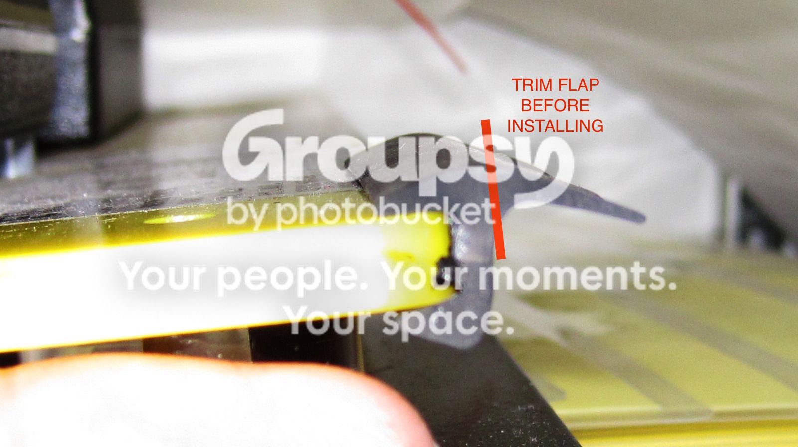

Safelite has this kind of trim. Although I want to seal with silicone this type trim is good because it will protect edge of glass from accidental stresses. My glass cracked after I pulled chrome trim and dug clips out. BE CAREFUL!
002_zps2cd01f25.jpg~original
Would install like this:
003_zps2e8ea8da.jpg~original
As you can see, probably needs to be installed on glass before glass is attached, therefore would only work If glass were removed (like in my case).

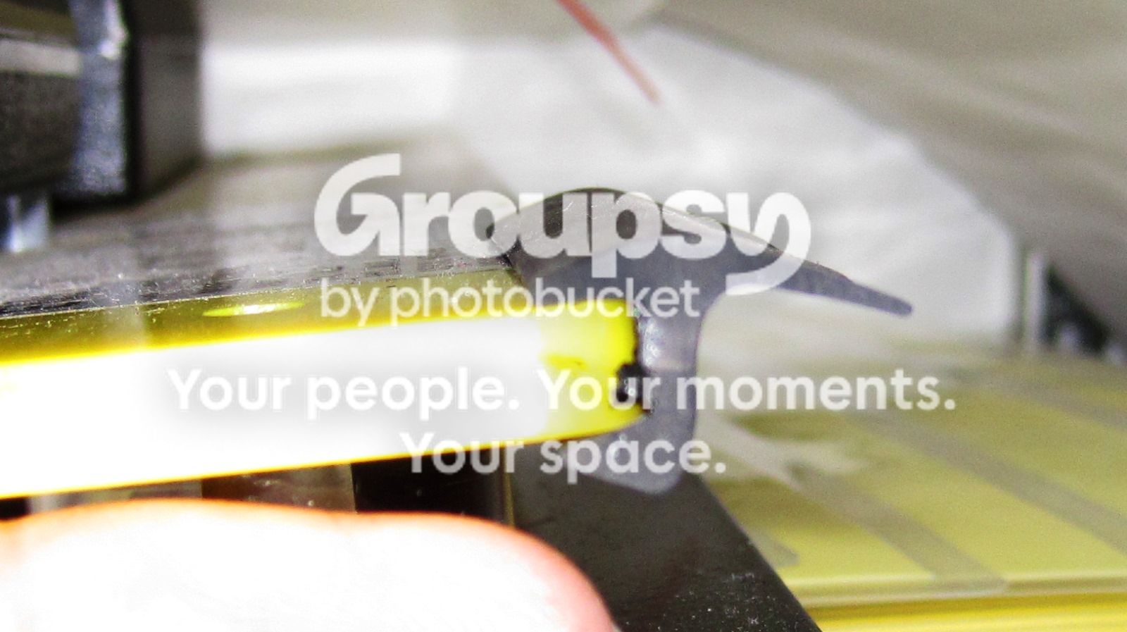

This is how I would fill gap with silicone:
Mark where 'flap" contacts body (around windshield).
Mask with masking tape for cleaner silicone coverage, and ease in removing of excess silicone.
Lift "flap/wing" up and out with finger, Inject silicone bead to fill all gaps.
Inject silicone to fill gap.
007-Copy_zps1779d9fd.jpg~original
Or, to keep it simple although not pretty, cut wing/flap off with X-Axto knife, then fill gap with silicone.
Plan is getting more mature...
I want my windshield installed like a Corolla's rear window... No trim to retain moisture and catch debris. Easy to clean.

A trim attached only to edge of glass, but not touching body/paint like in sketch above ^^^ is still an option to protect glass edge from accidental stresses.

The Problem:
A trim attached only to edge of glass, but not touching body/paint like in sketch above will protect edge of glass from accidental stresses.

Universal rubber trim installed on glass:
20140625_008_zps677df24d.jpg~original
Thin layer of urethane adhesive applied to inside of glass... all the away around:

Need to revise write-up because original solution failed. During original install the flap of the rubber trim was pushing against the body. I think it prevented proper sealing by the urethane. Even I if I had silicone sealant over the urethane, it still leaked.
Chrome trim is only there for looks. IT IS ACTUALLY BAD for the body. It catches and TRAPS debris and worse yet, saltwater dripping from water sports equipment.
IF you only have freshwater dripping on your windshield, the rubber gasket like on old VW Beetles may work. However, water still seeps into the interface between rubber and body metal and stays there longer than if it were openly exposed to air. For saltwater exposure...
HERE's the FINAL SOLUTION:
Safelite replaced under warranty as follows:
Removed old glass
Removed old sealant
Applied rubber trim around glass. Trim is not used to seal. It is cosmetic but helps protect the edge of glass from accidental stresses.
20140625_007_zps7ad1df00.jpg~original
Notice how the corners curl up? When glass is placed on bead of urethane, that curl will push glass away from the body, UNLESS something is used to clamp glass toward the body.
I want the gap to be well-exposed to air and not hidden to allow easy cleaning, rinsing and quick drying, so I asked glass tech to CUT OFF the "wings/flap" before installing the glass. No actual pic but here's an illustration:
003_zpsqbepuhgy.jpg~original
Installed glass as usual. Left gap so it does not TRAP debris and is easy to rinse/clean. It does not look bad. Even IF it looked ugly, I'd rather have an ugly gap than rusted body around windshield.
