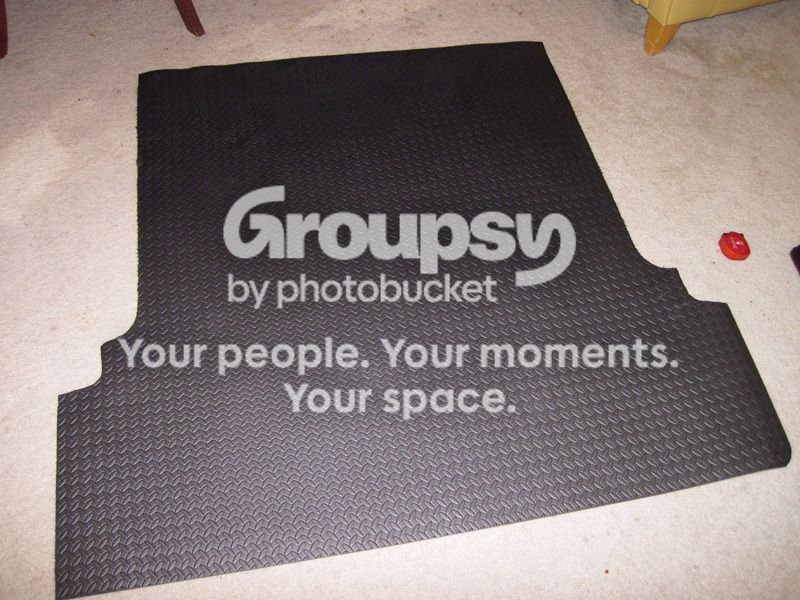

  • Best Step Anti-fatigue mat primarily for insulation and cushioning on rear deck. @$22 from Sears. Remaining material was used from under front seat to under rear seat.

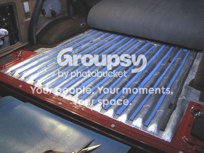

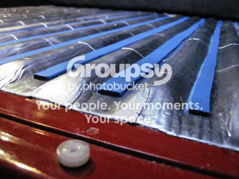

REAR DECK APPLICATION:
Applied P&S & built up the valleys with some rubbery material I happened to have. Remnants of the anti-fatigue mat above would work, too.
050.jpg~original
051.jpg~original

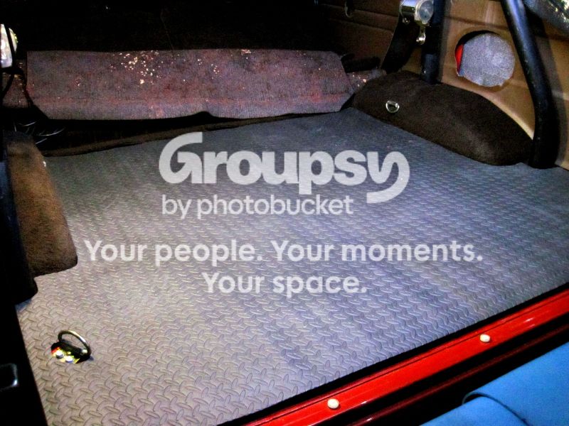

Trimmed anti-fatigue mat to fit around wheelwell, and tie-downs:
060.jpg~original
061.jpg~original

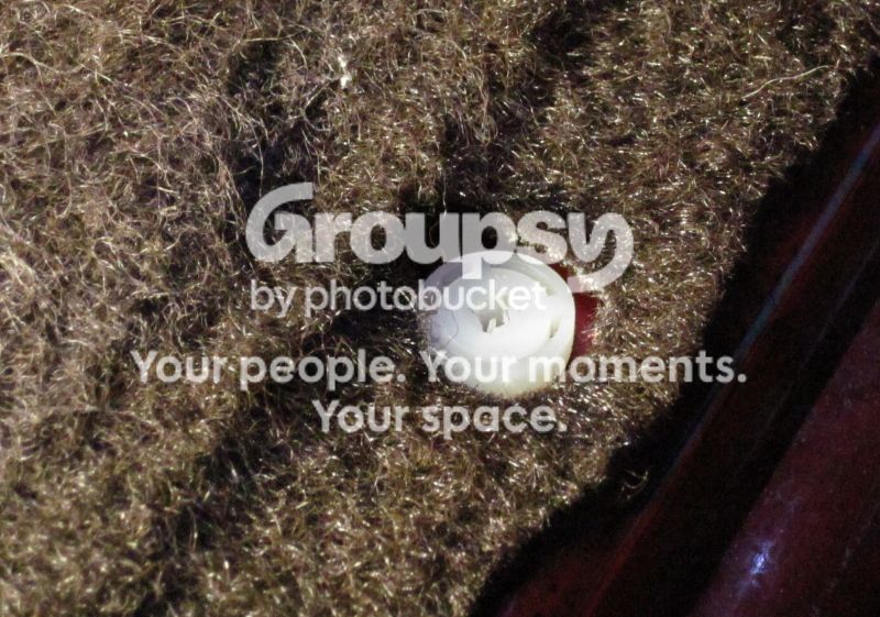

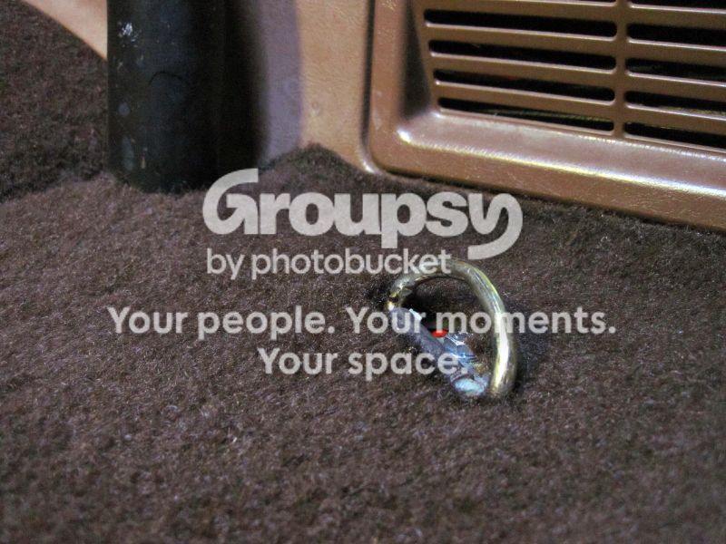

Got idea from Chef who has an SR5 to secure carpet to expansion nuts.
074.jpg~original

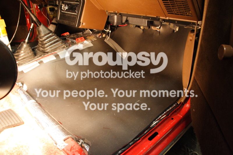

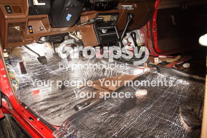

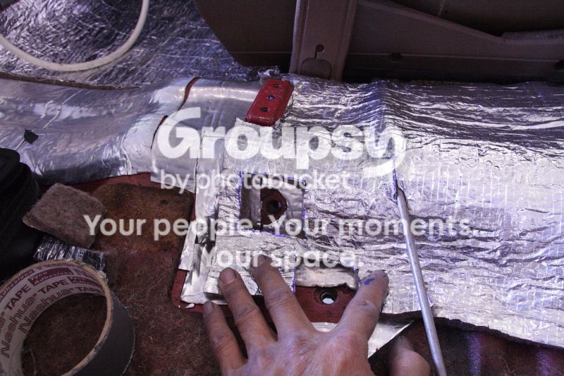

DRIVER'S SIDE
Kept stock vibration-damping material. Used remnants of Thermo-Shield to build up valleys. Here you'll also see P&S on tranny hump and double-layer on accessible areas of firewall.
000.jpg~original

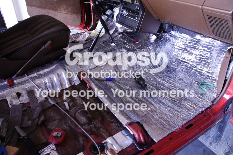

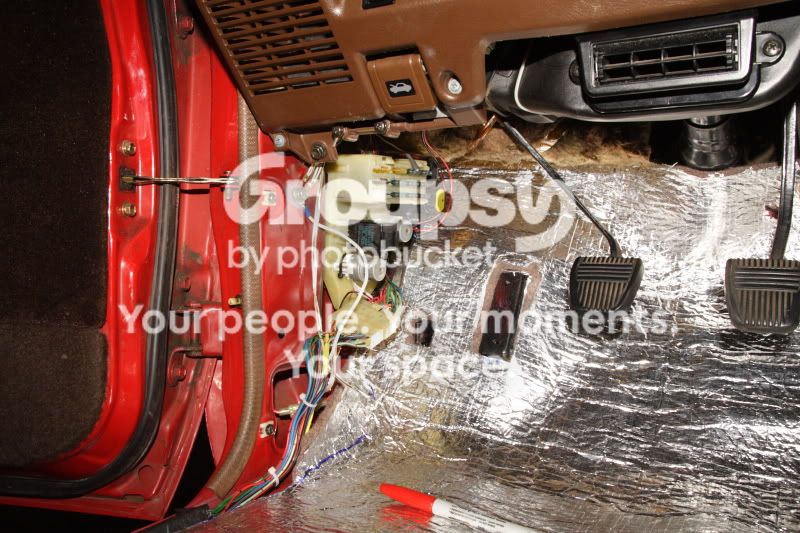

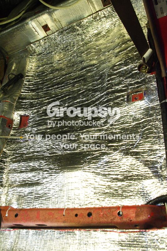

Applied Thermo-shield from firewall all the way back to passenger floor. Exhaust pipe is below all that.
20121103_012.jpg~original
I would eventually fine-trim around kick panel. Still need to modify footrest to fit all that added thickness.
20121103_015.jpg~original

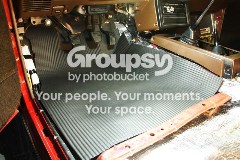

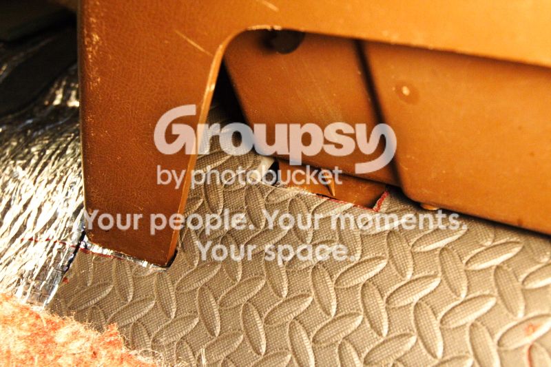

Next layer is 3/8-inch thick exercise mat as high as I could access on firewall. Seemed a better acoustic insulating material than the anti-fatigue mat. I initially calculated to put Ensolite here but turned out it was not needed anymore; Ensolite's benefit would be insignificant compared to this 3/8" think foam.
20121107_014.jpg~original

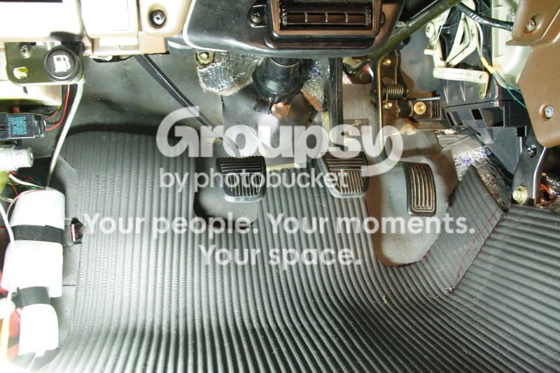

Needed cut-outs to clear clutch and gas pedal travels.
20121107_015.jpg~original

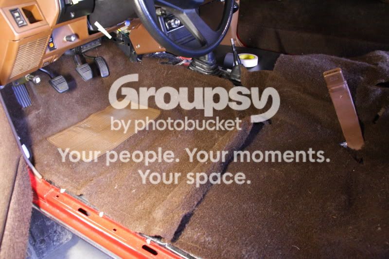

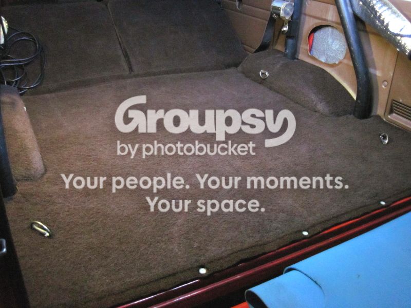

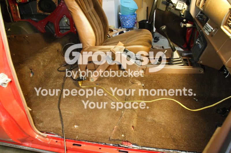

Carpet back on:
20121107_035.jpg~original

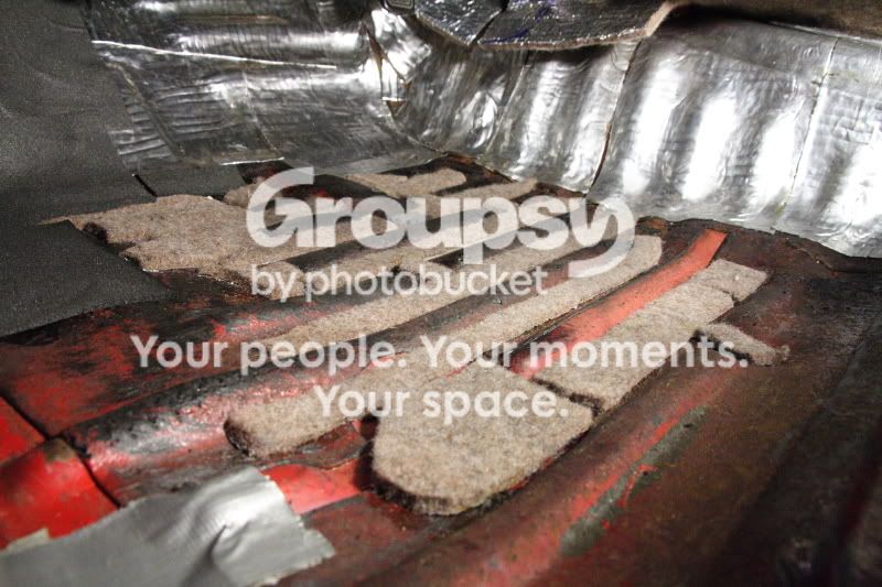

LEFT-REAR PASSENGER SECTION

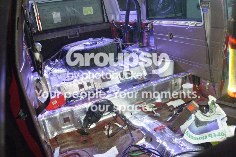

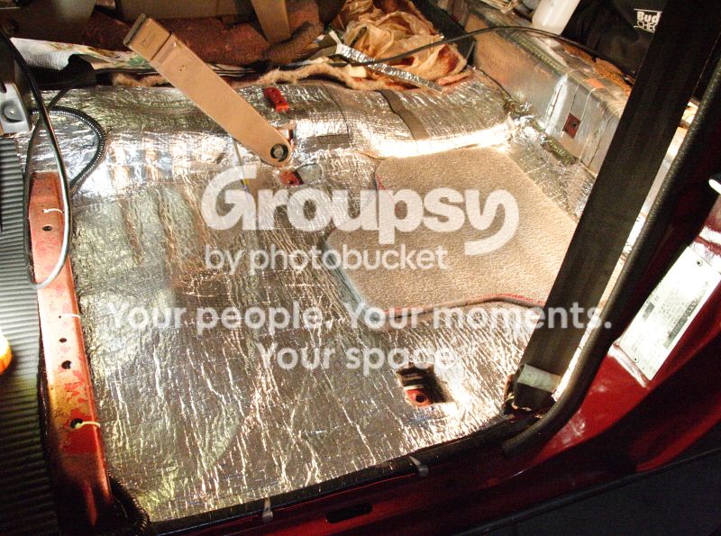

This is above the exhaust so Thermo-Shield was needed:
010.jpg~original
There was a little dip and I happened to have packaging foam sitting around so why not put extra insulation?
020.jpg~original

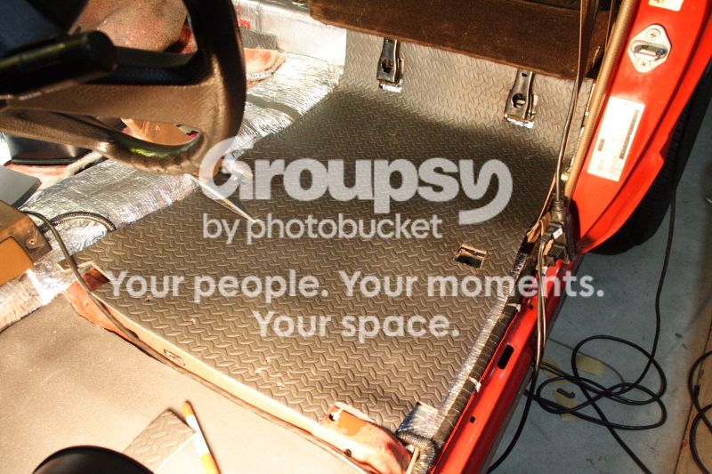

Anti-fatigue mat.
030.jpg~original

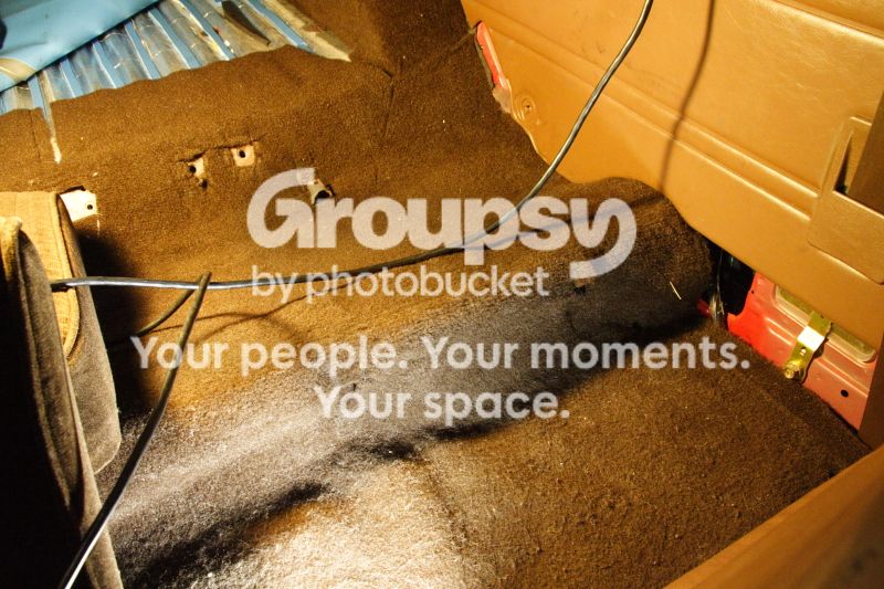

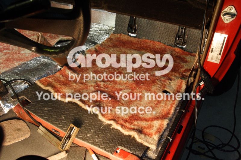

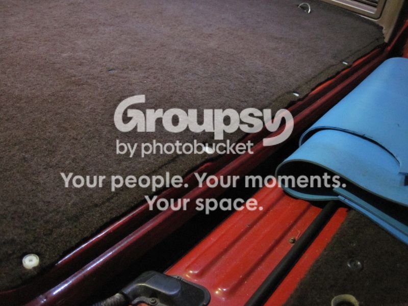

Plenty of room to build thickness so original carpet padding came back.
040-1.jpg~original
Carpet back:
060-1.jpg~original

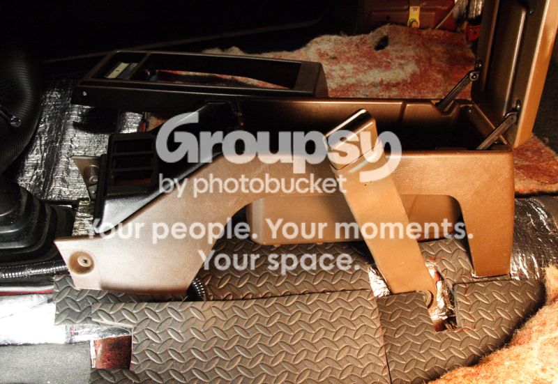

TRANSMISSION HUMP/CONSOLE:

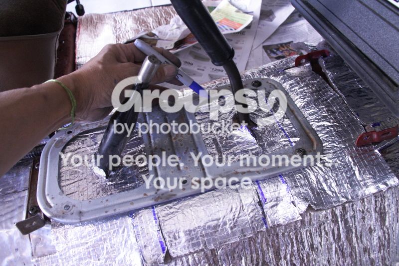

Peel & Seal applied then Themo Shield:
Traced out cut-outs for shift lever cover:
010-1.jpg~original
030-1.jpg~original

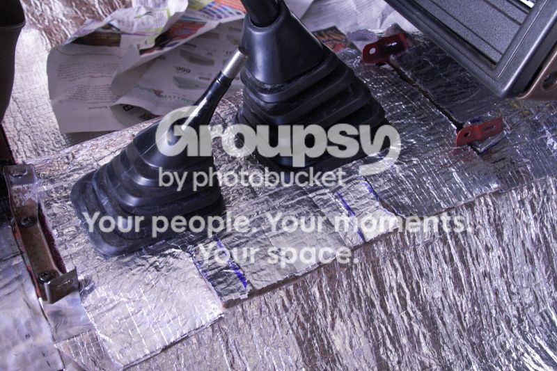

Thermo Shield on the rest of hump:
040.jpg~original

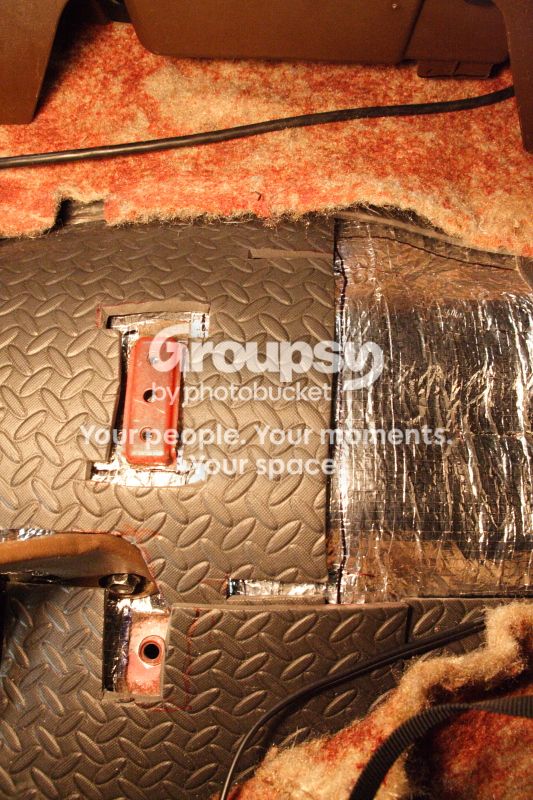

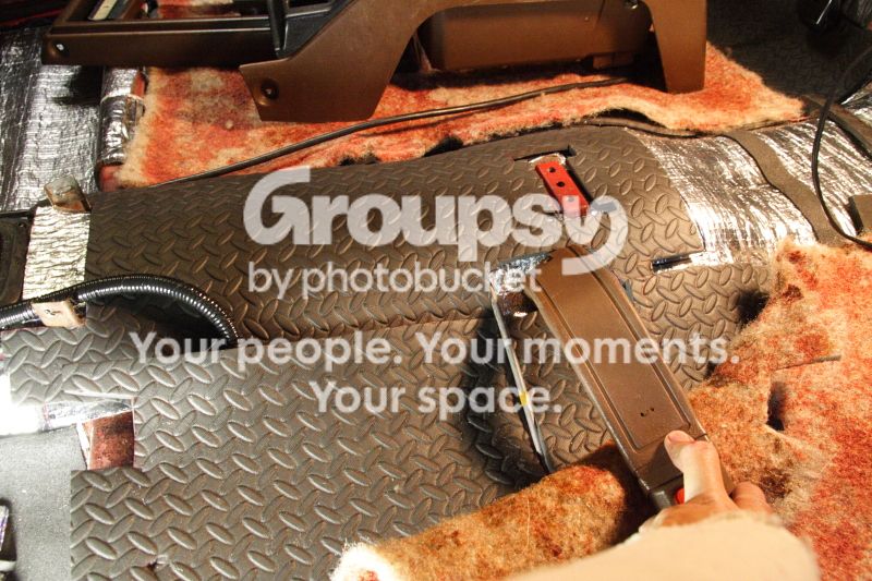

Then anti-fatigue mat on:
20121107_026.jpg~original
Anti-fatigue mat has clearance openings to minimize bulk and accommodate console & seatbelt where necessary:
Flexible conduit on left protects wiring for relocated console switches.
20121107_028.jpg~original
20121107_032.jpg~original
20121107_024.jpg~original
Carpet back:
002.jpg~original

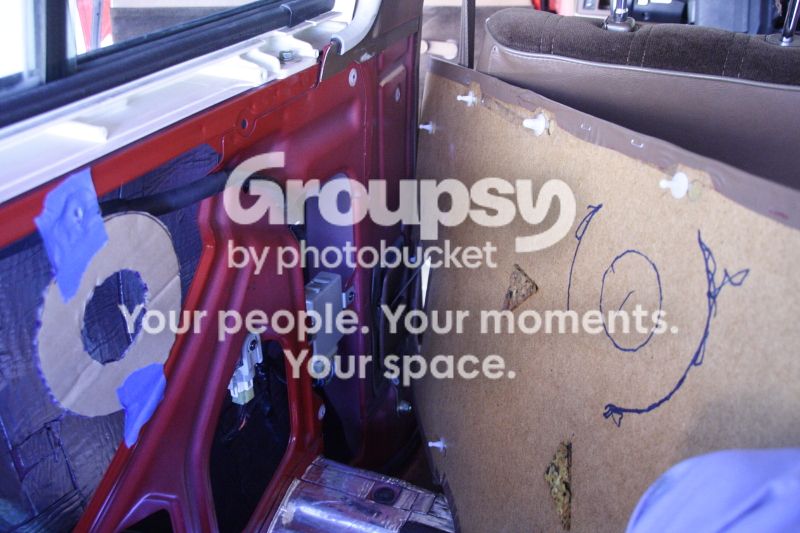

SIDE PANELS / SPEAKERS

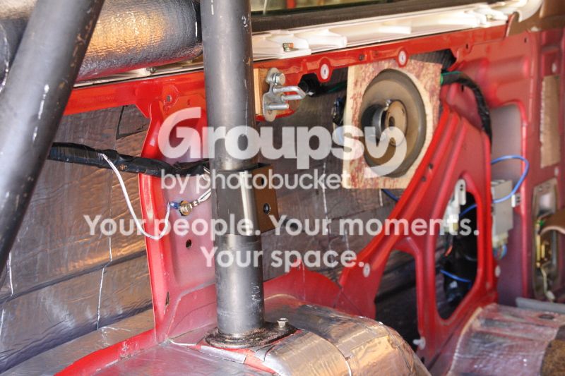

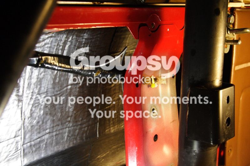

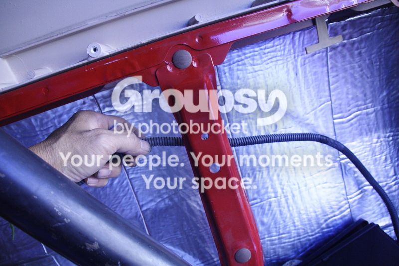

Peeled & Sealed side panels. Note that later, I would relocate harness so it is completely behind columns (insteadof zig-zagging in front and behind columns) to simplify future work on panels.
P_S002_zpsc98d2569.jpg~original
Before (Harness snakes to front and behind columns):
001-1.jpg~original
After (harness now behind columns):
006-1.jpg~original
006.jpg~original

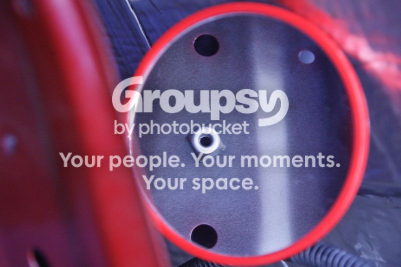

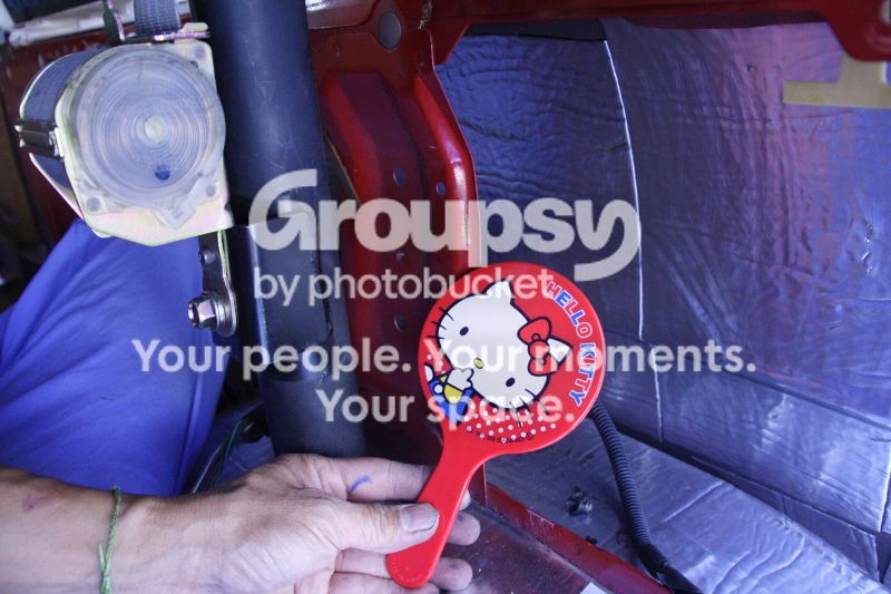

Ground points also relocated to behind the columns. Nut sanded down to bare metal is seen here through my inspection mirror:
007.jpg~original
My inspection mirror:
008.jpg~original
Correct, I am not insecure =D

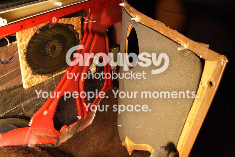

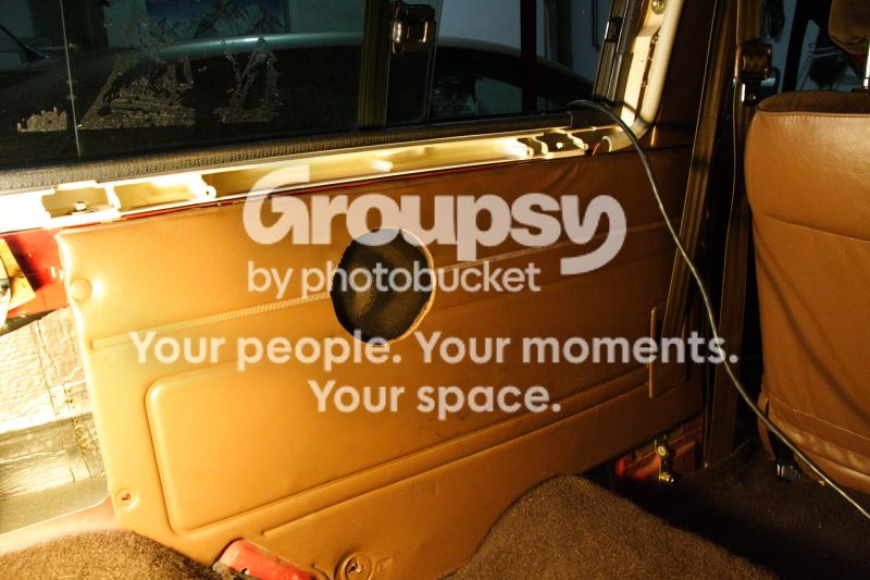

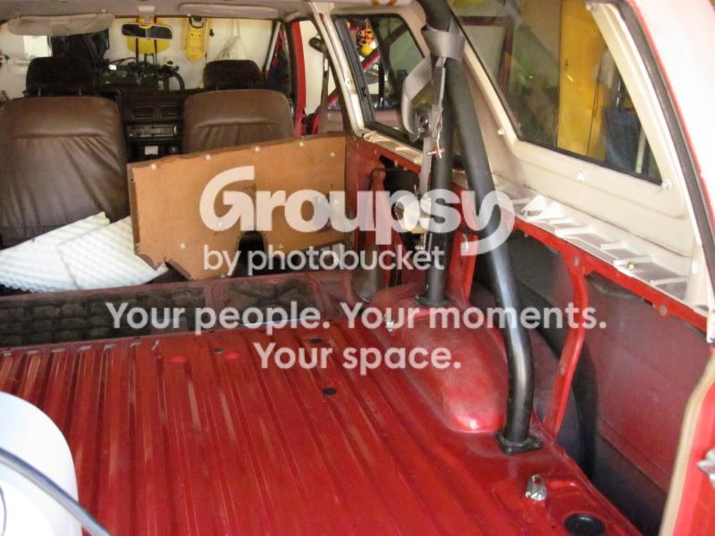

Also relocated 6x9 speakers to side of rear seats:
Speaker is mounted behind the particle board "ring". Grill mesh that came with speaker covers it.
Opening is sized and centered for 6.5-inch woofer so it's flexible. No need to open up completely for oval. (Oval woofer is worn out. Haven't decided what replacement to use, yet). What matters most is the tweeter is completely exposed, and most of the speaker cone faces free air. I'll make that pretty later.
002-2.jpg~original
I had enough of the RAAMAudio Ensolite so I applied to back of the side panels.
20121112_011.jpg~original
20121112_013.jpg~original
