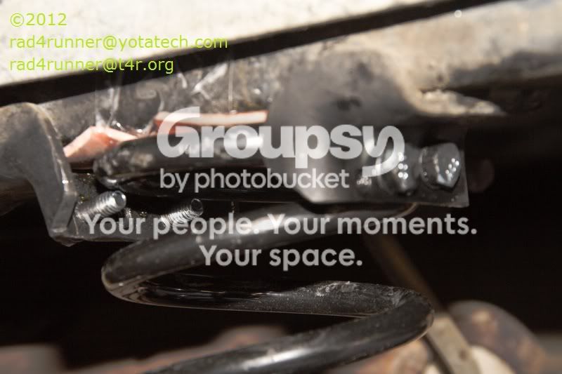

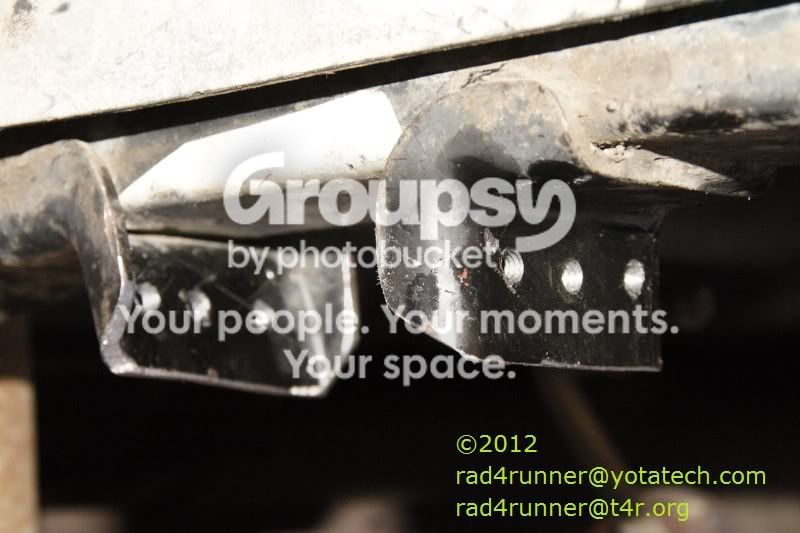

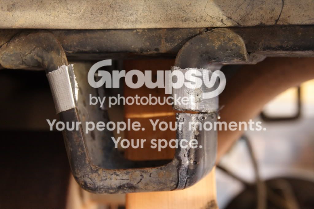

Zuk Mod Using 12-INCH, 125-Pound/Inch Black Magic Springs
(Did this a couple of years ago and have been happy with it so sharing...)

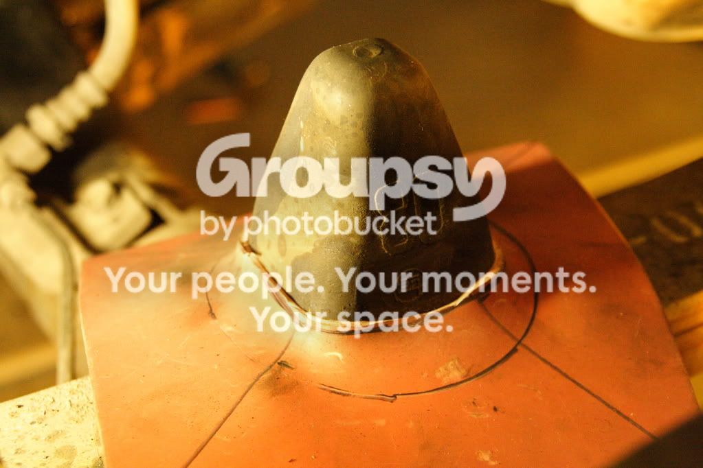

Bump Stops Cut to 0.75 inch from frame.
007.jpg~original

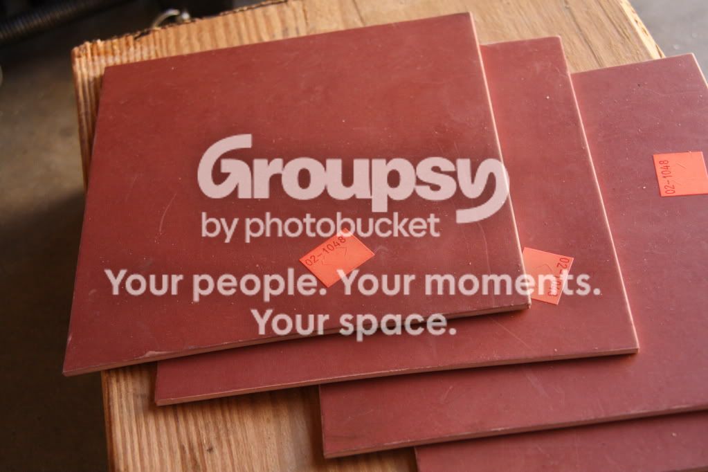

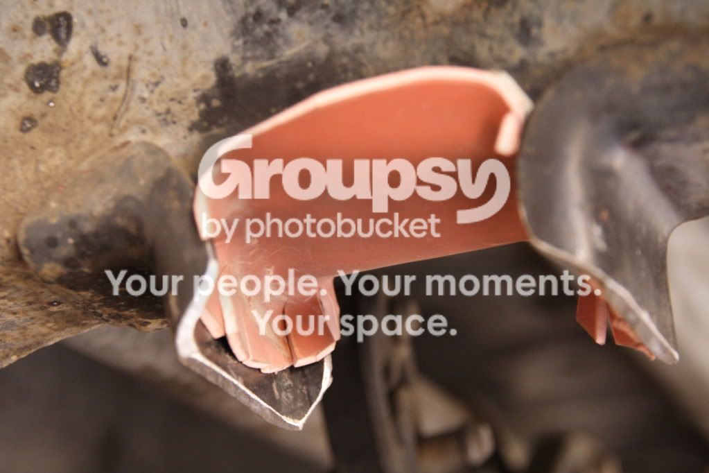

Needed spring pads to eliminate any metal on metal (spring to frame, spring to lower bumpstop bracket). Originally wanted to use durometer 75A urethane (same material as suspension bushings & skateboard wheels), but too expensive. Ended up using rubber pads from Marshall Industrial Hardware. Pad is 1/8-inch thick.
010.jpg~original

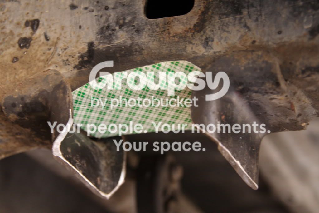

Use 3M double-sided adhesive tape stick to frame.
011.jpg~original
012.jpg~original
I put this pad on bottom bumpstop bracket but spring & bracket cut it. (A modified bottom perch that captures/cups the spring, if I could fab one, would be ideal.)
014.jpg~original

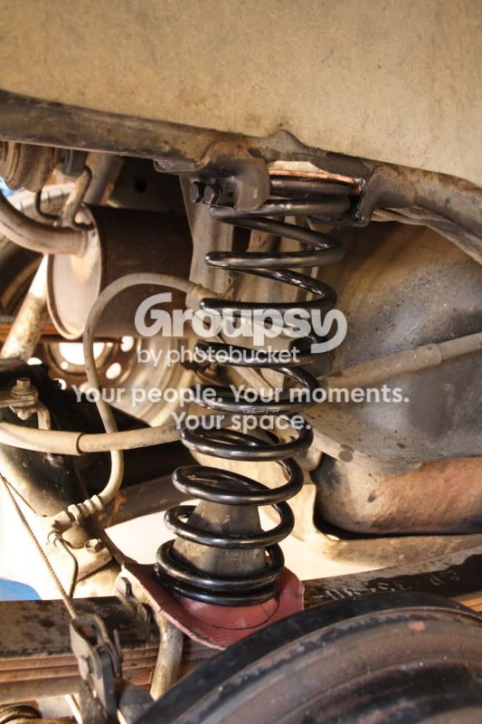

Capture Screws:
Drill and tapped for 1/4-20 screws (ideal would be 6-mm), 0.5 inch from frame @ 6 places per bumpstop for capture screws This is for more flexibility where to place capture screws where they would get the least stress.
Capture screw threads centered 1/2 inch from frame.
008.jpg~original
Just right for 1/8-inch thick rubber spring pad plus 3/8-inch dia spring material.
011-1.jpg~original
Using Black Magic springs rated 12-inch, 125 pounds/inch.
012-1.jpg~original

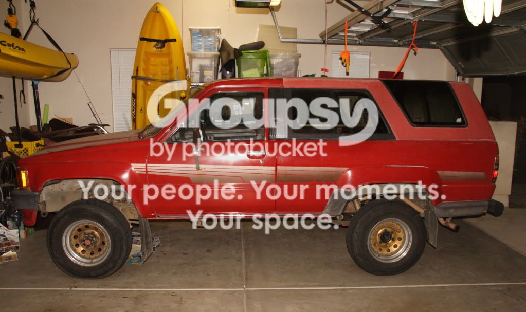

No Noticeable Rake! :)
019.jpg~original
Wheel rim to wheel well rim in front: 14"
Wheel rim to wheel well rim in rear: 12.5"

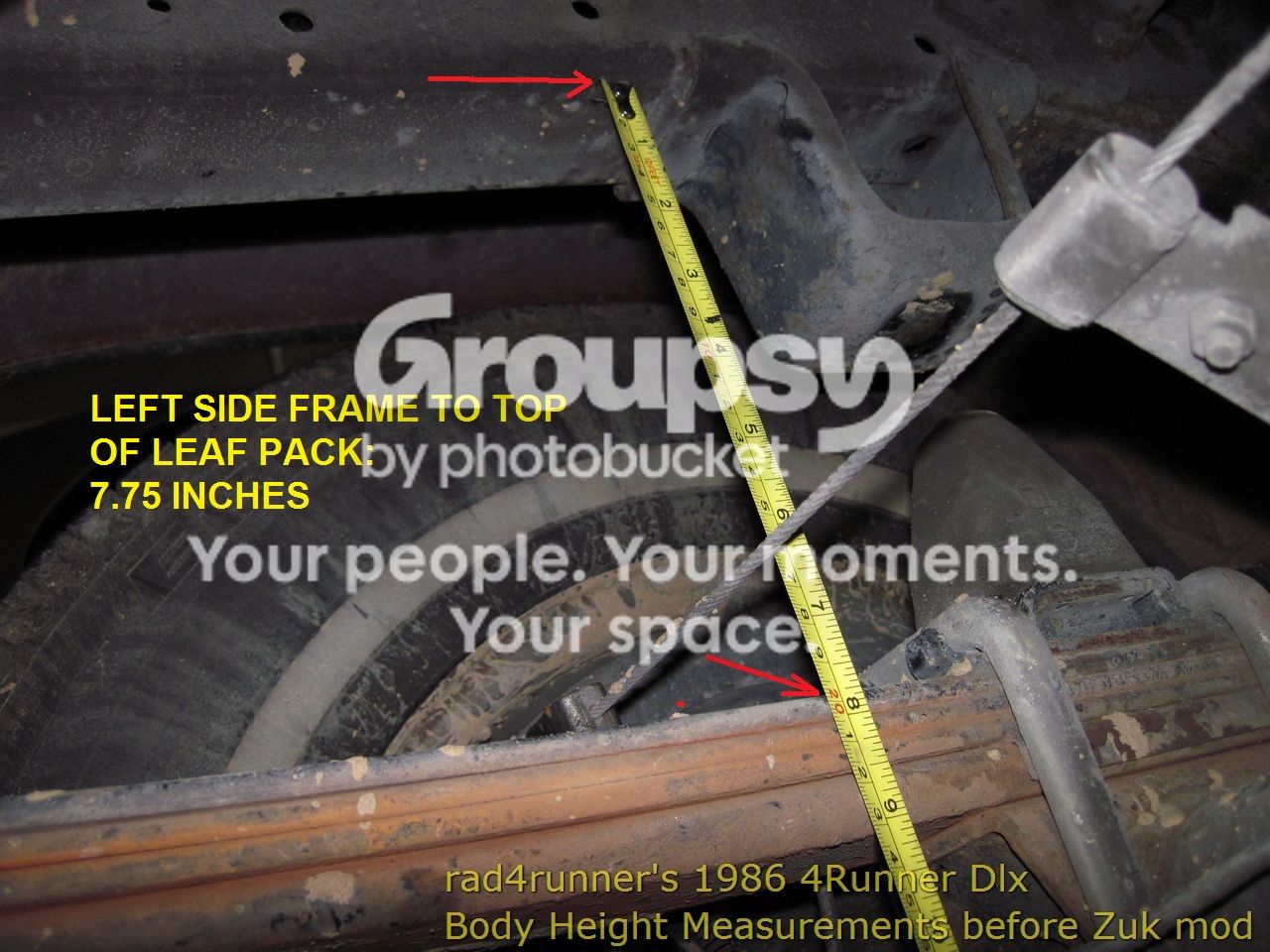

Frame to Leaf Pack:
012_zps130d0516.jpg~original
Before (7.75 Inches, on both sides):
After: 9.25" (As of 22Mar2013)
Thanks to Yotatech members for all their earlier inputs, especially Chef's, regarding the 12-inchers.

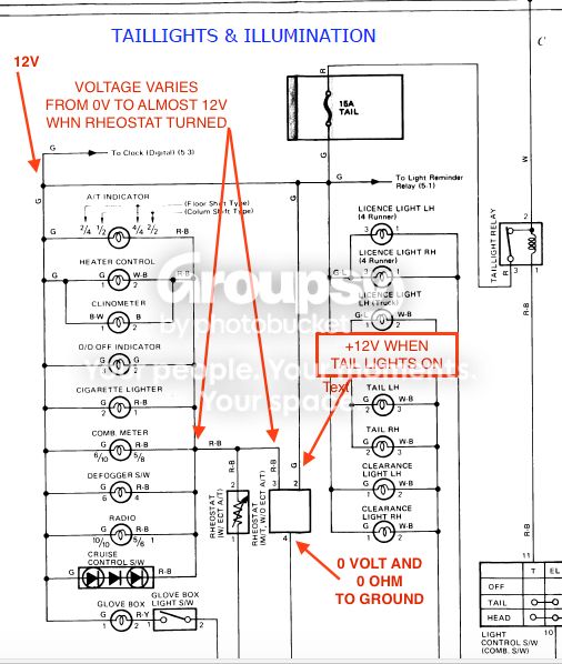

Troubleshooting Dash Lights
If tail lights work, but dash lights do not work and turning the dimmer does not fix it, before tearing the dash apart, take a few voltage and resistance measurements at these points, all referenced to chassis ground (bottom of A-Pillar, next to driver side door/kick panel).
GREEN wire supplies 12V.
Red and black wire supplies ground.
Turning dimmer switch varies resistance to ground and adjusts brightness.
Measure actual resistance of gnd side of rheostat to ground (usually white wire-with black stripe).

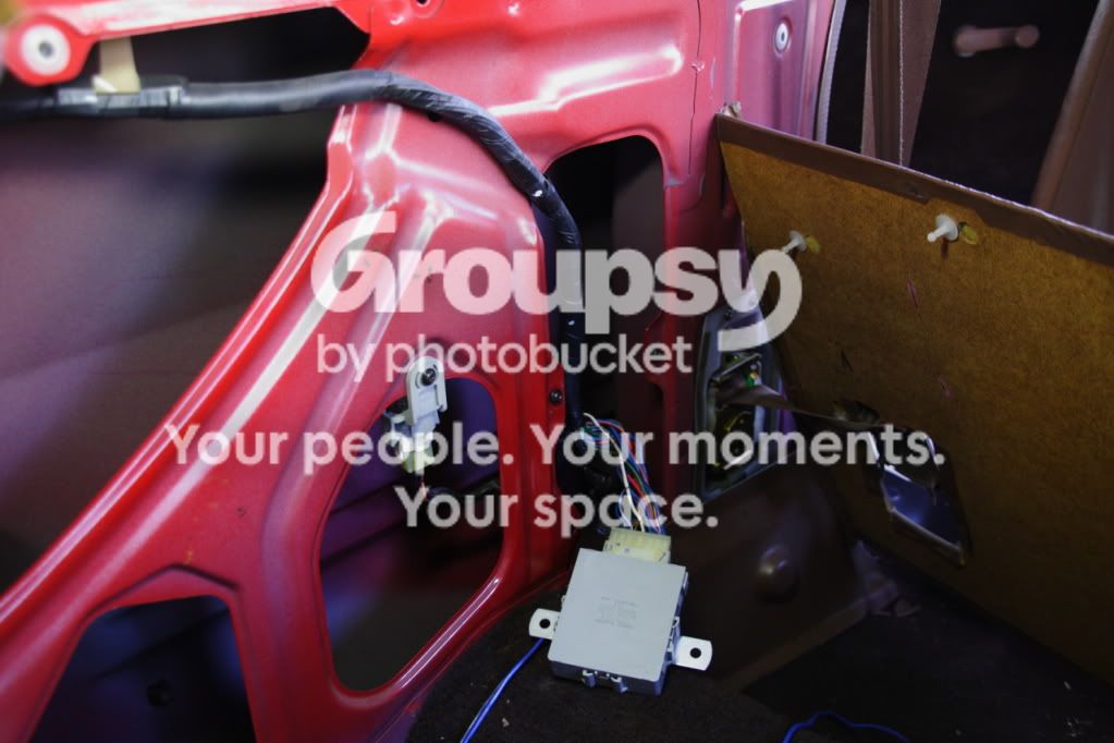

Rear Window & Wiper - Troubleshooting
Rear window can be operated by tailgate key switch even with ignition on.
It can only be operated by console switches when Ig switch is on.
IIRC, rear wiper can also only run if ignition switch is on..
Power from ignition switch passes through the yellow circuit breaker attached to fuse/relay block in right side kick panel, and goes to pin 6 of rear window/wiper control relay.
If you have first-gen MoreFunner with the following symptoms at the same time:
1) Rear wiper does not work,AND
2) Rear window does not work from console switches, BUT
3) Rear window works with tailgate key switch...
Most likely cause would be bad or tripped rear window relay circuit breaker. It's the yellow part on the fuse/relay block behind the driver side kick panel.
To verify, take voltage readings at:
1) Pin 6 of rear window control relay, and
2) Pin 4 (white wire) of circuit breaker.
(schematic below)...
Both points should have 12Volts.
Rear_Window_A_zpsc34fb7a8.jpg~original
Rear Window Control Relay is behind panel behind the driver's seat, near the seat belt retractor machanism...
