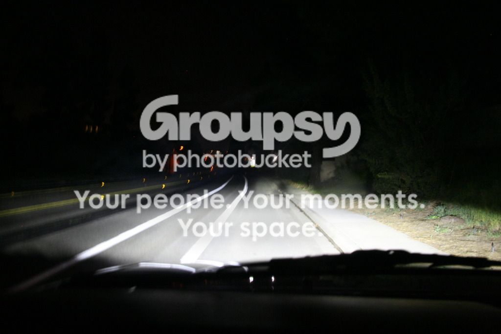

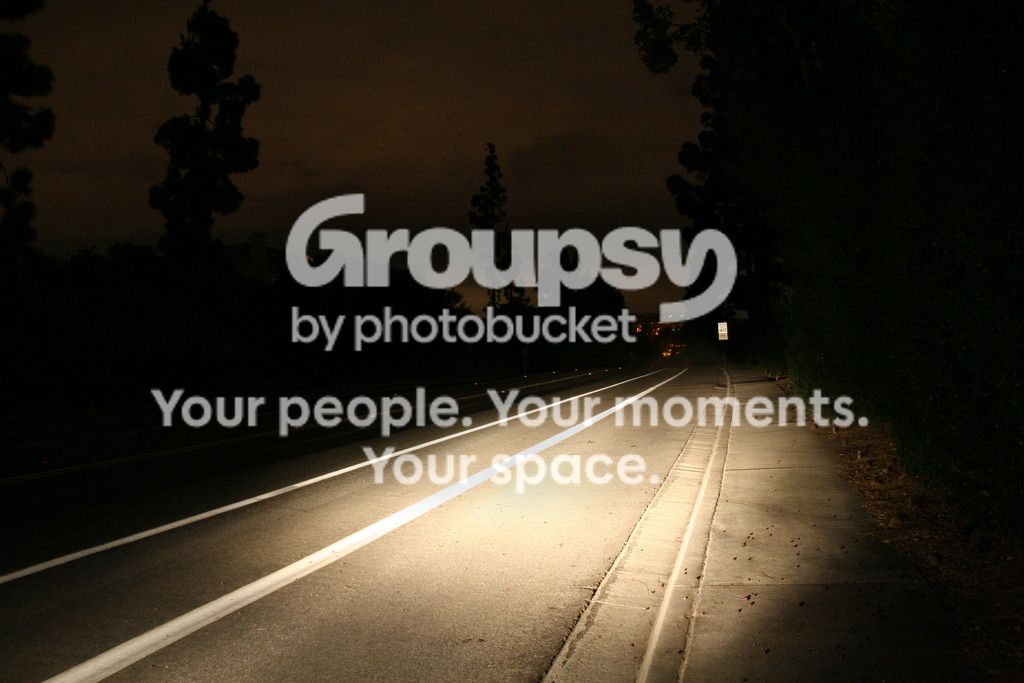

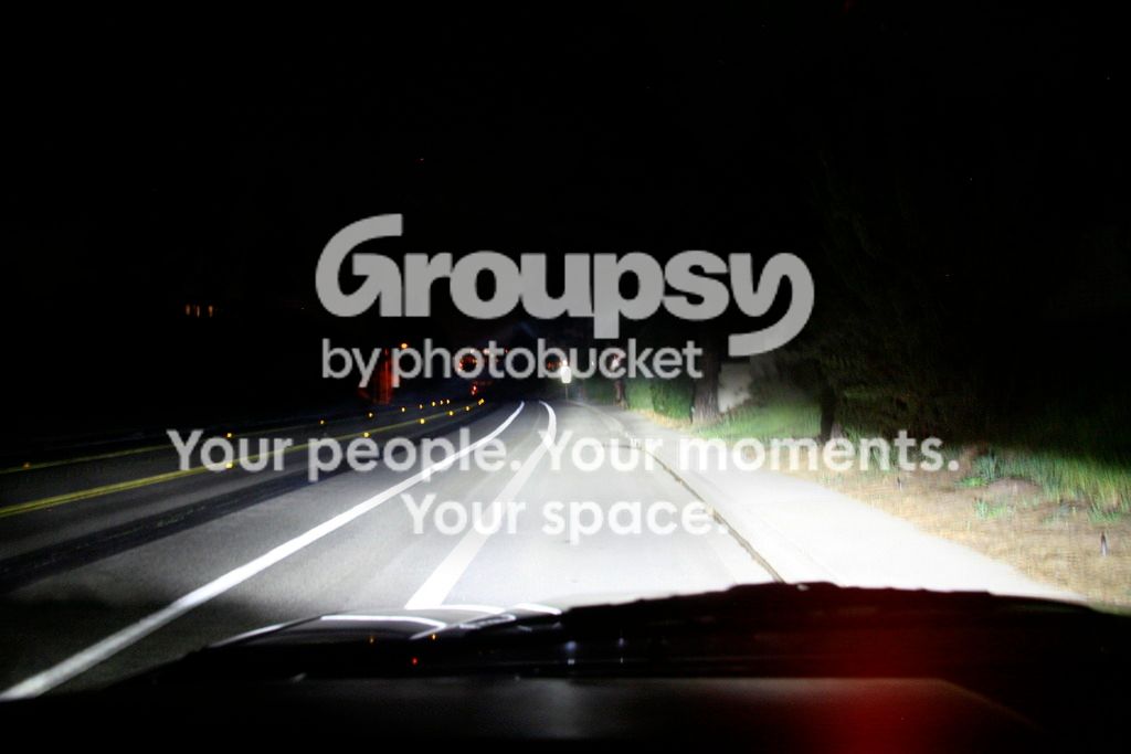

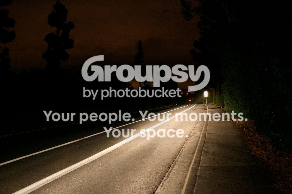

Removed Autopal and installed Truck-lite (trucklite) Model 27450C
DONE!
Removed Autopal housings and installed Truck-lite Model 27450C
plug-and-play. Very happy with it.
Comparison with Halogens in Autopal housings.
Low:
Trucklites_Low_zps8dmrwxmd.jpg~original
High:
Trucklites_High_zpsent59dax.jpg~original
TRUCK-LITES 27450C, LOW-BEAM IN OCOTILLO, CA
https://youtu.be/m3t3sbnssIw
AUTO-PAL H4 CONVERSION HOUSING WITH SYLVANIA STANDARD SILVERSTARS:
https://youtu.be/WFxce_7jX7w
TRUCK-LITES 27450C, LOW-BEAM, LEAVING SPLIT MOUNTAIN, ANZA-BORREGO
https://youtu.be/bVVzPnTts_4
CONCLUSION:
Well worth it. Advantages of Trucklites:
(1) Better spread/coverage
(2) Sharp cut-off
(3) Brighter, of course
(4) Less load on alternator, hence less load on engine
(5) Should last longer than halogens, so economy in the long run
