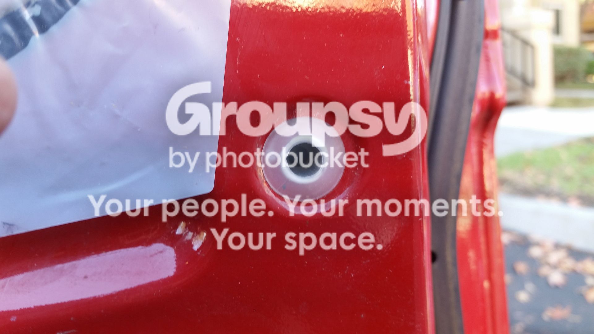

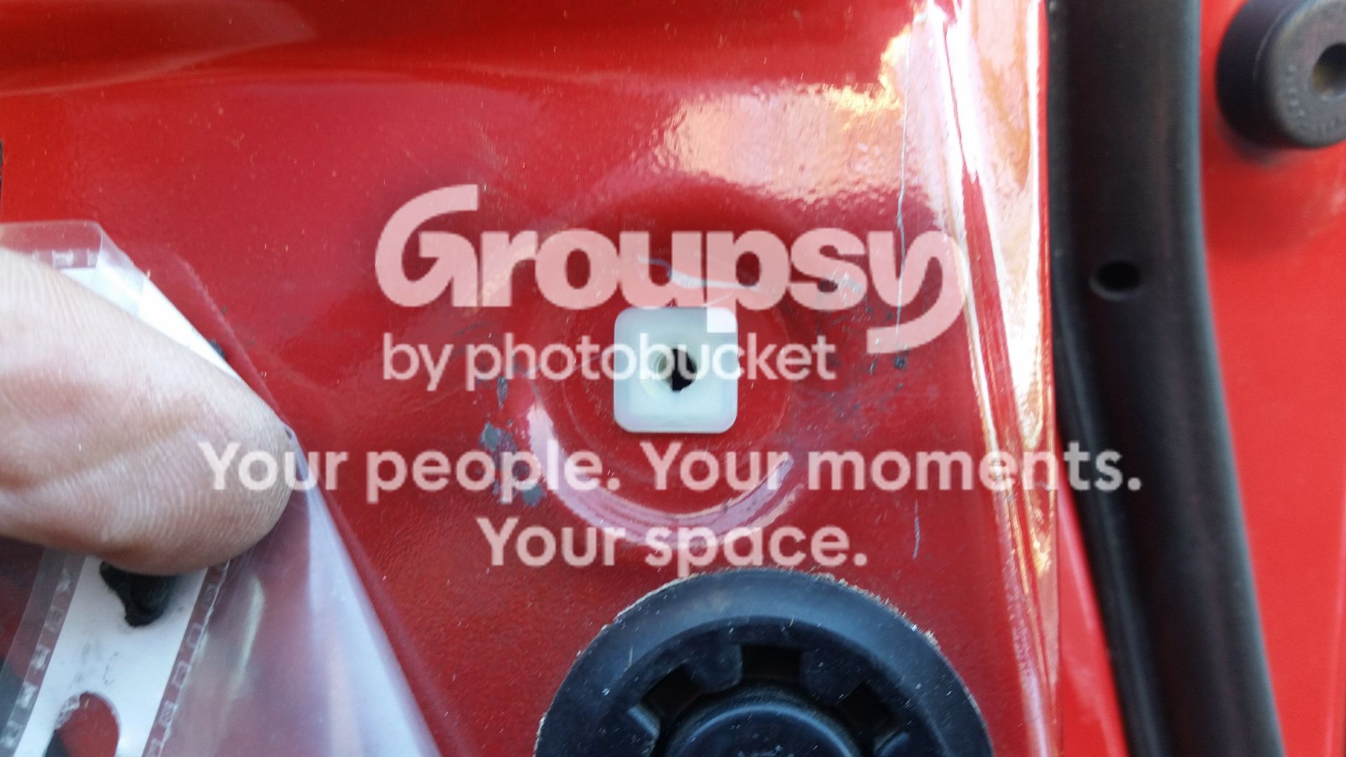

Replacing stock hidden fasteners:
20151201_144157_zpsbzmksr08.jpg~original

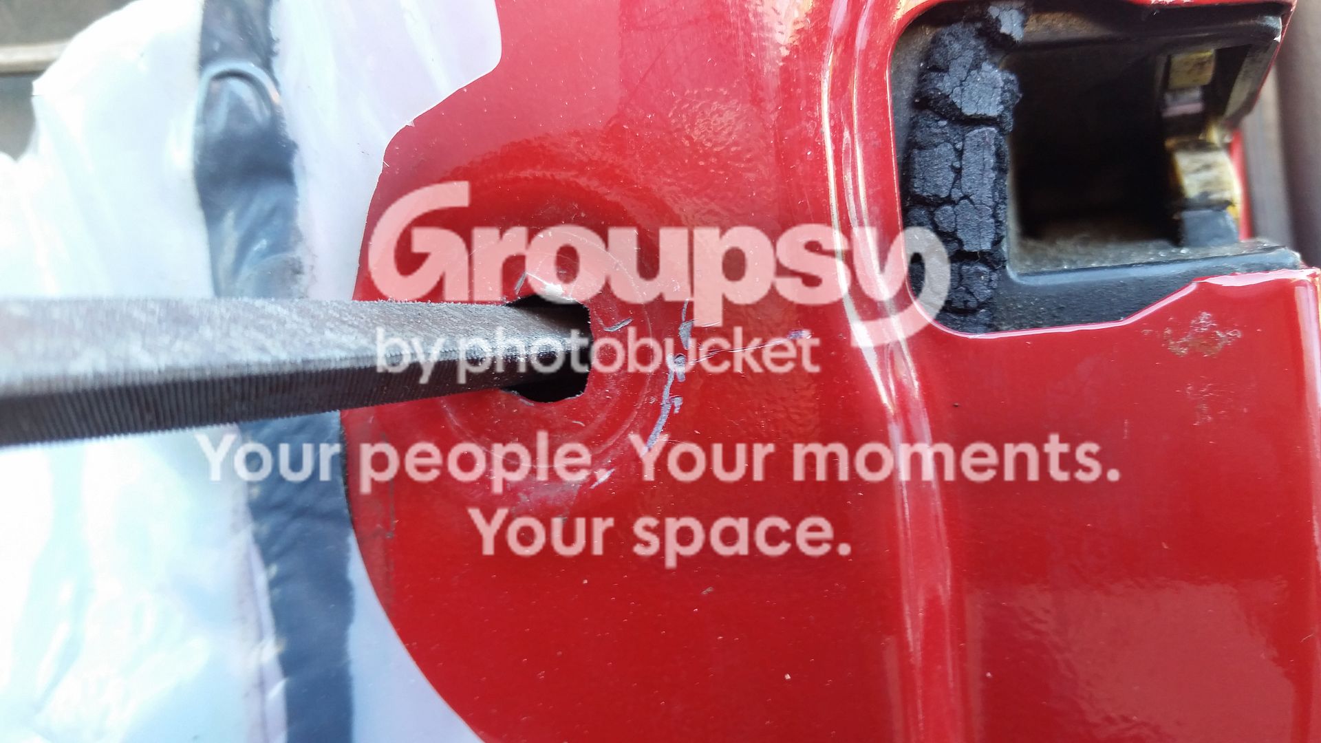

Filed corners into hole to fit the expansion/nylon nut, and keep it from rotating
20151201_144213_zps0ou3z8ce.jpg~original
Nylon nut attached:
20151201_144219_zpsjyxgpv2p.jpg~original
I purchased nylon nuts for 7mmx7mm hole and #8 finishing screws from www.clipsandfasteners.com.

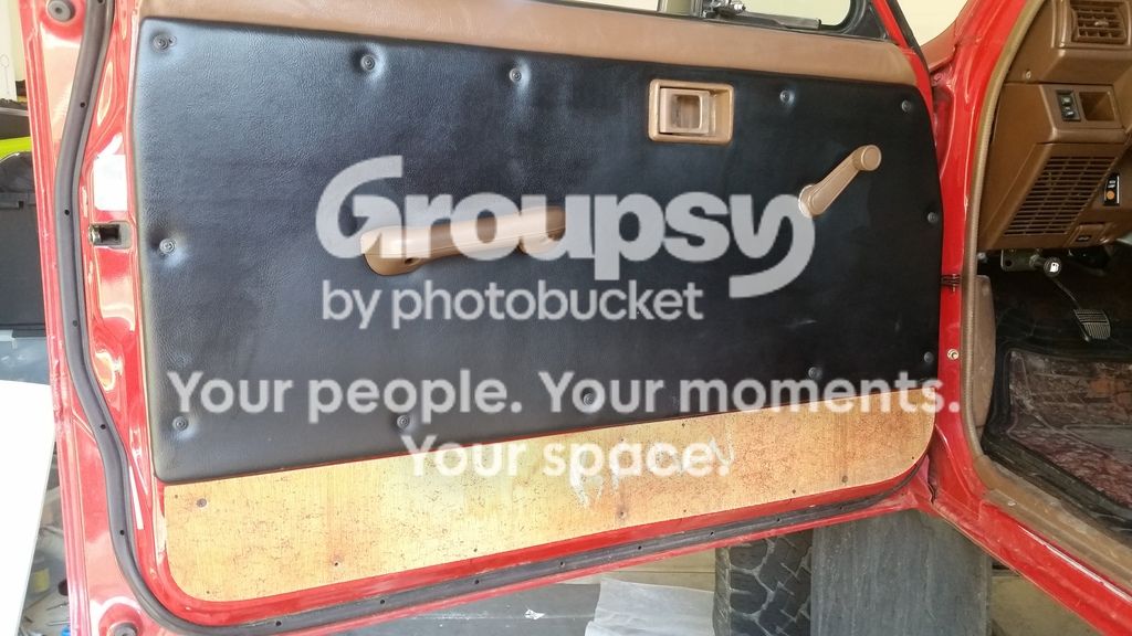

Driver's side panel was replaced with foam-core poster board just because I had some lying around.

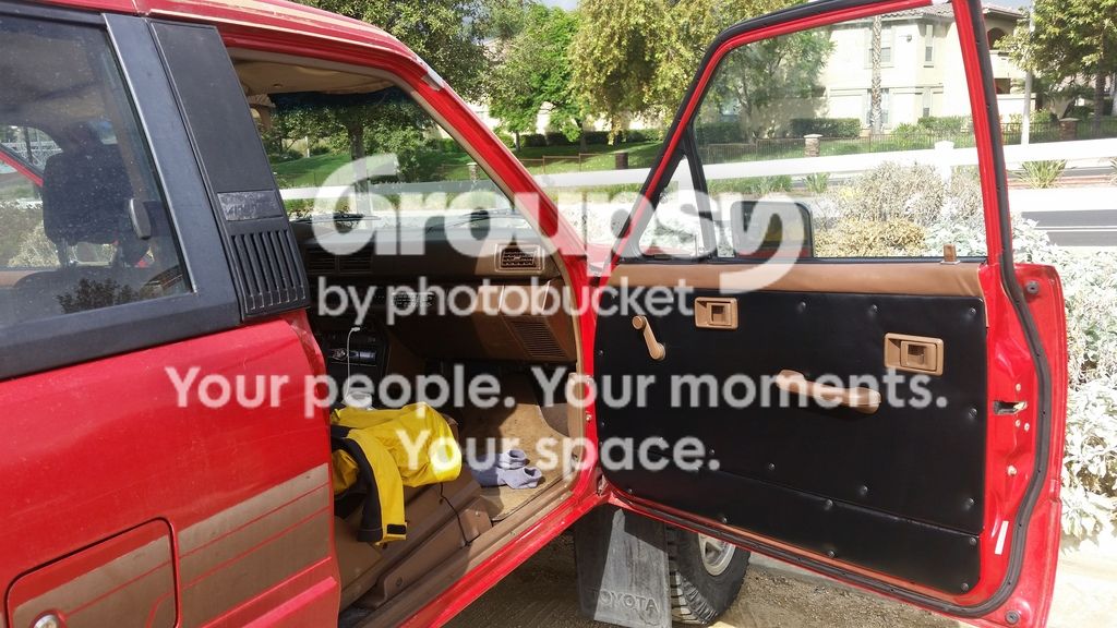

Top door panel and integrated window sill cover looked factory, but notice "Brown" noted under the carpet wrap of the bottom panel. Could it be possible that these things were customized here in the US, or they used English markings in Japan factory?

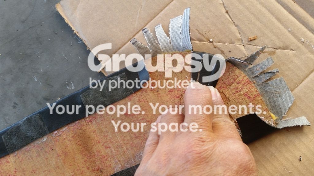

Biggest challenge I think is getting a clean wrap around sharp corners.

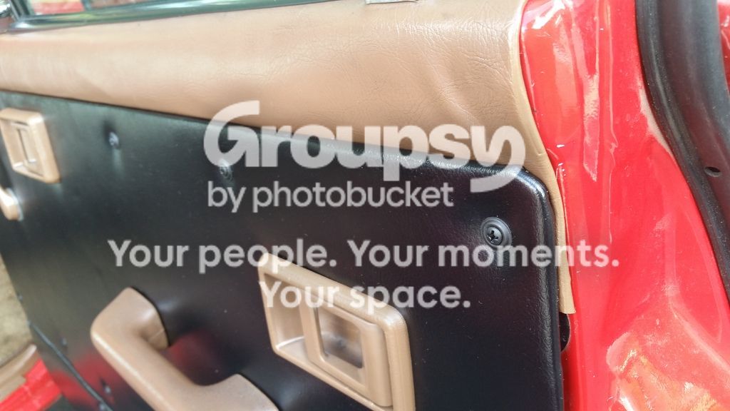

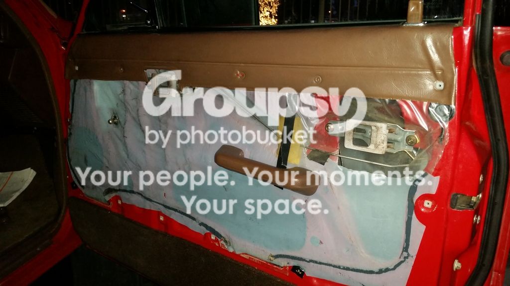

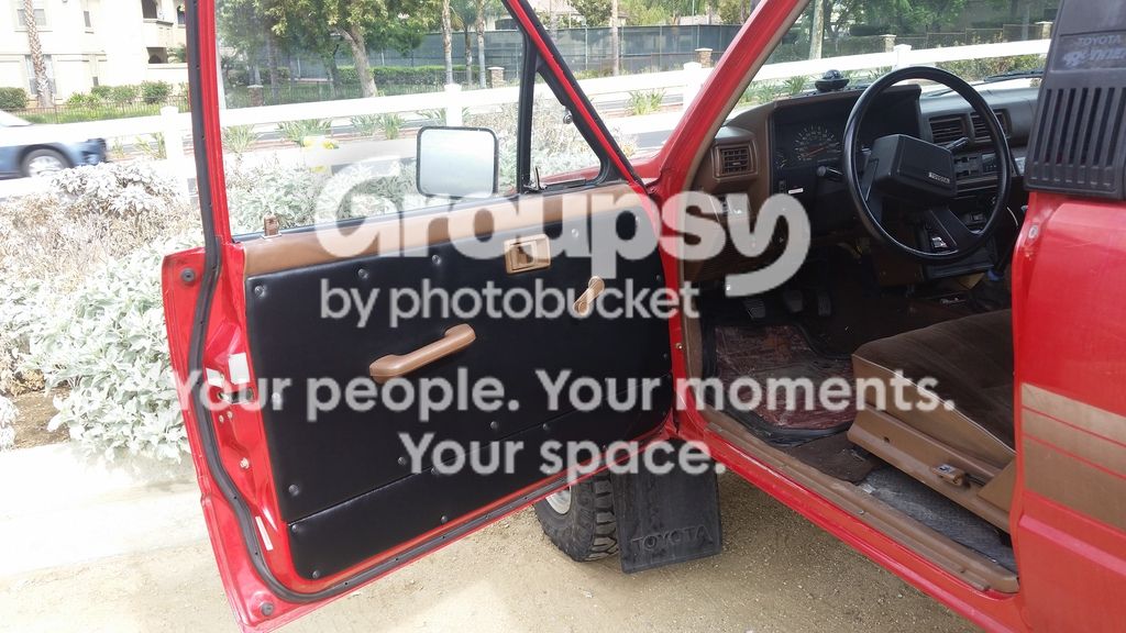

BEFORE: Dated, dust-collecting velour/carpet material on door panel and door panel attached to window sill cover, making it a PITA to work on.
2015-12-16%2016.46.25_zpsgoc8hwiv.jpg~original

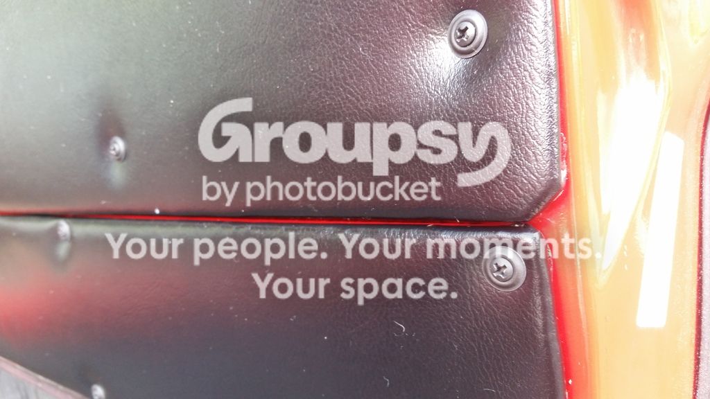

AFTER: Utilitarian black vinyl-clad door panel with simple screw fasteners. Now allows spray and wipe maintenance. Door panel and window sill cover independent of each other:
20161012_183733_zpsug78mac6.jpg~original
20161017_113133_zps1jpam4el.jpg~original
20161017_113152_zpslopiirzz.jpg~original
Now, because of easy access/removal/install, I can easily add my mesh pockets in the future.

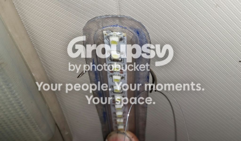

Even an LED dome light bulb replacement is anemic and I happen to have an extra LED array so:

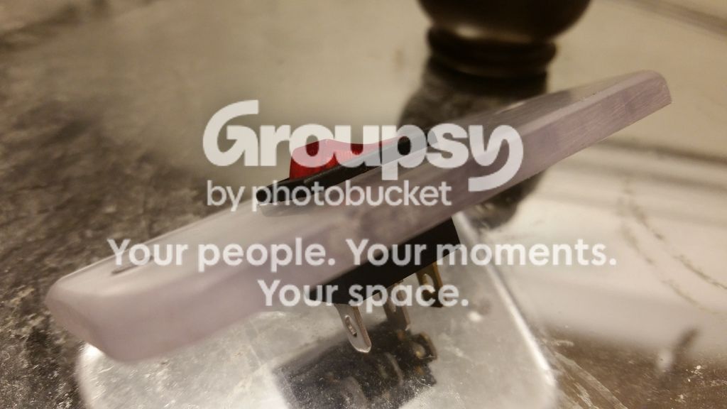

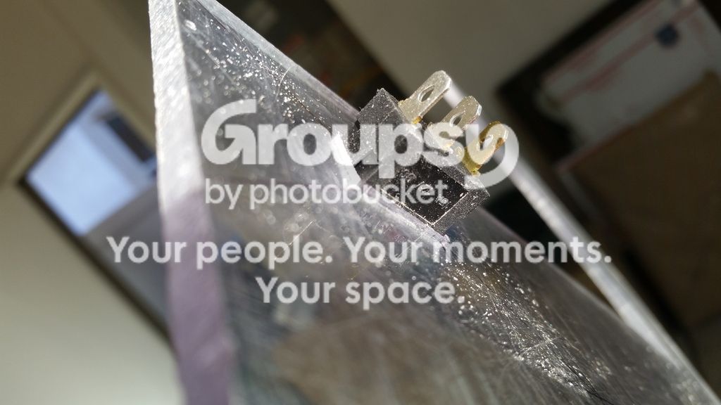

Made switch plate out of polycarbonate...
Made opening on right for the switch plate (on left is location of stock dome light):

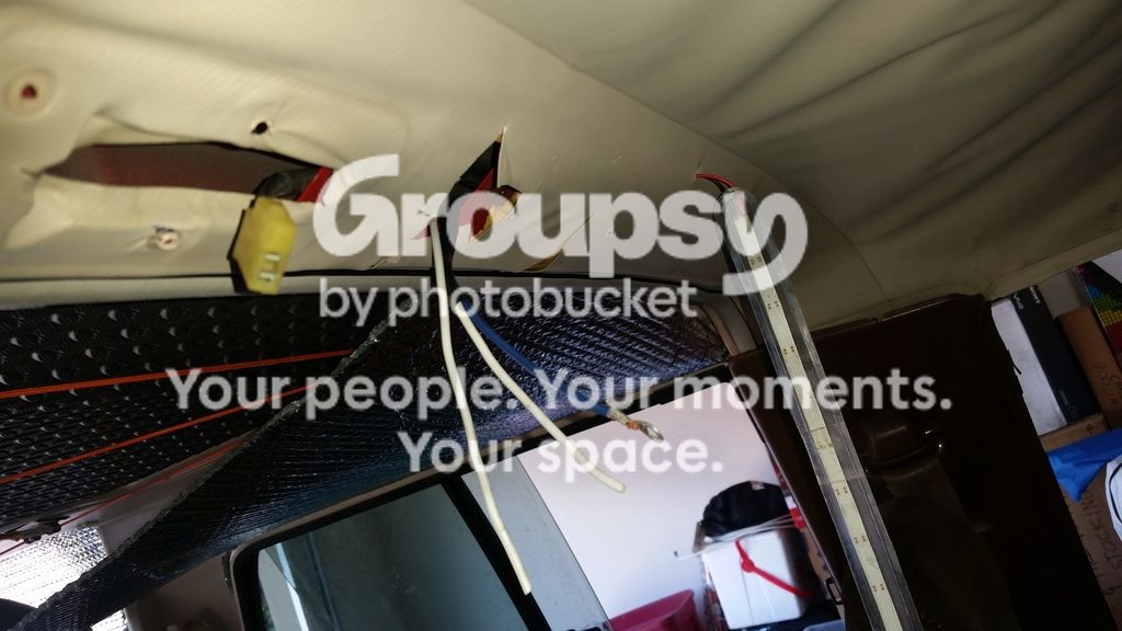

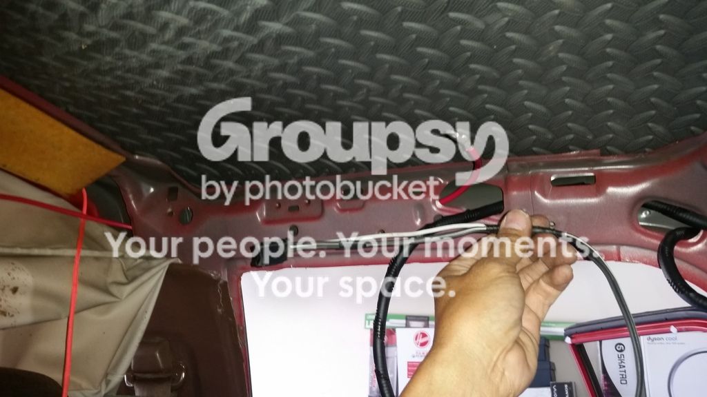

Tapped off the constant 12V line of the stock dome light wiring (black with white stripe):
I had to pull stock wiring out of its run to facilitate splicing/soldering. (Ignore the red wire. I just used it as fish-tape.)
Ran wires back. Blue wire would be screwed into body ground and connected to negative side of LED array.
Switch plate installed. One white wire is tapped off from constant 12V. The other goes to positive side of LED array.
Stock dome light was reconnected and re-installed.

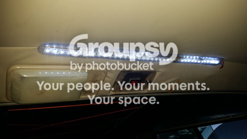

"Sewed" on the LED array with curved needle and fine nylon fishing line:
Yeah, some bad LED's on the array, and not very bright. What do you expect... I bought it here - LOL!
Anyway, I wired it so I can quickly replace it with a brighter array/bulb when I find one.

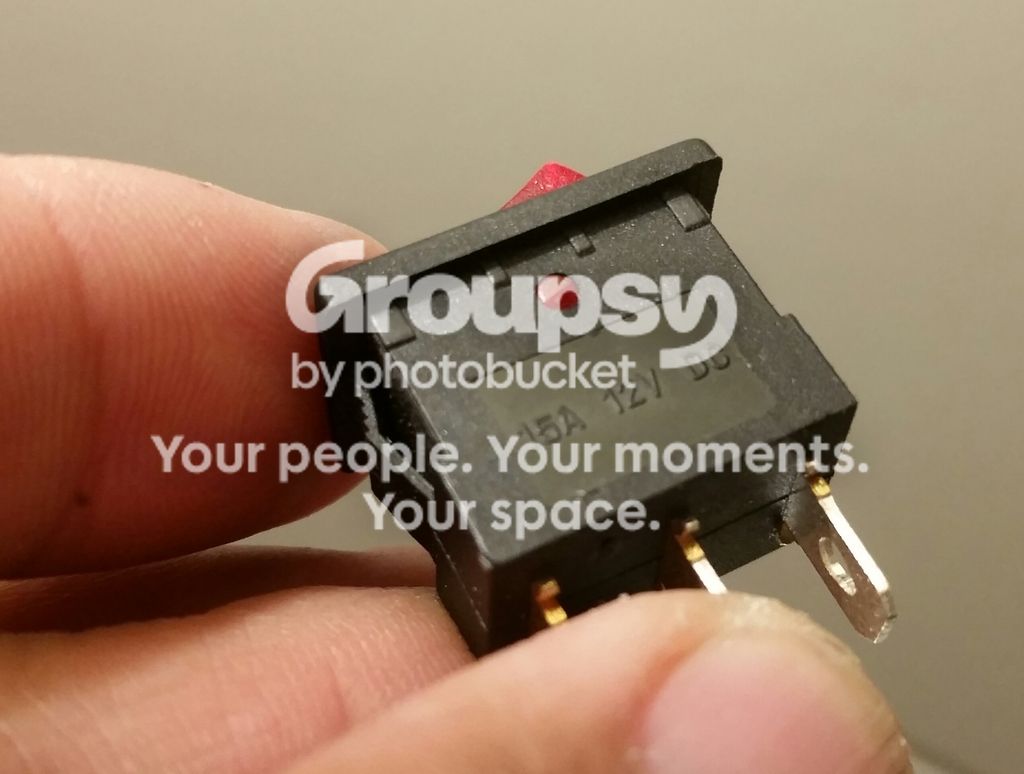

This is simply an on-off affair because I could not readily find a ON-Center OFF- ON rocker switch.
When I get the brighter bulb/array, stock dome light will be replaced with red LED for subtle lighting that will help preserve night vision.

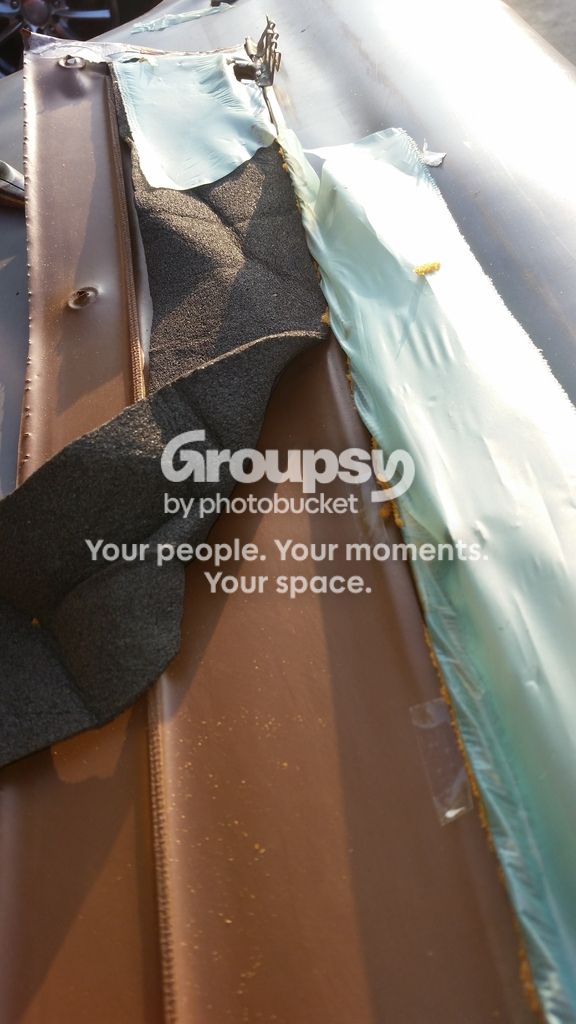

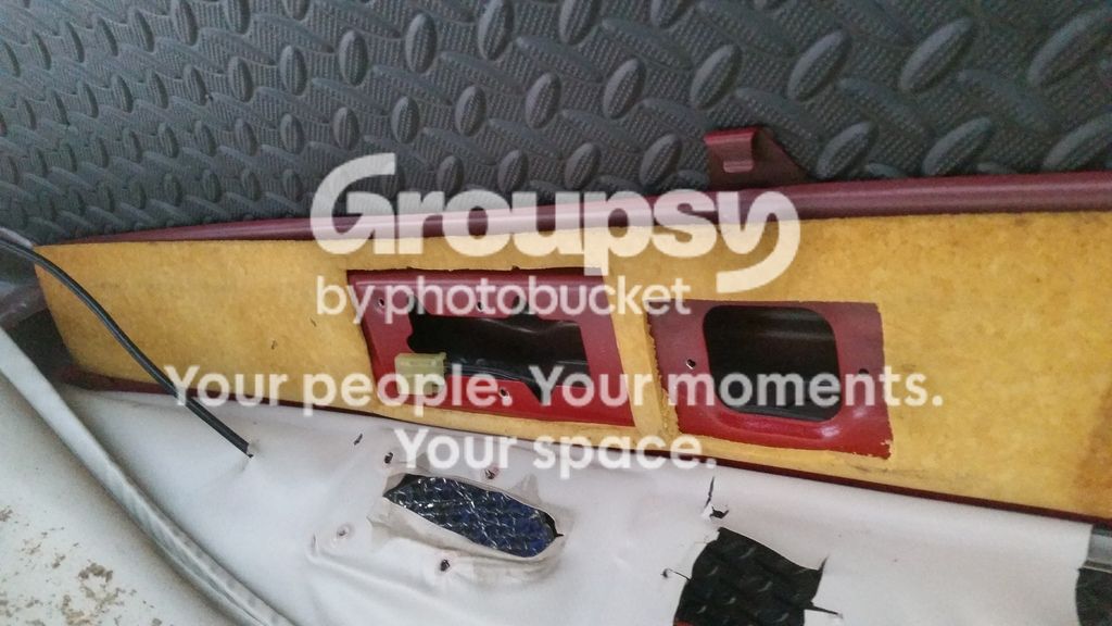

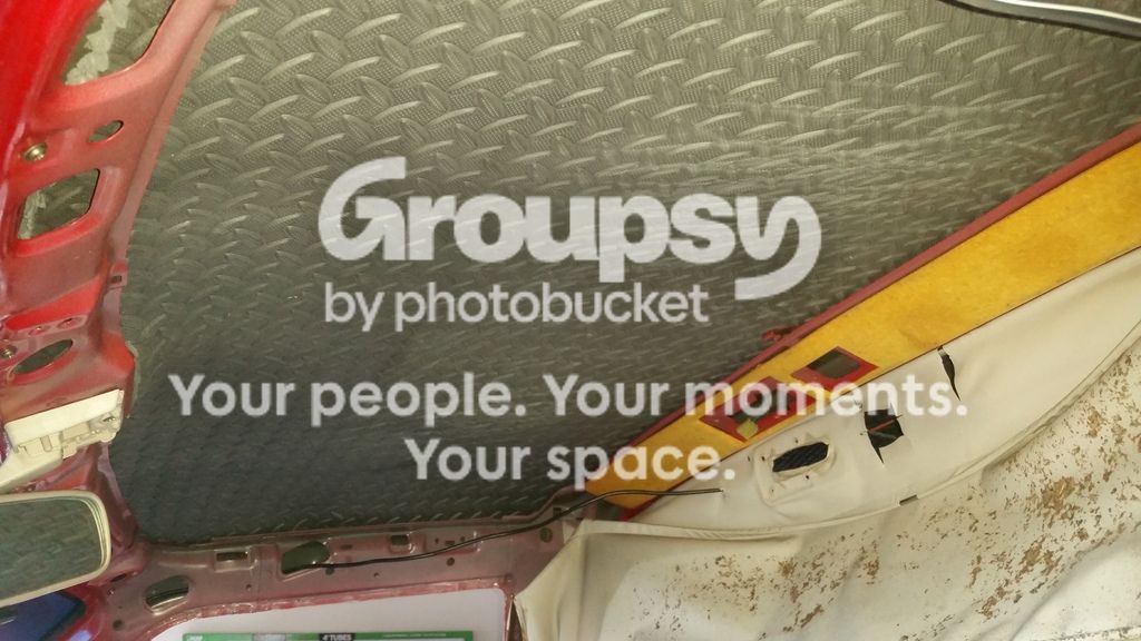

No, you are not tripping; I really replaced the crumbling, dusty, messy headliner insulation with "Best Step" diamond-plate pattern anti-fatigue mat like I did with headliner on my cap.
When I get the time, I'll stick vibration dampener on roof, too.
