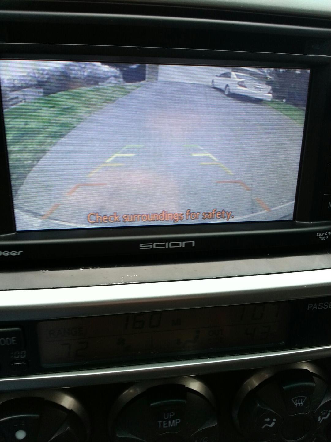

I puchased this camera:
Toyota Display Audio/Entune Backup Camera Kit - Camry, Corolla, Prius, | Backup Camera System Truck Backup Cameras LCD Mirror LCD Monitor Gentex
It has grids but they can be turned off by connecting two little green wires together on the camera harness. The image can also be flipped 180 degrees meaning you can mount the camera two ways. I mounted mine in the factory location for the 4runners.

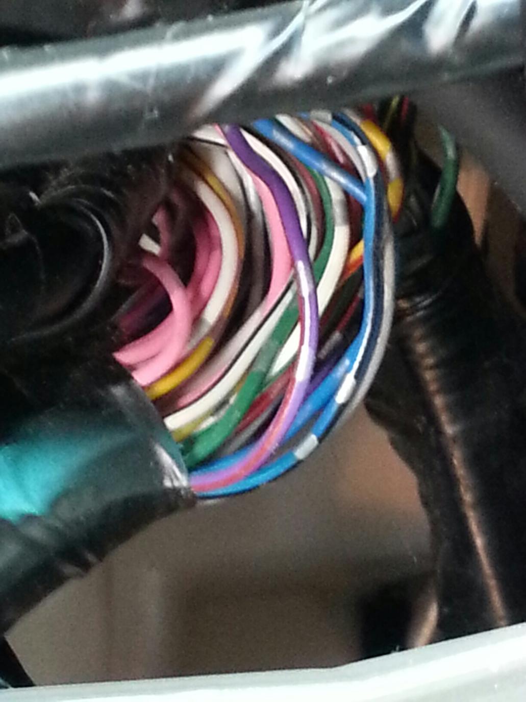

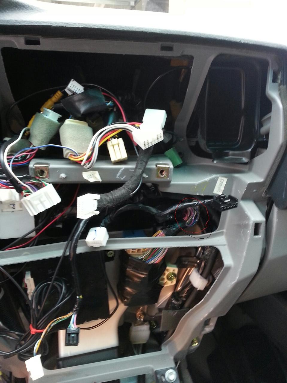

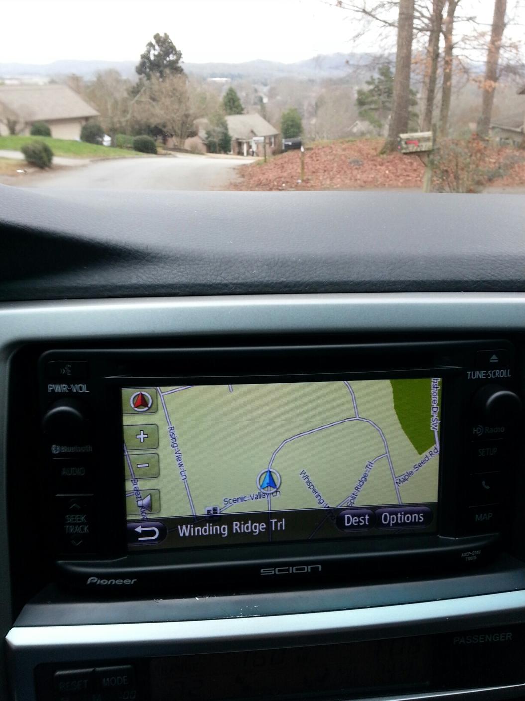

Ngonerogwu,
This fixed my flaky NAV accuracy. I think you joined the forum just in time to help me. Thank you very much!!! I did have some difficulty finding that purple wire to tap, so I am including a pic for others in case they need this too.
Only thing left is the USB, I think I will order another cable, its either that or the headunit itself, I have tried everything else including plugging in a thumb drive, but it still doesn't see anything.
Thanks again!!
Rick
