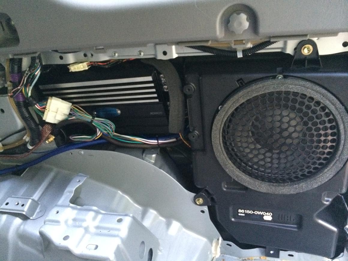

[MENTION=50507]CookieRoe[/MENTION] the rewiring went well. I ended up going with arc audio xdi 805 five channel amp. It is small enough to fit where the JBL amp is located with some modification to the plastic housing that the JBL amp and sub are mounted to. As of now, I am still using the stock speakers and to me they sound great. Much better than they did when using the JBL amp. I decided to eliminate the center speaker in the dash as well as the 2 rear pillar speakers in the cargo area. I wasn't exactly sure how to wire them up (what channel to use, whether to wire them in series or parallel) but am happy with how the system sounds without them. I did end up using the 2013 FRS touchscreen since it had RCA outs.

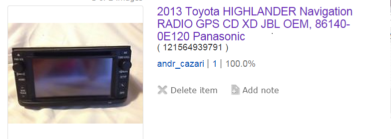

2013 Toyota HIGHLANDER Navigation RADIO GPS CD XD JBL OEM, 86140-0E120 Panasonic

killing me smalls...its even in the title of the auction!!
but do note, it does NOT come with the navigation part nor the gps listed in the title for the $695, or $500 he countered to me. and he actually wants $800 total for what the title actually lists! i told him he should change his deceitful title, but looks like he could care less.
