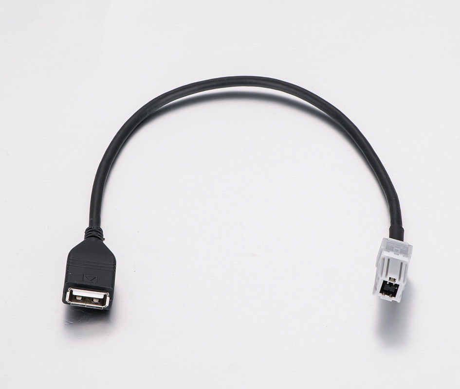

So after receiving some of the cables in the mail, I've had a chance to look at the USB cable. I know that Buckles said that the USB cable needs to be "modified" to plug something into it.
Looking on Ebay, I found this cable;
Obviously needs no modification, and is only a fraction of the $65.00(!!!) Scion cable, at $14.00~.
If this works, I'll return the Scion cable to Amazon, and post the details on the new cable.
