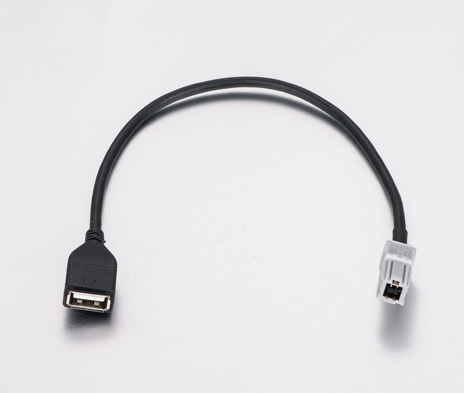

Looking on Ebay, I found this cable;
Obviously needs no modification, and is only a fraction of the $65.00(!!!) Scion cable, at $14.00~.
If this works, I'll return the Scion cable to Amazon, and post the details on the new cable.

Well, the USB cable came, and I installed it after work.
The ebay cable works. Search Ebay for "Axxess OEM USB Retention Adapter" and you will see a couple cables come up, the one we want is obvious by looking at the plug. There is a longer plug here, if the url breaks, search for "toyota aux usb cable"
Am I pleased with it? Not really. Plugging into the USB does not show album art like I thought it would. The connection is good, it works, but meh. For a radio made for model year 2014, I would expect better features than the Alpine IVAW505 I had in my tC back in 2009!
But it does charge my phone! So there's that.
So, if you want USB, this cable will save you over $50.00. The only thing is that it's a short cable. I had a USB extension cable lying around at work that I used to extend it to the console storage compartment.

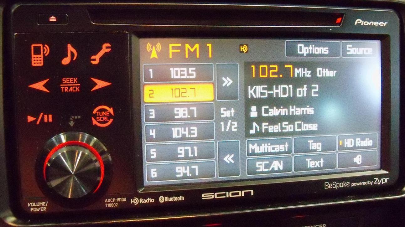

2013 FRS Bespoke radio but I assume it should be the same for the 2014. I am planning on upgrading to the 2014 version soon so I will post an update once installed. I have not gotten artwork to display for CDs, or streaming via bluetooth.
Also, I been having issues with the USB function using my iPhone 5s (lightning connector). Every time I plug my phone in it cycles between charging and not charging. I have tried multiple phones so I know it is not something wrong with my phone. I have always tested the voltage at the lightning connector and its outputting ~5v which is what the iPhone requires. No issues when using iPhone 4 or iPod touch with 30pin connector. I am not sure why. Havent been able to figure it out. :noidea: . Sorry for the rant
Can you post a photo of your radio, [MENTION=100938]acronin2[/MENTION]
Try a different lightning cable?
I have tried multiple cables and phones. I am stumped. I wonder if it'll work when I update to the 2014. Here is a pic of the head unit I have.

Ohh, ok, I've seen that one, but I have the newer one.
When I plugged in my iPhone 5S for the first time, and selected "iPod" on the head unit, it said it couldn't find any compatible iPod music, and advised me to add some and try again.
My phone is full of music, all or most from the iTunes Store, so it's "real iPod" music. For that reason, I've just continued to use Bluetooth for music, although I'm digging the quality of the HD Radio on the terrestrial stations, too!
I dunno about that unit and the lightning, but I can tell you that is not happening with my model.
