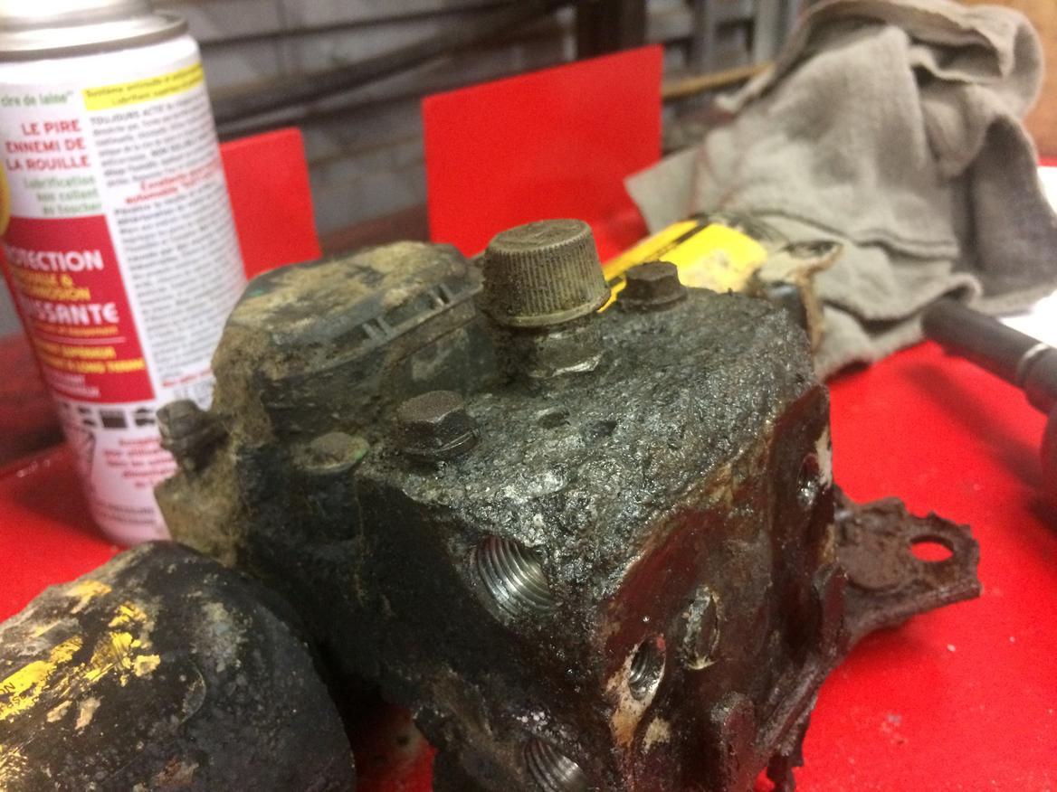

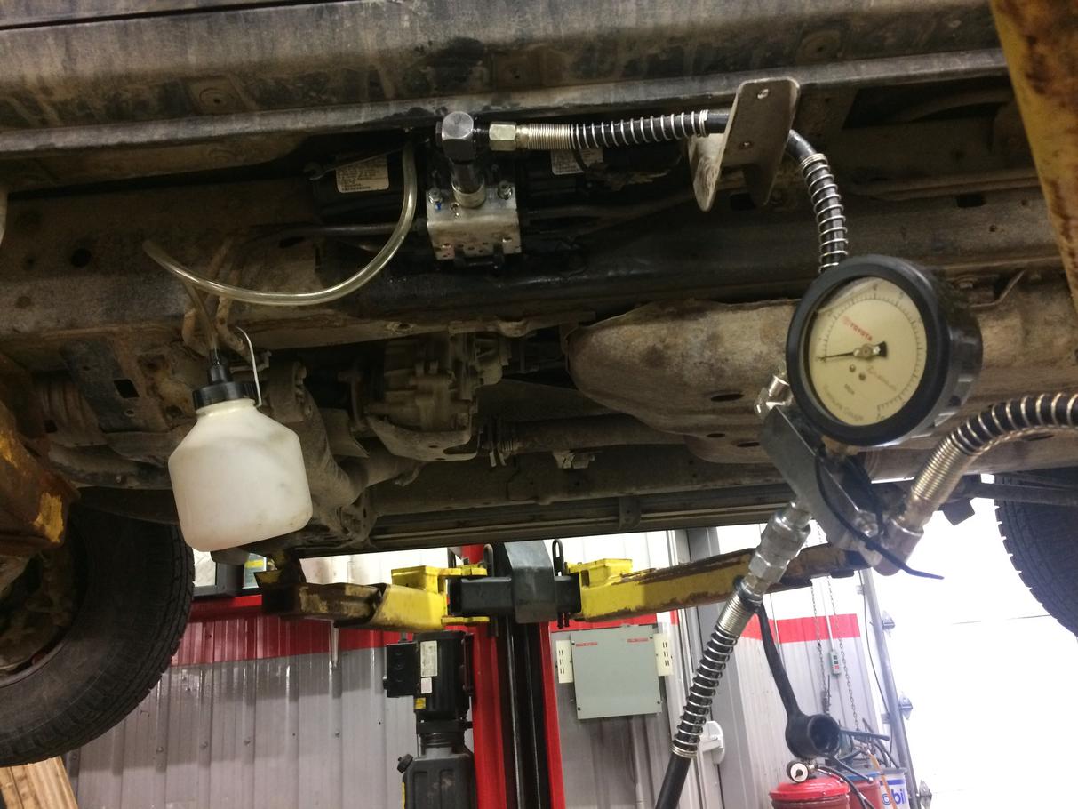

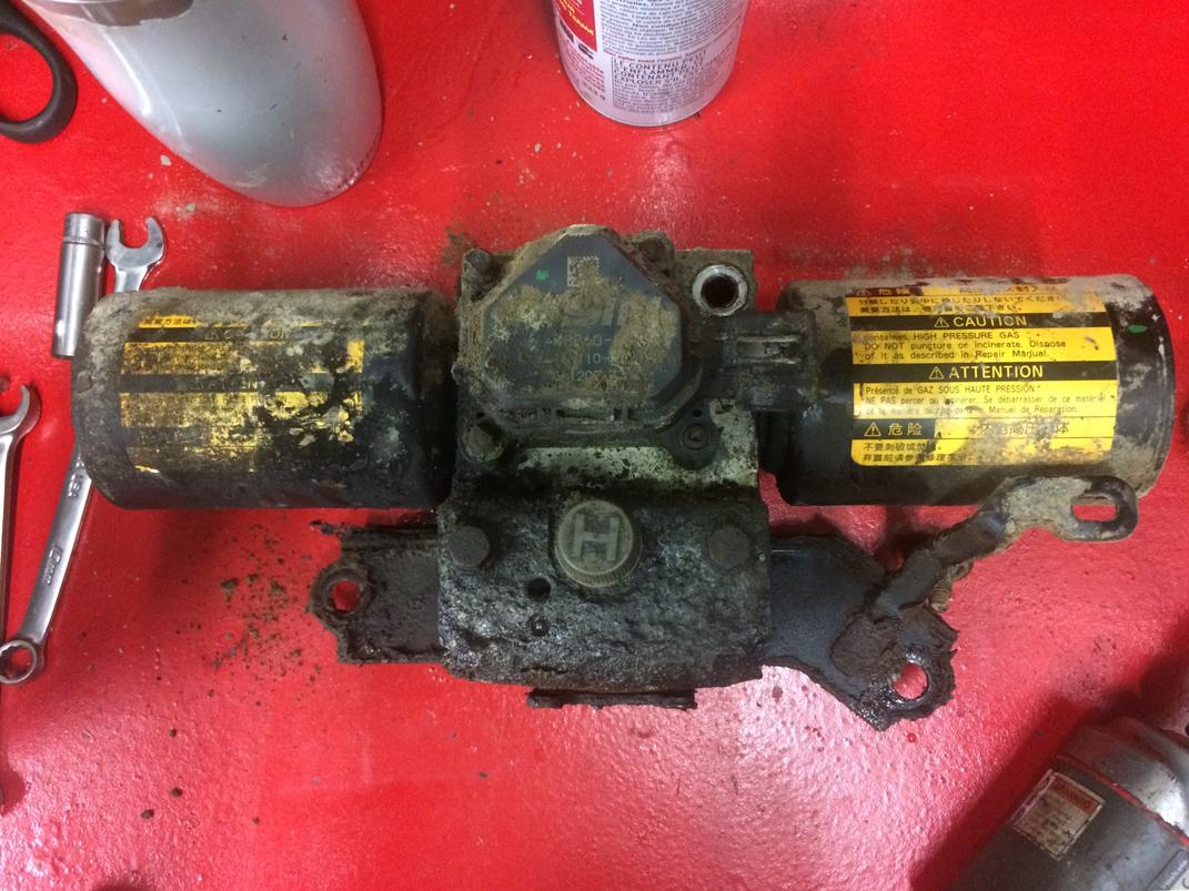

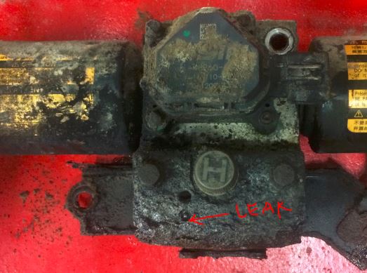

Bought a 2010 TE in Jan 2011 with 10k km from a dealer. Within 1st year had a KDSS light come on. After many hours of troubleshooting (I think it was a faulty connector), dealer ended up putting in a new pump under warranty. A few weeks ago (at 150k km) KDSS light comes on again. This time I witnessed the troubleshooting (what happens when u know ur gonna pay !). Tech removed the skid plate and I couldn't believe how much wet mud (with road salt of course being here in Canada) was packed in there. Turns out the aluminium manifold had a leak. No wonder when you see the condition of the manifold. Leak was coming from the pre-made hole (smallest and lowest of the manifold). As you can see from the pics the manifold was very corroded. Estimate for the repair was well over 2k but I challenged the 250$ for the fee for the SST to pressurize/bleed the system coming from Toyota Canada (told them it was not my problem they don't have the tool). They accepted to remove the 250$ fee so It ended costing 2.1k including taxes (1h of diagnostics, 2.5h work, pump , oil). CONCLUSION/ADVICE: remove that skid plate once a year and clean remove the junk. Make sure to protect the electrical connector with grease to keep the rust out as well

I'm pretty meticulous with cleaning the underside of my vehicle between trips, and I'm always amazed how much junk I have to clean off that assembly every time I've removed that plate. I did it twice last year, and it was full of mud both times.
Thanks for posting the pics. It's a good reminder
OMG yes.

That amount of corrosion is crazy. I wonder how much we (in the dry, warm southern states) need to worry about this kind of thing? Is salt and snow a major factor in that corrosion? I also wonder if a KDSS cover like the one RSG have introduced would help at all?
I just took my kdss manifold skid plate down last weekend and did my annual spring cleaning. It was full of dirt and junk like it always is, but it cleaned up perfectly and looks brand new. I also took the opportunity to coat the wires that go to the connector in dielectric grease.
I've had my 4runner since 2015, in a very corrosive environment. I drop that OEM KDSS skid plate twice a year on average-- more if I've been in to a lot of mud, and it's always LOADED with crap. But it sprays out easily with a hose. I hit the fittings with a small brush and it always looks new when I'm done.
I'm not sure what would be involved to make it corrode like that,
but I can say that it's VERY easy to drop that little skid; (2) 10mm bolts and it's off.
clean it often, and take good care of that electrical connection on the aft side.
