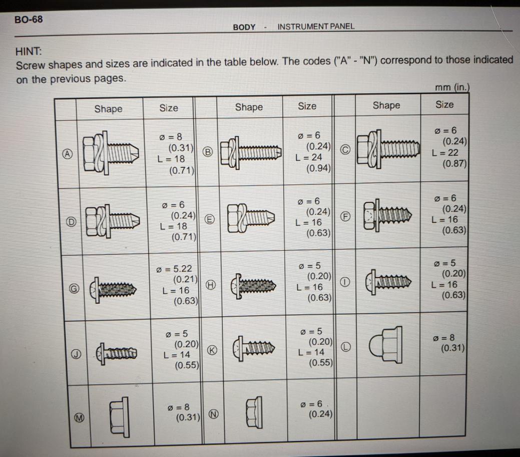

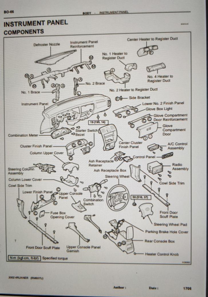

Couple things: this is one of the most useful images in the FSM, and it only applies to the dash/instrument panel. Does anyone know of a similar resource for the rest of the vehicle? It would be so very handy.
Second, is there an error on this page, where it shows screws (H) and (I) having the same specs, yet clearly they are different? Or, is it just that the thread info is not included (which would seem like useful data when trying to replace missing fasteners). I'm guessing that the "naught" symbol is for width, then?
Wouldn't it be nice to know the specs for all the fasteners?

While those 2 screws seem the same spec-wise, if you look at the drawings you'll see they are slightly different, so would have slightly different applications. The threads are different, one has what appears more aggressive and different thread pitch, and also has what looks like little "bumps" under the head which might act as a built-in lockwasher.
