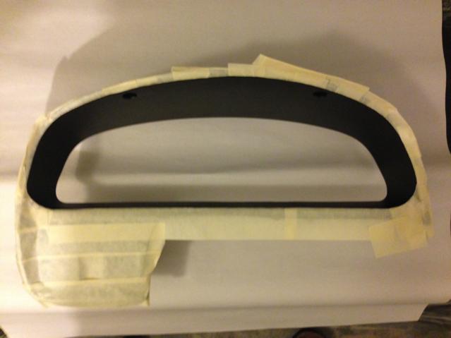

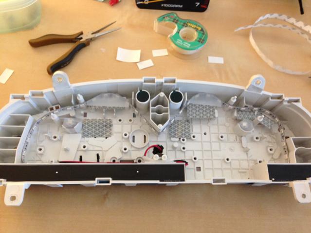

I had previously done an LED swap to change everything to red, but I wasn't happy with the brightness or evenness of the lighting. So I decided to do a second round, using an LED light strip instead:
LED Light Strips - LED Tape Light with 18 SMDs/ft.
This ended up being the perfect length to fit the instrument cluster. I adapted the twist-in connector to the light strip and ran it around the perimeter like this:
Initially, it was much too bright around the center of the cluster. I ended up masking (literally using masking tape) some of the lights near the center to even the lighting out, and trimming some of the gauge backing to let light through to the temp and fuel gauges. This took three or four installation-test-alteration cycles, but ended up being worthwhile.
I also left in the old red LEDs behind the two gauges, but removed most of the light guard around them so they could more evenly illuminate the speedo and tach. Ultimately, it all ended up working rather well.

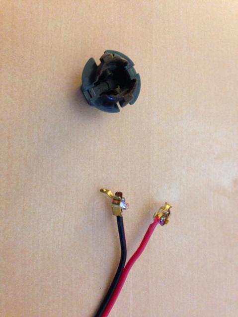

For the various indicator lights, I tried switching over to using white LEDs (these), but I ran into two problems: first, there was some kind of voltage bleed going on that made some of them appear dimly lit at all times, and second, the ~6k color caused some to show up as yellow or pink. I switched most back to the normal bulbs, but kept them in the turn indicators (where they work brilliantly.)
The lighting ended up working out so well that I was getting more glare than I liked. So I hit the interior with an ultra-matte black paint:
This reduced it a bit. Not as much as I'd like, but oh well. I do a lot of night driving during winter trips, so reducing eye strain is a big thing for me. Hence the red instruments and attention to glare.

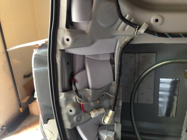

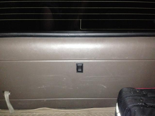

I wanted the ability to open the rear window while camping without using the ignition, so I installed a rear window switch. These two threads cover the subject. Basically, you tap into the connections for the rear lock drum, and you have a switch that works when the ignition is off. The wires you're looking for are white-black (ground), green-red and green-yellow (up and down, can't remember which but it's easy to sort out when you wire up your switch.)
I picked up one of these to use as a disconnectable wiring harness for the new switch. I don't think it's necessary since the switch connection uses .25" quick connects, but I like my wiring to be separable if possible.
This was the switch I used, but any dual throw (DT) momentary switch should do. I also grabbed a switch blank to install it in, which took an irritating amount of time to arrive from overseas, but ended up being study and a snug fit.
The switch is deep and requires a hole be cut to mount it:
I mounted it high so it wouldn't be covered by a sleeping platform. Voila:
If I had it to do again, I'd consider mounting it not on the door, but on the quarterpanel beside the door. More wiring to route that way, but probably a cleaner install.

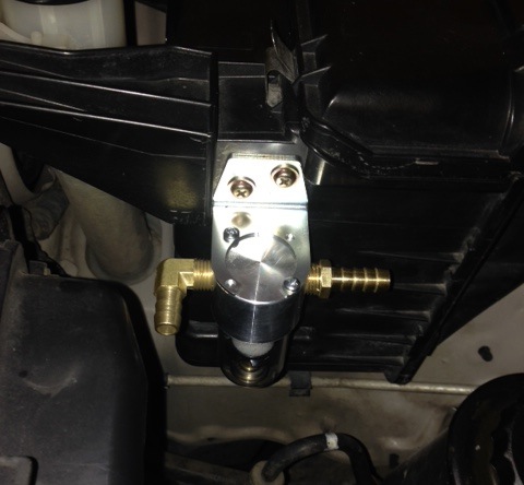

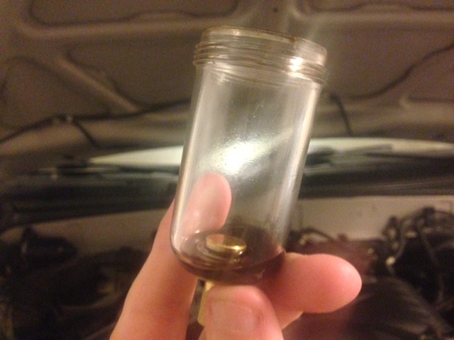

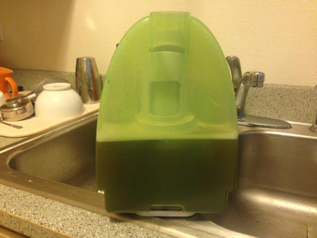

Before putting the SC on, I wanted to try to keep it clean and install a catch can / air-oil separator. So I installed this:
It felt a little small, but a) it actually has a filtering element, b) it has a clear catch cup so visual check is easy and it unscrews to empty, and c) it's US made and appears to be quality. Only surprise was that the mounting screw holes on the top aren't threaded. Don't know why they didn't do that, but it was easy enough to tap them.
It fits neatly on the side of the airbox, where it's easy to check and empty:
After about 400 miles on it, it appears to be doing its job. Oil that didn't end up run back through the TB and SC:

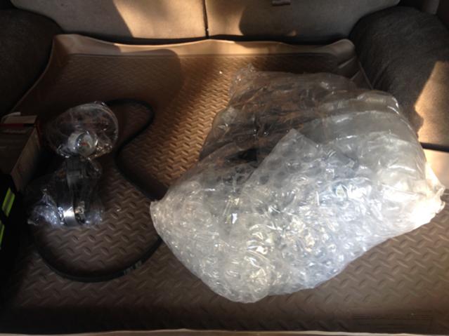

I had been planning to do the SC next spring, but when Toyota announced that they were ending manufacturing of them, I bit the bullet and jumped early.
A local listing popped up on CL. Not the deal of the century price-wise, but they claimed very low mileage and appeared to be a reputable shop. So before long, this bundle of joy arrived:
Some of the mounting hardware was missing, but I managed to source everything online. Notably, the 170mm bolt, which turned up on Amazon like so many other things.

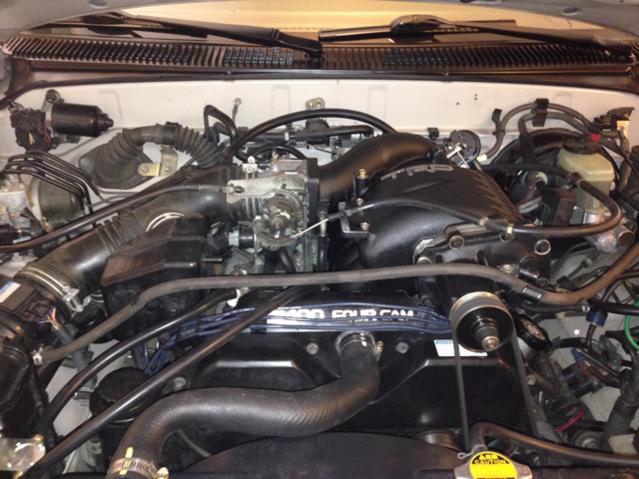

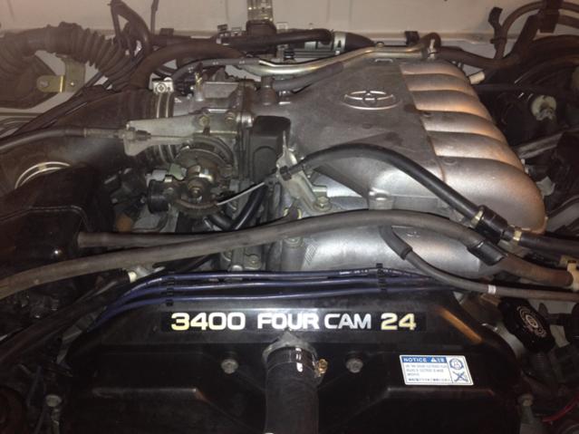

All told, it ended up taking about six hours to go from this:
To this:
The most irritating part was the power steering belt. And the AC belt. And the SC belt too. Basically, to hell with belts. Also, due to Reasons, I had trouble relocating the dipstick. But as it happens, a dremel is the answer to a lot of problems, so now my dipstick looks like this:

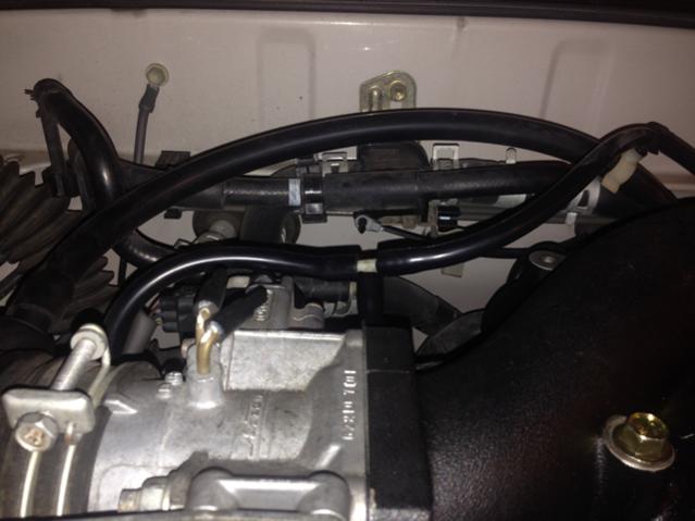

Aside from a tense moment at the start (I forgot to hook up the MAF, so the engine would turn over and promptly die), it turned out just fine. And the compressor whine it makes when you load it is going to badly damage my MPG. I swear it sounds like the DeLorean from Back to the Future. I grin like an idiot every time it does it.

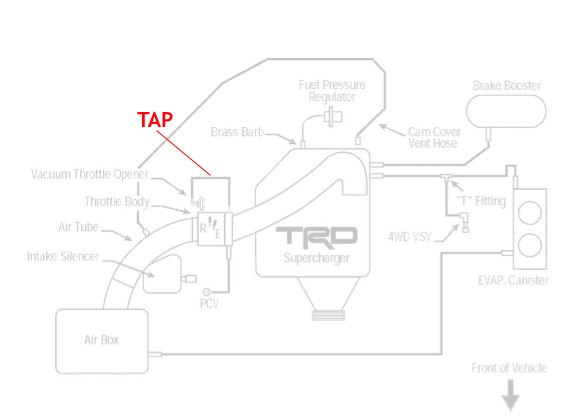

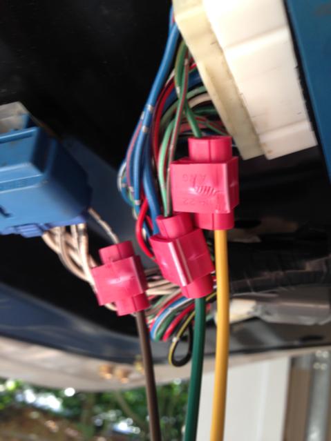

The one loose thread turned out to be the 4WD VSV line, which (credit to [MENTION=14772]shootmymime[/MENTION]) just needed to be tied in. I followed his suggestion and tapped it in off the TB:
After a couple hundred miles already, it's working like a charm.
I'm not running any fuel mods yet. Just 92 gas and a cooler thermostat, a Stant 14077, which is almost working too well. The engine stays right around 181 degrees, about 8 cooler than what it was pre-SC and stock thermostat. I picked up a set of cooler Denso Iridium IK22 plugs, but I've held off on installing them given that temperatures aren't obviously an issue yet, and the Denso dual electrode plugs I have in there aren't even 5k old yet. Playing it by ear (literally.)
If I start having any issues or want to go to a smaller pulley, I'm watching [MENTION=94545]MTD[/MENTION]'s AEM FI/C thread.

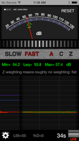

This weekend I'm starting in on my big interior project: soundproofing. I'm going to do the whole nine yards: damper, MLV on CCF, sides and roof.

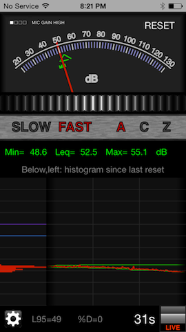

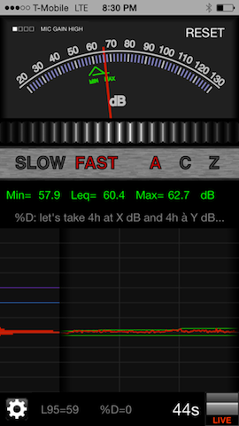

I wanted this to be a bit more useful than "look what I did", so I'm trying to capture some information that other people considering a similar project can use. Part of that is going to be getting some before and after sound readings.
I'm using logSPL on an iPhone 5 to check noise levels. I understand that a phone's microphone is not going to pick up the same range as a professional sound meter, but it will give me some idea of the ratio between pre and post installation. It supports A weighting at least.
I have already applied a sound damper to the front doors (did it with my speaker installation), so the base measurements here are not completely stock.
Baseline: engine at (cold) idle.
~55.8db, pretty even.

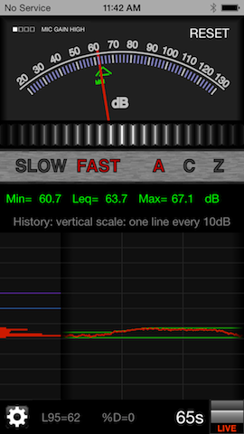

Street @ ~45mph. Speed held consistent.
~63.7db, still pretty consistent.
Since +3.0db is approximately a doubling in pressure, this is around a 6x increase over idling.

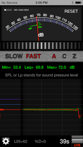

Highway @ ~70mph. Speed held consistent.
~69.8db, and pretty consistent.
Which means 70mph is around 4x in pressure over 45mph.
So, this clearly doesn't translate into perceived volume, but it's just for point of comparison later. I thought it was interesting that the implication is that a 4runner at 70mph is 25x louder inside than one at idle. Maybe that's actually true, but it certainly doesn't seem that way when you're sitting in it.

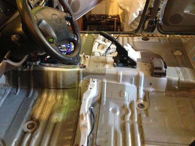

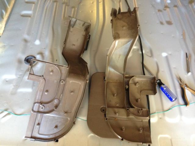

Sound proofing project started today.
Start:
Cue the music:

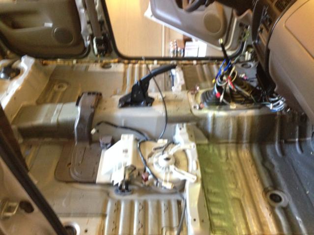

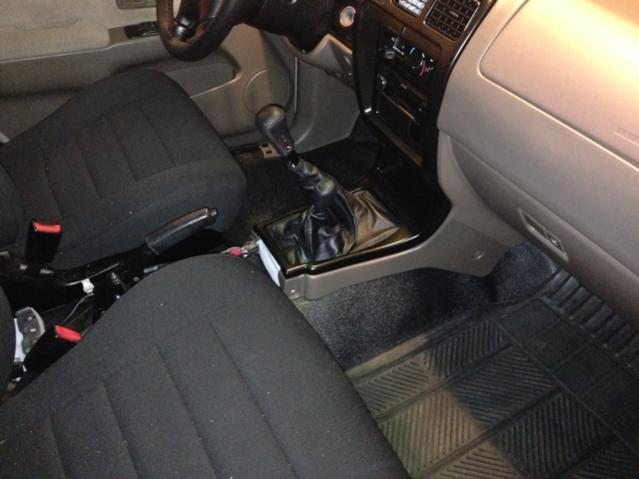

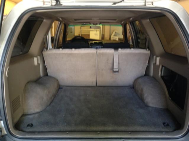

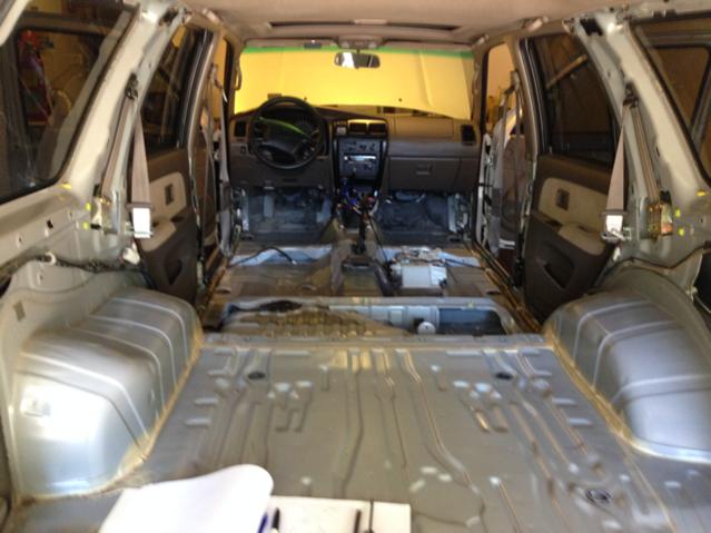

Interior came apart with no real issues. Pulled most of it apart before anyway. De-skunging everything. No exceptions!
Cleaning the interior this deeply feels like a mod in itself. I love it.
I was sort of surprised to discover how much sound proofing already appears to be in place. There are thick layers of heat proofing on the cabin floors that likely function as well as damping tiles, and jute-backed vinyl pieces on the firewall. I'm going to layer my stuff over top of them, but still, a little surprising.

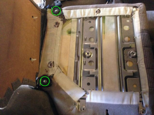

Lesson learned: If you're removing the rear seats for some reason, just pop the backs (they're held on with simple clips) and undo the two bolts per seat first.
The seat backs are particle-board, so don't go crazy. Just firm pressure until each clip gives. Much easier than getting at the hinge bolts before removing the seat backs, and you can't remove the backs separately without doing it anyway.

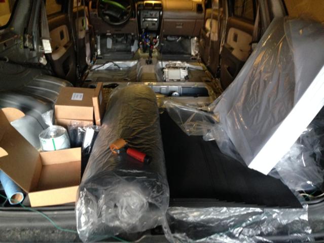

Obligatory gratuitous materials shot:
All of the materials except for the MLV came from Sound Deadener Showdown. I'm pretty pleased with everything so far. The closed cell foam in particular is awesome stuff, very high quality.
Didn't take any pictures of the applied damper tiles, but nothing interesting there. Apply to resonant panels, cover with CCF and MLV. The first step of the main job was roughing out some of the big panels using the CCF:
This stuff is awesome. Light, elastic and durable, easy to cut with just a pair of scissors. Each panel only bends one way, so that the CCF can be used as a template for the MLV (which will only bend one way at a time--no compound curves.)

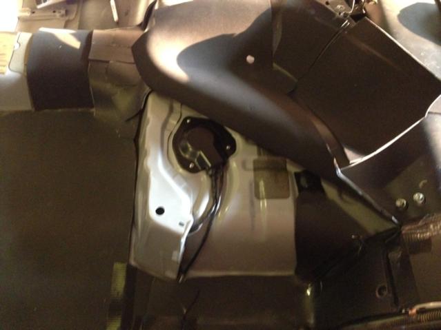

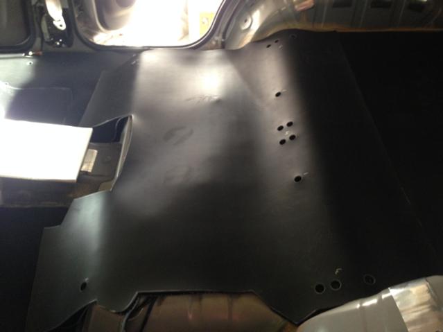

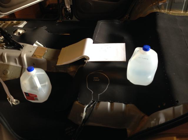

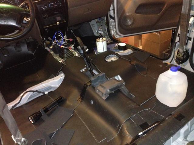

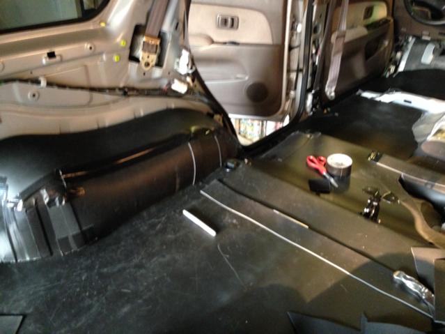

Soundproofing, Day 3
As mentioned elsewhere, this is an assload of work. Having this done professionally must cost a million dollars.
Alternatively, I'm bad at it.
Figure the floor pan barrier is around 40% done now, should have it to 50% by the time I throw in the towel tonight.
It's the compound curves that take a long time. The wheel well alone took around an hour. The second will go faster since it's a simpler shape. The duct tape is being used to hold joins while the cement cures, and just be an additional sealing layer. I was glad to see it stick to the vinyl.
I left the section over the fuel pump non-permanently attached (ie. taped rather than cemented), so it can fold up in case I ever need to get at it.
The weight of the floor and seats will keep it firmly in place and keep the barrier intact.

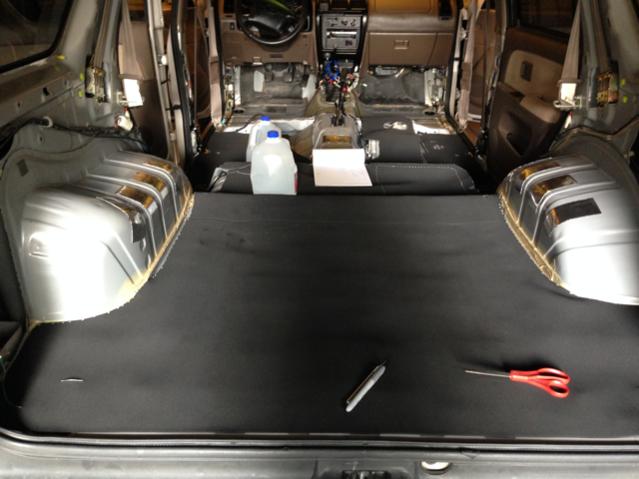

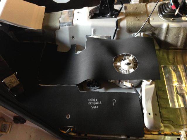

Soundproofing, Day 4.
Floor pan MLV barrier is 90% complete:
Should be able to do the carpet replacement tomorrow. I think that's going to be the hardest part.

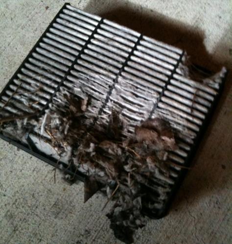

There was a bunch to catch up on. The air filter sums up the PO's attention to maintenance:

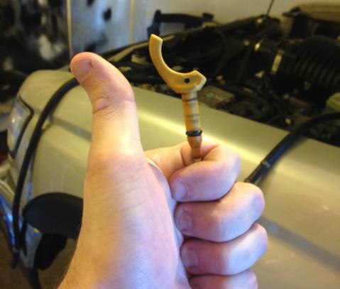

Turned out it was all pretty basic and good learning. The high idle was a bad IAC, resolved by replacing it. The bad battery was actually a bad alternator, which led to a CS-144 and Big-3 upgrade, my first proper mods.
New belts, oil, PCV valve, plugs, and a motovac session followed. At this point, the engine seemed to have a new lease on life and has run well since. During this process, a thorough de-skunging of the interior was conducted, turning up fun artifacts like this one, found resting on top of the rear heater:

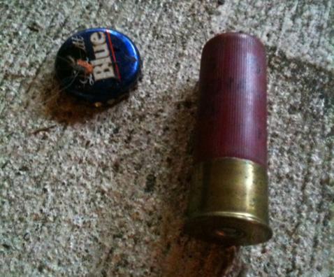

With a happy engine, clean interior, and elimination of unaccounted for munitions, I felt like it was worth moving forward with.
Dude, that air filter looks like hammered dog sh*t
Yeah, it was some fuzzy-wuzzy's home for a season or two. Tons of leaves packed into the airbox too. Poor engine couldn't breathe.
No sign of the critter, thankfully. Would have felt bad to find a little skeleton in there.

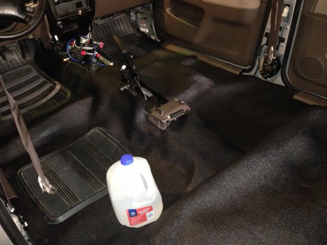

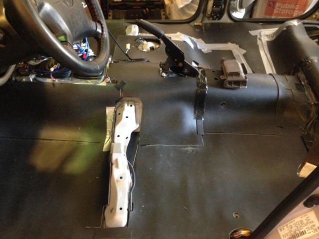

Soundproofing, Day 5.
Floor pan barrier is finished. It's not 100% coverage, but it's close to it, and I figure it's enough to do most of the job it's supposed to do. The duct tape is just sealing non-permanent installs, like the heater cover (since that might need servicing someday), and waterpoofing other seams.
Most of the work today was getting the new vinyl floor installed. My old carpet was worn through in a few places and smelled of something I've never quite been able to identify, so I figured I'd swap it out while I was in this.
It's from auto-interior.com, and I have a few things to say about it. First, the molding leaves something to be desired. While it fits, it is far from being snug or even drop in. I suspect there will always be some looseness and that will bug me. Second, the wheel well moldings are a complete joke, don't even bother. Flat pieces of material would have been more useful, instead these are lightly deformed and worthless. I'm going to use my old well covers instead. Which bugs me.
But on the upside, it is a robust and quality material. I have no doubt someone could be axe murdered on it and it would hose down just fine. Very pliable when heated in the sun too, which made it easier (and much sweatier) to install.
Why vinyl instead of carpet? Besides being waterproof and more durable, three reasons. First, I wanted to go with a black floor, since I'm generally following that motif on the interior. Here's the other two reasons:
White cat hair is a part of my life, and black carpet would never be rid of it.

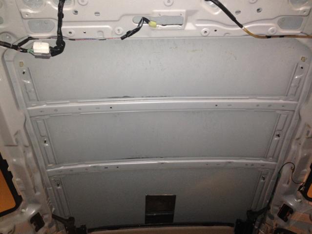

Soundproofing, Day 6.
All of the hard parts are basically done.

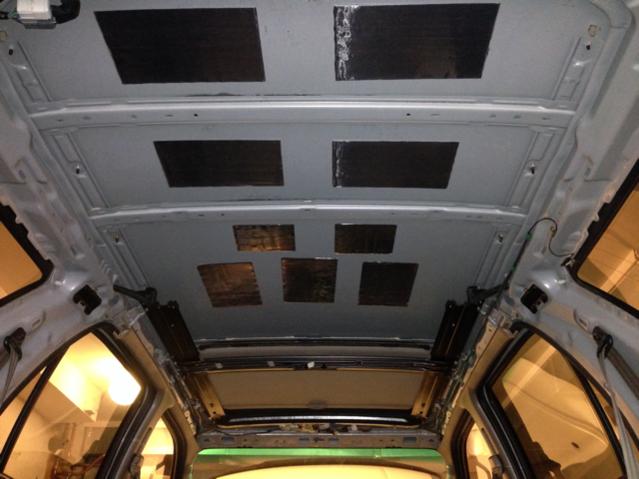

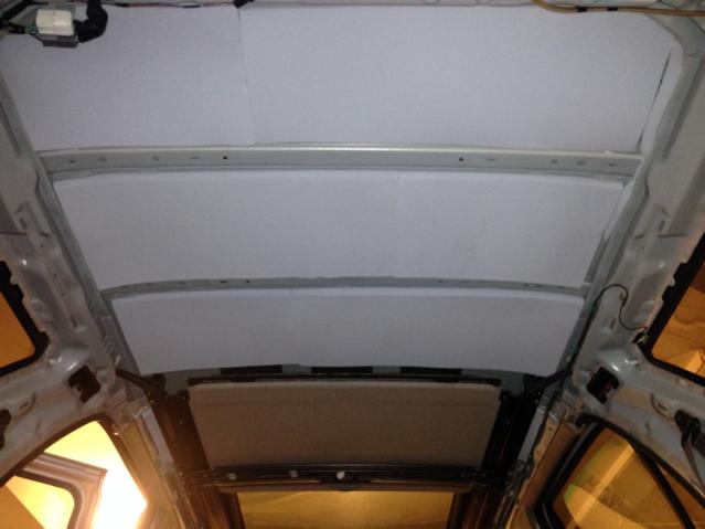

Did the roof first thing today. Hardest part by far was just cleaning up the old jute that was glued up there. I followed the advice of my betters and gradually scraped it out with mineral spirits. All clean:
Next, applying the resonance damping. This small amount completely changes how solid the roof sounds:
And then the melamine foam:
This stuff is a freaking dream to work with. It's basically the same stuff as those "Magic Eraser" cleaning pads, except with a hydrophobic treating that makes water roll off of it. Cuts super easily, and is light enough to be tacked up with hot glue. I covered the roof with it, and packed it into some of the voids as well. It's not MLV, but it does absorb some noise.

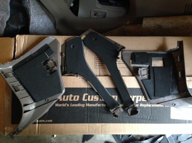

Kick panels and trim got some damping and sound barrier treatment too:
Those feel much more solid now. Need to paint them black at some point to match the rest of the trim, and now the floor.

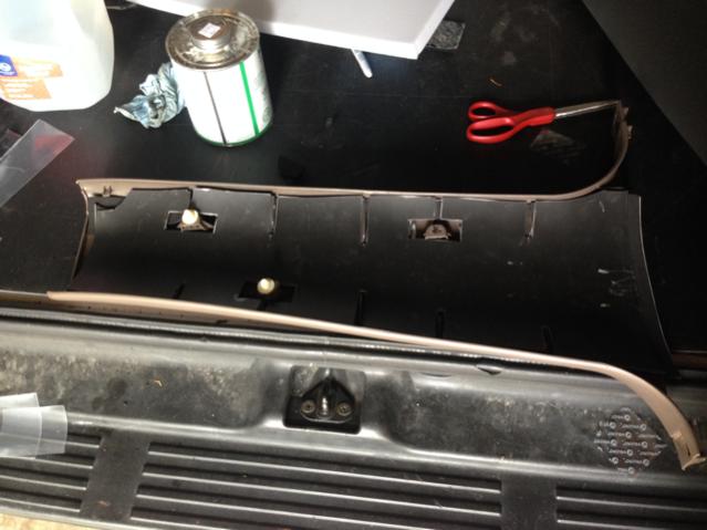

Soundproofing, Day 7.
And on the seventh day, he rested.

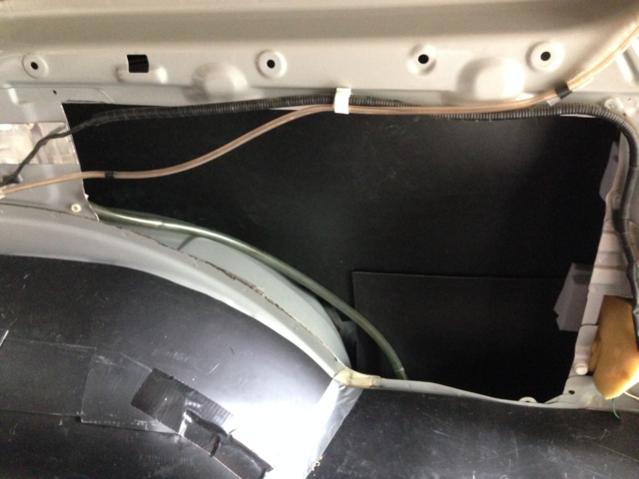

Then finished the rear quarterpanels and assorted trim, loaded up with sound barrier. These B-pillar pieces were a pain in the ass to get back on due to the floor being thicker from the sound barrier:
Managed to get a nice big swath of MLV in behind the cargo cubby:
And stuffed a bunch of leftover melamine foam in the the voids around the rear gate:

With the thing being put back together, I couldn't wait to test it.
This is:
  • Full floor complete, with damping tiles and nearly full coverage with MLV on CCF.
  • Roof complete, with damping tiles and full coverage with melamine foam where it won't impede the sunroof.
  • Damping tiles on front doors from previous job.
  • Kickpanels, B-pillar, and rear quarterpanels damped and with MLV on CCF where possible.
Short Version
Objectively, sound pressure was reduced by 3.3 dB in both idle and 45mph street. That's around 2.15x reduction. (See this post for the baseline I'm comparing to.)
Subjectively, it's definitely noticeable. It's not like you're going to wonder if your engine is on, since our hearing covers a remarkable dynamic range, but you would notice the difference.
logSPL Readings
I screwed up the 70mph sample--it was switched from A to Z weighting, and there was a bunch of traffic around me anyway. I'll grab another tomorrow and post an update.
Cold idle, ~52.5 dB (down from 55.8)
45mph street, ~60.4 dB (down from 63.7)
A subjective observation at this speed (and at 70mph) was that the sound in the cabin seemed to be localized behind me, towards the rear. If that's actually the case, then I think the rear doors and gate treatment is going to help.
Thoughts
So this is a good improvement. 3 dB isn't a big number, but it's a logarithmic scale and a >50% sound pressure decrease. Of course, your ears just adjust down so it doesn't seem that way.
Now, is it "30 hours of effort" or "$750 in materials" improvement? Hard to say without the doors and gates done, but I would bias towards "no, probably not." I don't think this would be worthwhile unless you're really into this kind of thing. Bunch of people here are (a reason I love this forum), so I wouldn't want to discourage anyone, but nobody should do this expecting to hear pins dropping.
What I will say, though, is that music is noticeably better and clearer. Others have mentioned this, but lowering the sound floor helps a lot, and all the mass added to the trim panels has basically eliminated resonance. An audiophile (which I am not) would absolutely want to do this, assuming their preferred playback device is a third gen 4runner.
I'll get a 70mph reading and update again once the doors and gate are done. Whee, science.
