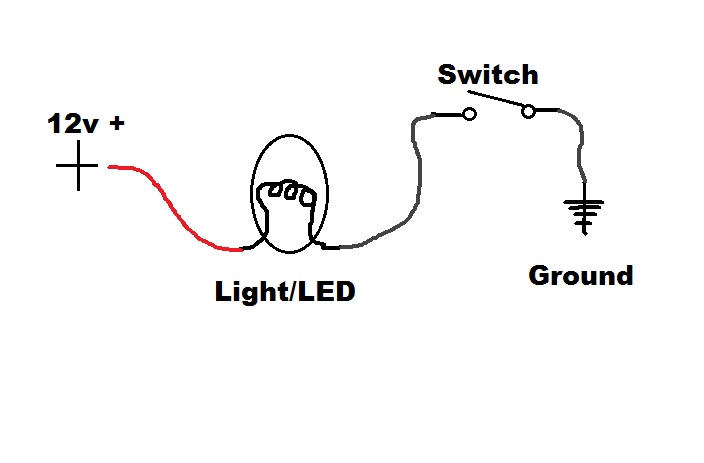

Im not good with electricity, I tried the under the hood lighting and my mercury switch got too hot and sort of disappeared. I followed the DIY so I'm not sure of what I did wrong so I gave up..... flashlights work too. :pout:
Good thing you have a fire extinguisher! :madgrin:
Sounds like you might have connected power to one side of the mercury switch and ground to the other side?
This seems overly simplistic, but maybe it'll help?
Yep, I DEF fudged that up.
THANKS!

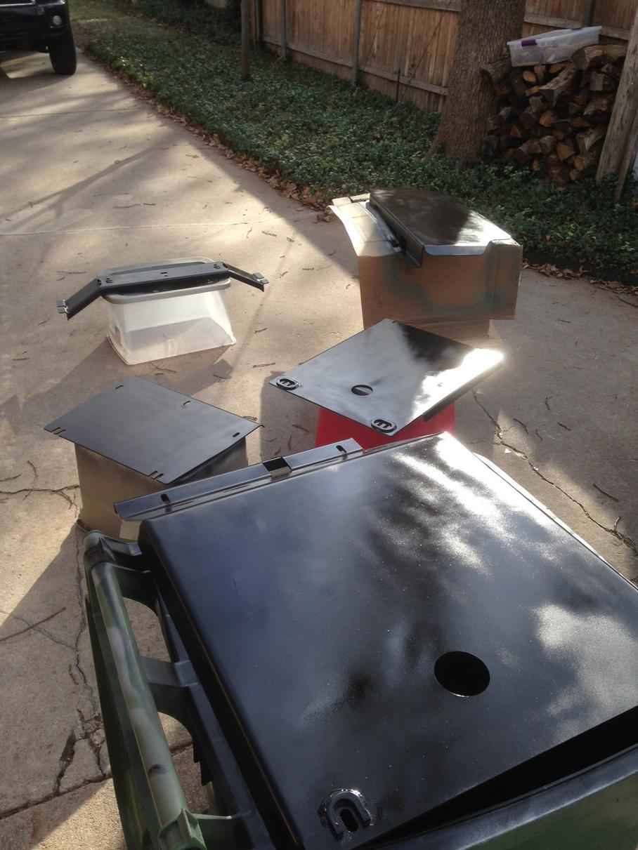

But I fought the good fight... got them all painted before the rain and 45* weather today... #Texasweatheryall
The attachment shows the second to last coat. The final coat isn't quite so tiger striped...

Got my RCI skids in, sanded them with 80 grit, to cut through the mill scale, then hit with a self etch primer and some Rustoleum Professional paint.
Very Very impressed with the quality and ease of installation on these.
Pics below of the process and the difference in thickness from stock to the 3/16" thick skids.
