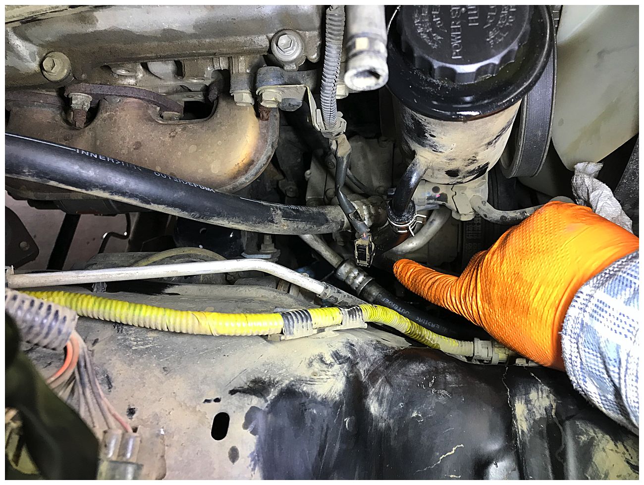

Can you help identify this electrical plug behind the PS resevoir?
slomatt
While flushing and filling the power steering fluid on my 3rd gen I noticed an unplugged electrical connection behind the power steering reservoir and above the A/C compressor. Does anybody know what this is for?
I have a 2000 Sport SR5 5spd. I'm guessing this plug is for a feature not included on my truck.
Thanks
http://www.blankwhitepage.com/gallery/albums/t4r_mods_misc/IMG_0761.jpg
Is is the sensor actually connected to the p/s pump? Not 100% sure what you are referring to being there are multiple connectors in your picture. If its the one on the P/S pump I think this may be it....
PS idle-up switch. If the power steering pressure goes up high enough, it tells the ECU to slightly bump the idle up to compensate for the increase engine load the pump puts on the engine in those situations.

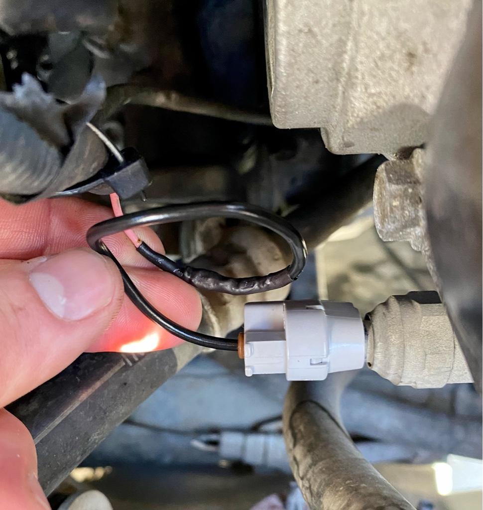

[MENTION=48892]slomatt[/MENTION] as others have said, the pink wire behind the power steering reservoir is likely your power steering idle-up switch.
If you need to repair it, the part numbers are:
- 9098011428
- 8299812440
One part is a connector housing and the other is a wire with the connector attached.
Here’s mine after repair:
When your PS idle-up switch is working, your RPMs will briefly increase a little bit when you are idling or going very slowly (like a driveway or parking lot), and you crank the steering wheel.
EDIT: I should add that the original connector housing looks like yours in the photo, and the replacement connector housing is bigger and gray like in my photo. But it works. I have a 2000 SR-5.
Have you tried plugging it into the matching connector about 2" away from it?
(yes, PS idle-up switch)
-Charlie
Thanks for all the replies. I was in a rush when finishing up the power steering flush and completely missed the connector. Doh. Based on the amount of dust in the plug it's been disconnected for a while, probably since the timing belt was changed.
Luckily, it is probably the least important plug related to the engine...
