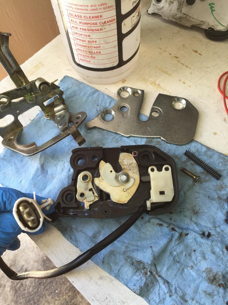

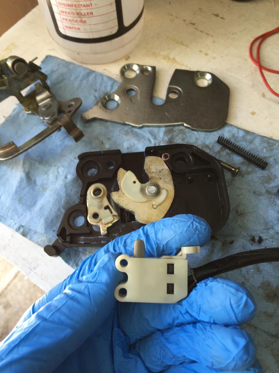

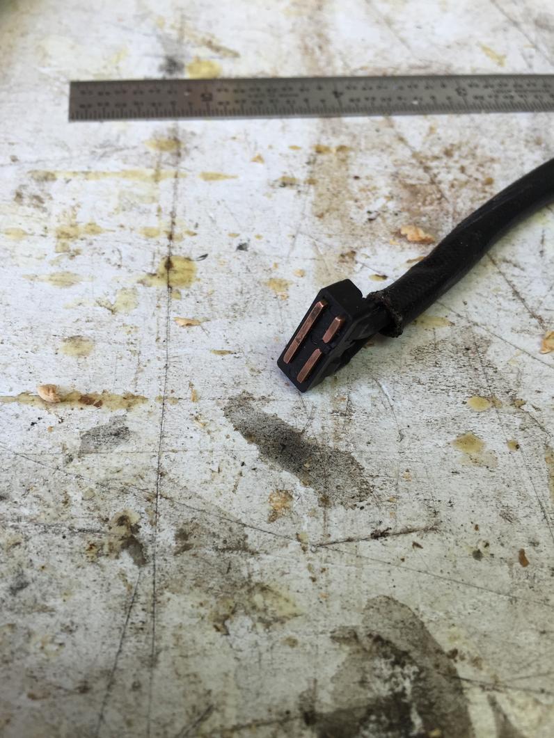

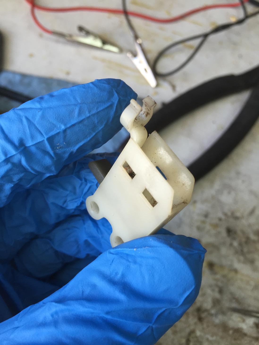

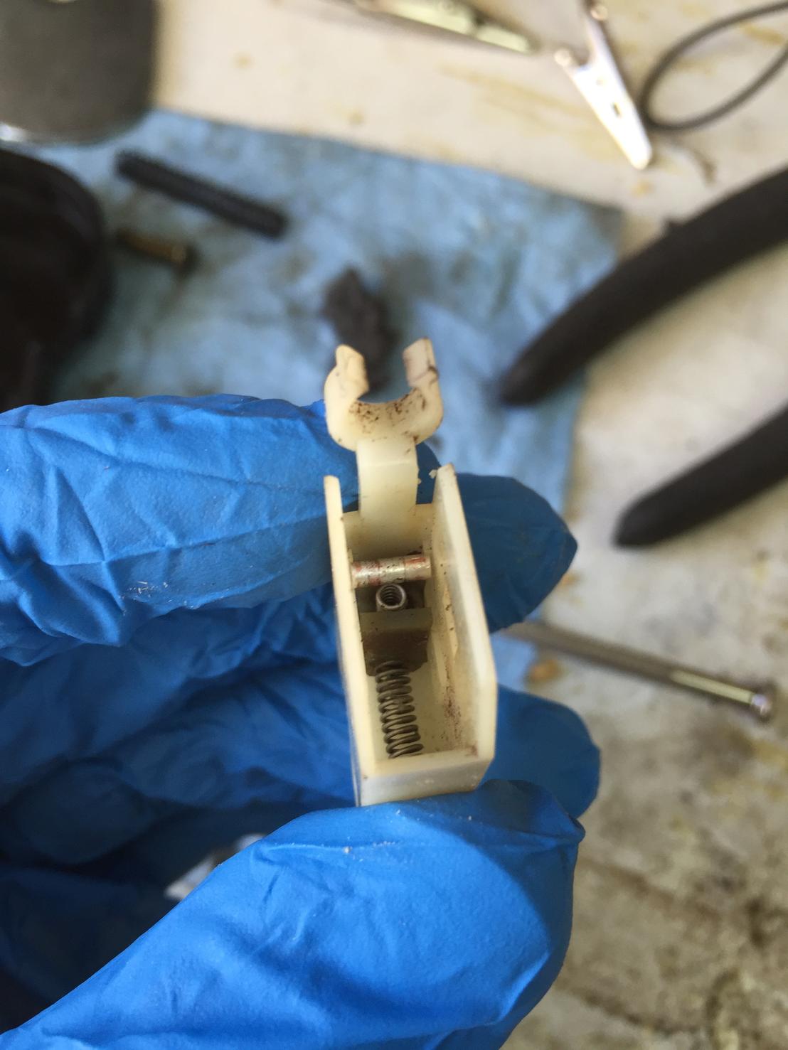

I got 100% of the rear window solved today, thanks to some help from rad4runner!
The issue was the tailgate "lock detection switch". I removed the latch, disassembled it, cleaned all the parts and re-greased before re-assembly. I've attached a photo of the latch assembly and the switch itself open.

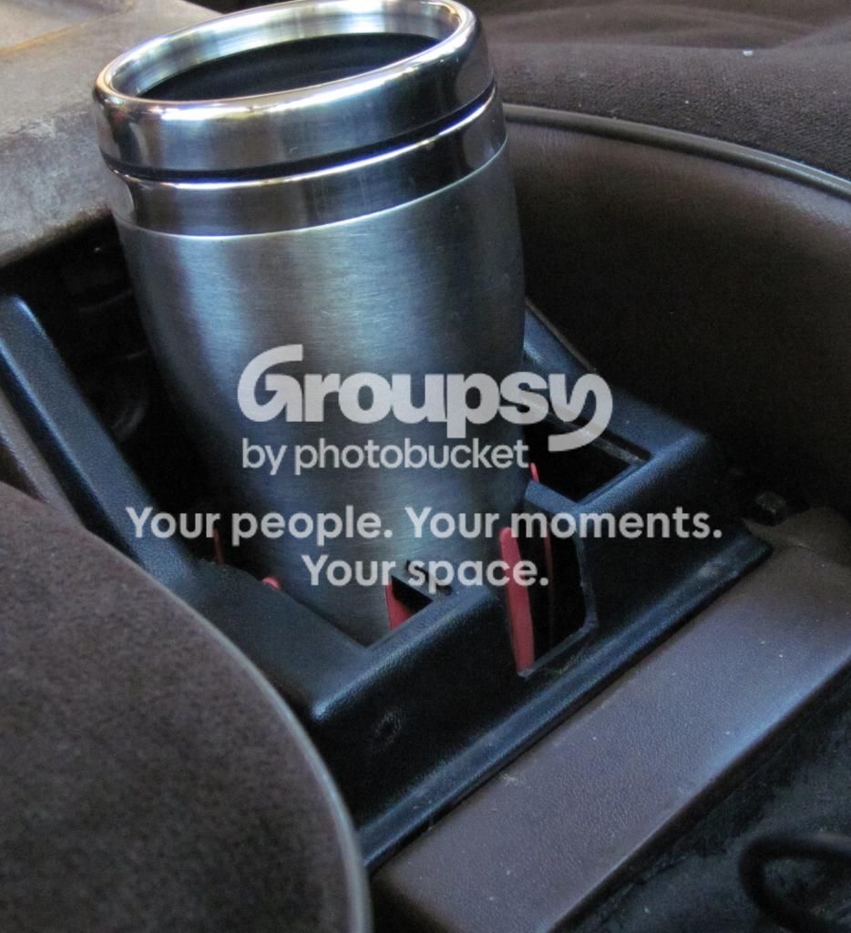

First-Gen Cup Holder Mod (Work In Progress)
Previously, I relocated my console switches...
Now...
user101367_pic27282_1354239332_zps9382a735.jpg~original
Cut the insert up to accommodate "standard" ceramic coffee mug with handle. Gold marking is reference for hole I will make for smaller diamater base of skinny but tall "travel" cup.
20130901_008_zps81bfabdf.jpg~original
Slotted for mug handle.
20130901_009_zps028740c1.jpg~original
Bottom of cut level with transmission cover trim, so that's the lowest the mug could sit. Placing mug deeper will not work because mug handle will bottom out on transmission cover trim.
Right now it works in this configuration, altho not pretty. Mug would rest on the stock bottom.
20130901_002_zps1c755206.jpg~original
I have now opened up opening on stock bottom.
IMG_3488_zps7e2a7a98.jpg~original
IMG_3491_zps27af1621.jpg~original
Taller, skinnier travel cup will rest in that step below stock bottom...
001_zpsa36fab10.jpg~original
Next step is do fiberglas and resin work to make it pretty...

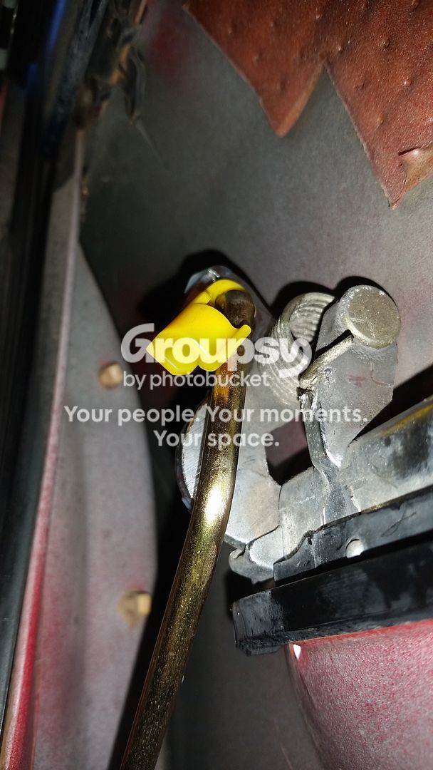

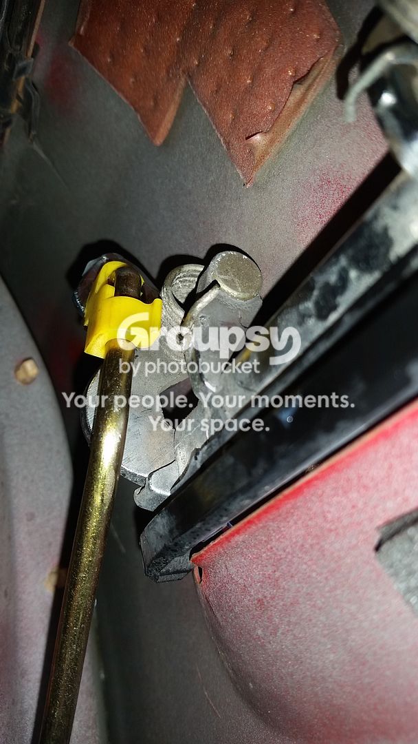

Replaced Broken Plastic Snap on Outside Door Handle

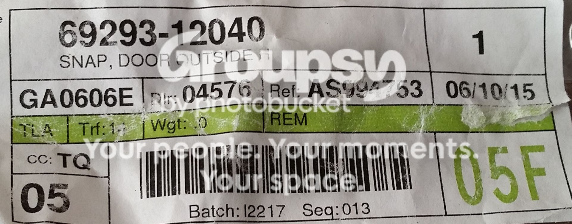

Yellow plastic snap on outside door lock (driver side) that locks link rod between door latch and outside door handle broke...
This is the correct part from dealer:
20150817_181821_zpsnazkgeez.jpg~original
Yellow Snap/Clip goes into here:
20150816_191139%20copy_zps3nomginq.jpg~original

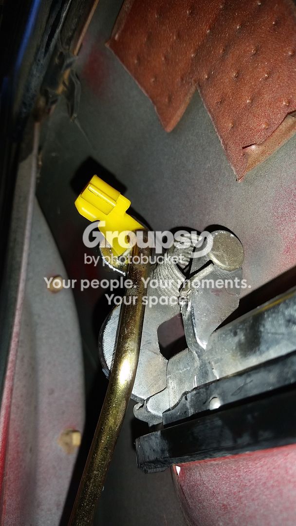

Insert snap into opening on door handle:
975aa4d5-2d80-4d89-8518-75b116988d79_zpsb3s6nklk.jpg~original
Insert Link rod into snap:
20150817_171950_zpsqmqeysbm.jpg~original
Swing snap down to wrap around link rod:
20150817_171959_zpssn0ngcys.jpg~original
20150817_172021_zpsabjpwgxb.jpg~original
Recommendation, buy a set (try ebay), at least for the driver side (most used) and keep it in vehicle. Set will take up tiny space and does not cost much, but will save you time and money when needed.

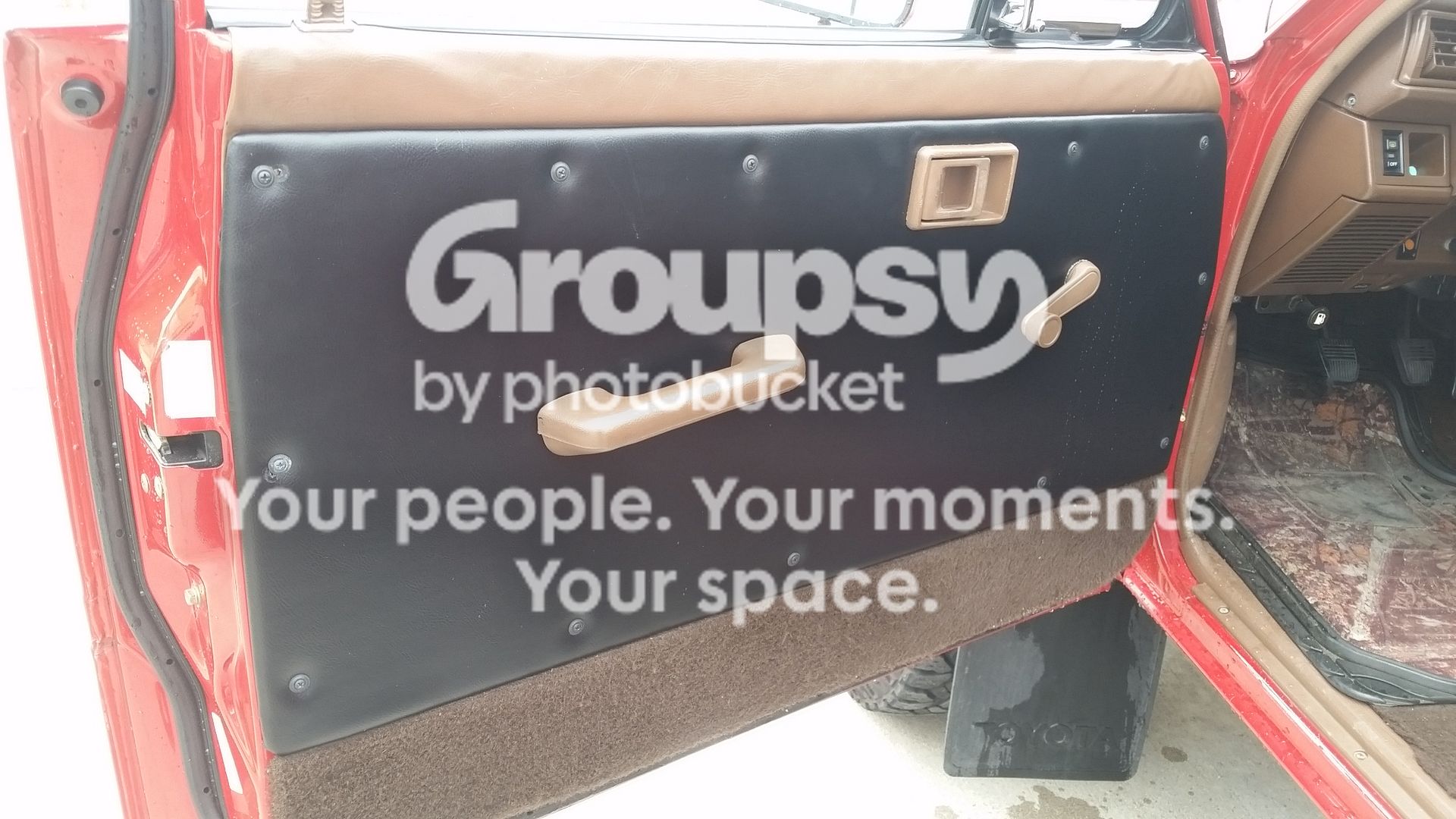

Getting Rid of Hidden Fasteners on Door Panel
HAPPPY NEW YEAR, guys and gals!
I detest hidden fasteners and dust-trapping velour on body panels so here goes...
Replacing stock hidden fasteners:
20151201_144157_zpsbzmksr08.jpg~original
File corners into hole to fit the expansion/nylon nut, and keep it from rotating
20151201_144213_zps0ou3z8ce.jpg~original
Nylon nut attached:
I purchased nylon nuts for 7mmx7mm hole and #8 finishing screws from ClipsAndFasteners.com - Automotive Retainers,Clips and Fasteners.
20151201_144219_zpsjyxgpv2p.jpg~original
I replaced the existing wooden panel with lighter 1/4-inch thick foam-core poster board wrapped with vinyl for wipe-down/spray and wipe maintenance.
Dated looking Stock Brown that traps dust (note simple screw mounts):
2015-12-16%2016.46.25_zpsgoc8hwiv.jpg~original
Simple, Clean, Utilitarian Black Vinyl Covering (note simple screw mounts):
20160115_112810_zpsnmzmth7u.jpg~original
Lower dust-magnet will also be replaced with vinyl, eventually will have mesh pockets.

Nylon nut attached:
I purchased nylon nuts for 7mmx7mm hole and #8 finishing screws from ClipsAndFasteners.com - Automotive Retainers,Clips and Fasteners. [/QUOTE]
Looking good!
For what it's worth the Lowe's in my area carry those snap in nylon nut inserts #008236715767. They also Cary the push Fasteners aka "Christmas tree fasteners" that secure the plastic panels in the cargo area of the first gen. I used #008236715910 which unfortunately are black in color instead of gray. They had some gray ones also but they were too short. Could probably research it thru the manufacturer- Hillman and possibly get some gray ones the correct length.
They are in the hardware section in the drawers marked automotive Fasteners or hard to find Fasteners.
Keep up the good work RAD4runner! I've been following this thread for some time...good stuff!
Looking good!
Thanks!
The nylon nuts are a around $6.00 plus a couple dollars shipping, so happy with it. It's also good to find square or rectangular ones. Round ones would tend to turn in the hole and make it hard to screw in or unscrew.
Love working on, customizing and making the truck more reliable than stock :)
... They also Cary the push Fasteners aka "Christmas tree fasteners" that secure the plastic panels in the cargo area of the first gen....
Yeah... but that's exactly the "hidden" fasteners I'm trying to get rid of. I prefer simple screw attachment that only requires a Philips screw driver.
