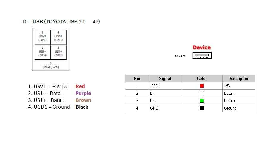

[MENTION=67786]4RunAmok[/MENTION] do you have a link to the USB cable you bought? I found an aftermarket one from China on amazon but the quality sucks. When I used it with my iPod and iPhone the sound quality would crackle and pop and then lose connection after a few minutes.
I have been using the OEM Toyota/Scion USB adapter modified and it works okay but it will randomly drop the connection a few times a week and doesn't work with iPhone 5s lightening cable. Do you think I could cut the OEM Toyota USB adapter cord in half and splice on a standard USB A female cable on the other end?

Also, I successfully spliced a standard USB A female to the connector side of the OEM Toyota USB adapter harness and it's working perfectly so far with my iPod. Below is a pinout diagram I made that will hopefully help anyone else that's trying to do this.

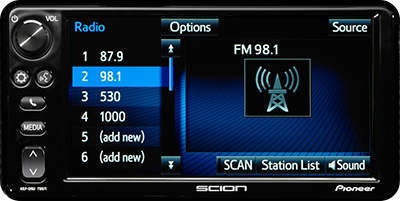

2016 Scion Touchscreen
Just came across the 2016 version. Definitely looks different. Screen is 7" as compared to 6.1" with the 2014-2015. Functionality at first glance looks the same. Not sure what color the back lighting is or the size as compared to 2014-2015. Not sure what the connections on the back look like either. Just thought I'd share. Check it out.
