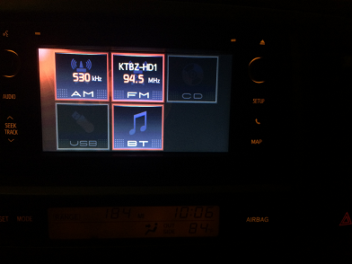

You don't have the microphone installed, but you see BT as an option? Can you select it? Going to have to take a photo of as many options as I can get on the screen and see if you see something different, since I have every option working (except CD, since, I rarely ever use those)

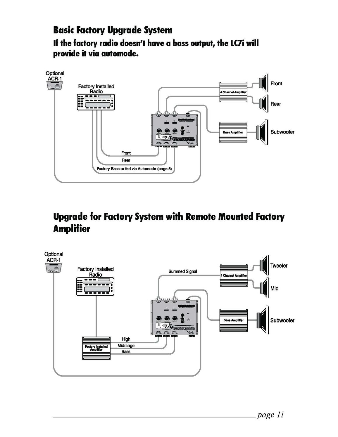

I am getting ready to install the AudioControl LC7i (LOC) along with 2014 Bespoke (top diagram below) but I have eliminated the JBL amp and replaced it with a 5ch aftermarket amp. It appears that you could also use the LC7i with factory amp but based on the bottom diagram below it would require you to still add aftermarket amps. The only reason that the bottom diagram configuration would make sense to me is if you still wanted to keep the 10 speaker JBL setup. By eliminating the JBL amp like I did, you lose the center channel dash speaker and the two rear cargo speakers.
So to answer your question 'No one on here (that I know of) has used the 2014 Bespoke while keeping JBL amp'. It should be possible but it's just a question of how much time/money you want to put into it. The 2013 Bespoke (the one I am using now) does have RCA outputs and will work with the JBL amp along with one of the JBL Amp interface adapters (TYTO-01 etc). This was the set up I was using for a little while before getting rid of the JBL amp.
Hope this helps, sorry for such a long answer.

I don't have a BT mic installed either, but th Bluetooth Audio is selectable and works. Just the phone part won't work without the mic, but it is also selectable and you still get notifications of calls.
That's good to know! As I understood it, the bluetooth wasn't enabled without it.

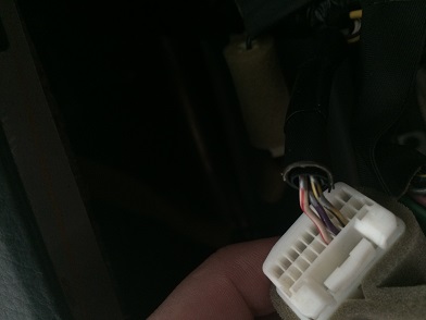

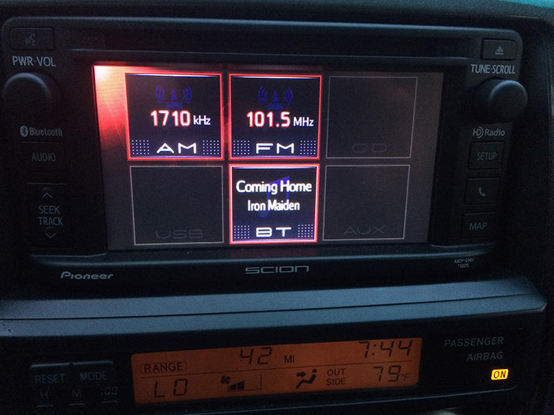

I've attached pictures of my source screen and 20-Pin connector. Would you mind replying with your source options displayed? The cable I ordered from Thailand would have required too much work to make it work so I'm going to get the same type of cord you have.
As for the AUX, I found out the Scion AUX pins on the stereo are in the 28-pin connector. So for my 4Runner's factory 20-pin connector, only three wires are on it for the steering wheel controls (radio and phone).
Bonus: what wires are coming out of the back of your 20-Pin connector?
Oh this would require me taking apart my dash to look! LOL! Which probably won't happen until/if I add the backup camera wiring.
You were saying your console does not have the aux plug, so it very well may not be in your wiring. I don't recall any of the larger plugs having that few wires going into them, so there could be a big difference between our harnesses.
Here is the screen I show...
This is what I show and I have the aux port in my center console.

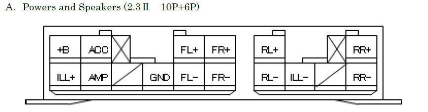

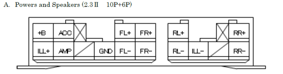

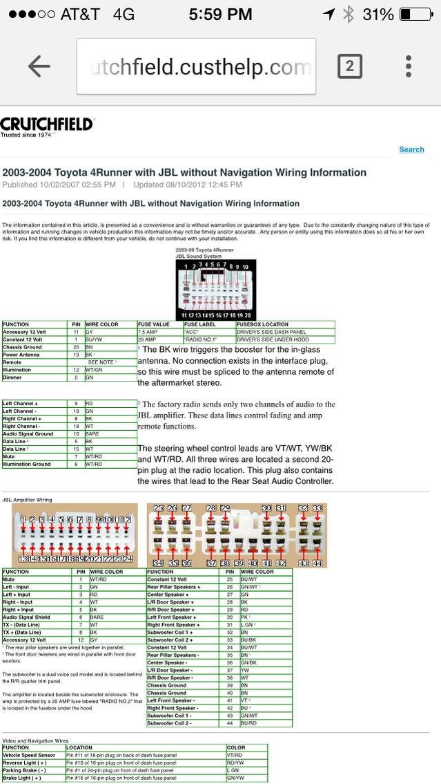

As far as I know, the issue is because the JBL equipped 4runners use a single 20 pin (male) harness from the vehicle side (as pictured below) to provide power, ground and speaker signals to the JBL amp and the Scion PT546-00140 requires the 10P+6P. I am assuming that non-JBL 4runners are equipped with this 10P+6P harness from the vehicle side. It is my understanding that the non-JBL headunit (similar to the PT546-00140) that comes stock in some 4runners have an internal amp that feeds the speaker signals directly from the head unit to the corresponding speaker.
