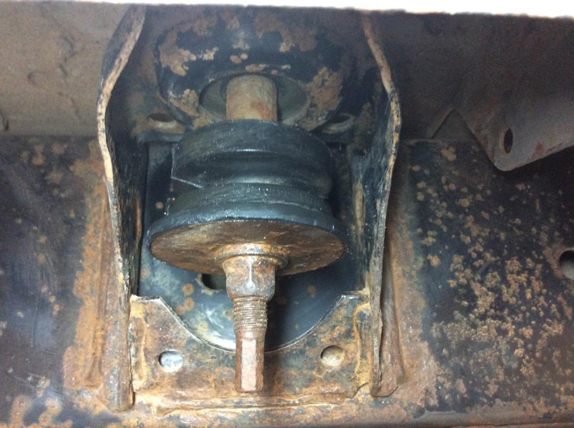

All 5 of my Rigs center body mounts [on both sides] look exactly like that. At first I thought they failed. But not all 10. Even my one with the perfect frame has that same spacing. So unless i had 10 body mounts fail the exact same way, That is how they are supposed to be. Which doesn't make any sense at all.
Regarding the OEM body mounts . . .
It was by design though to leave that spacing there was on purpose...;-)
Brillo to the rescue!
Thank you j4run, was going to do some research on that center bushing/mount as I had noticed it before and was wondering why it was not a full sized bushing.
I had even taken additional pictures and was going to start a separate thread if I wasn’t able to find an explanation.
Can’t imagine there’s enough flexing in the frame as the explanation mentioned in the included link but who really knows.
I’m just happy to hear that it’s the way it came from the factory and that i’m not going to have to start replacing mounts.

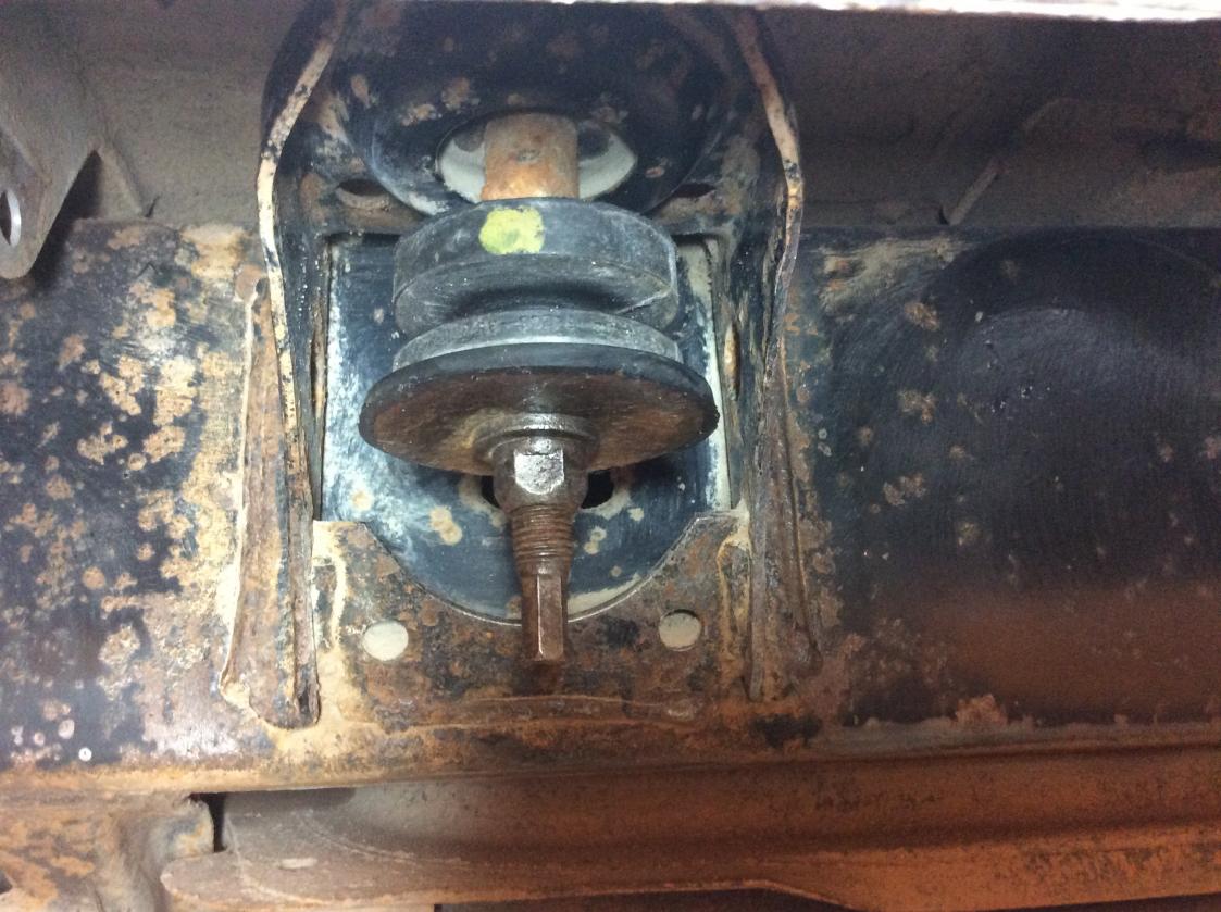

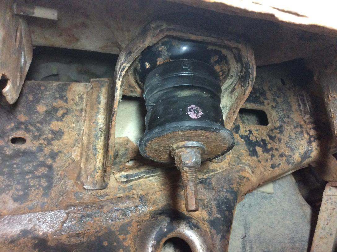

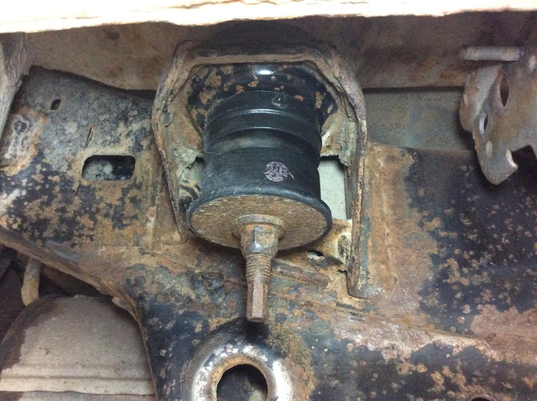

Picture of rear & center mounts below:

Behind the body frame mounts. Are those rotted out and no steel left? Or just shadows etc. If that's rotted out. You be plating like I do very soon. ..;)
Sent from my SM-J337V using Tapatalk
No rot or rust through anywhere, that’s just some dirt that I missed when i first hit with power washer.

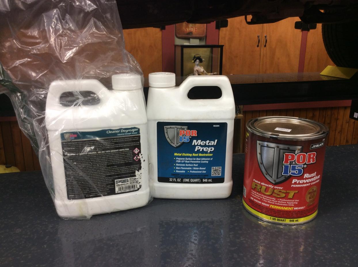

Hoping i’ve removed enough of the surface rust at this point as planning to start the POR-15 process......thoughts?
POR-15 likes rust, so I'd just go for it. Use the recommended process - degreaser, metal etch/prep, then POR-15. Fun!

LEON!!!..........got all my products lined up and ready to go. Just want to make sure I have everything cleaned up enough to make this a success as no way I want to have to do this again!
Will wait a couple weeks after applying the POR-15 products to hit the entire undercarriage with Fluid Film which will then become an annual event every Fall.
