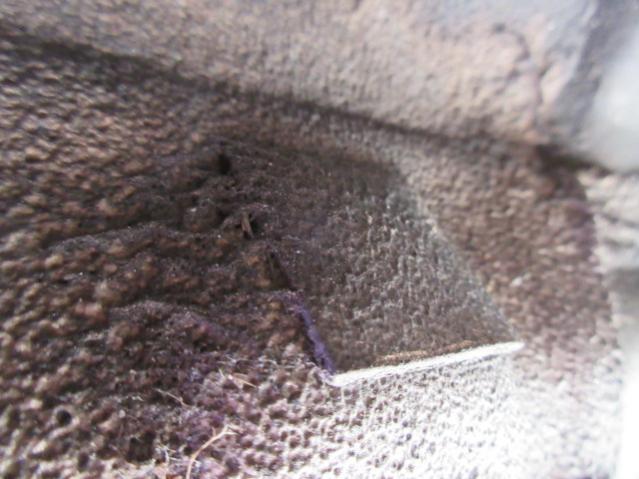

Nice tip on those little square covers, I never really noticed them. I always wondered how they would have painted the inside of the rockers, I guess thats how. I pushed on them and they feel bouncy like there's a round hole under them. So where did you buy those body plugs for exact fit? Access plugs are easier than jamming a spray tube up thru the drain holes. If I do the body plugs, I can just do a quick blast with the spray gun.
You don't even need to do that. Rockers are accessible to spray from the screw holes in the door jamb. You don't even need to pop off the plastic trim.
Yeah the kick plate screws are another option. So yeah we have 3 access options. I'm liking the plug hole on the backside idea though cause I can give it a quick 3 second high pressure blast with spray gun while I'm doing the rest of the rig. I think I will only need to one plug per rocker cause of the spray I have at 80 psi. It will fog out the whole interior of the rocker. Any of us doing any of these ways will not be complaining about the rockers rotting out.
