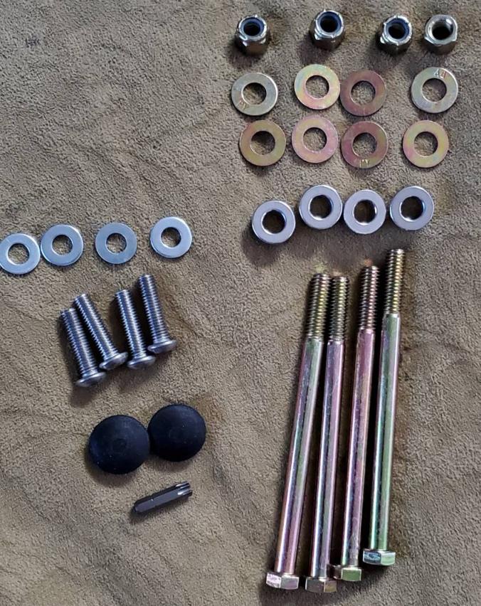

Did you get all the hardware included? A couple people on the other site have reported they were missing the spacers, and only got two security bolts. Another guy said he was missing all the spacers and the security bolts were too short.
Mine is scheduled to arrive tomorrow. I’ll report back here with what I received.
I think I got everything. Don't know about the length yet. 20230506_191323.jpg

Yes, on Sunday. Took me about 35 minutes. The included security bolts are a bit tricky to get started, so I went to Ace Hardware and got four M8x40mm 1.25 pitch button head Allen bolts.
I will say using the M8x40 button-Allen bolts on the front brace holes worked like a charm! Super easy to thread in and I didn’t even need to use a Jack to hold anything in place. I used the provided security bolts on the rear brace holes. In retro spec I probably should have done one button-Allen up front with a security bolt also and the same in the rear of the brace. Oh well, maybe if I’m bored one day I’ll do that. I also dabbed a little anti-seize on the bolts.
M8x40mm 1.25 pitch button head Allen bolts (Ace Hardware, $2.39 ea.) with one of the provided M8x30mm 1.25 pitch bolts.

I was unable to install due to the fasteners for the forward part of the brace being too short. They need to provide longer bolts, or you can go source them beforehand, as was suggested previously. A little disappointing for sure. Otherwise, the product looks great. I'll have to go find some longer fasteners.

The security bolts are slightly shorter than the OEM bolts that connect the cross-braces to the frame of the vehicle. It's not an issue if you have aftermarket skids and have already removed the cross-braces.
Overall, they look nice and do the job but kinda wish they did their initial R&D with a completely stock 4Runner to realize that slightly longer bolts are necessary.
