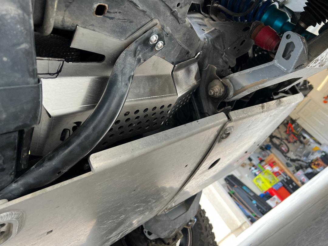

Installed mine and helped to install my buddy's skids today.
Nothing to write home about the install. First time took a while to do. Second time around took about 30 min.
1. Did replace the security screws with longer allen head screws like everyone else.
2. if you don't reuse the braces, install will be so much easier, because those braces have tension on them and fighting gravity, so getting those allen head/ security screws started without releasing the tension kinda sucks. What me and my buddy ended up doing was using two floor jacks, made starting those screws easier and reinstalling our RCI skidplates also easy peasy. I reinstalled those braces, because it makes theft that much harder.
3. clean the bottom of your truck before installing....eating dirt is sorta fun until u get it in your eyes.
4. i had to mod my skids because it interferred with my sliders (which uses U bolts). If your sliders doesn't use U bolts then no problemo.
5. i have no rattles or any issues while driving even though the driver side cat is touching the skids. I see this as a non-issue.
6. Dang thing is sharp, Easy to slice your hands on some of those edges. I wore gloves, but my buddy didn't.
7. having 2 people doesn't necessarily make installation faster, but having a floor jack or jack stands to hold up those black braces will.
cheers.

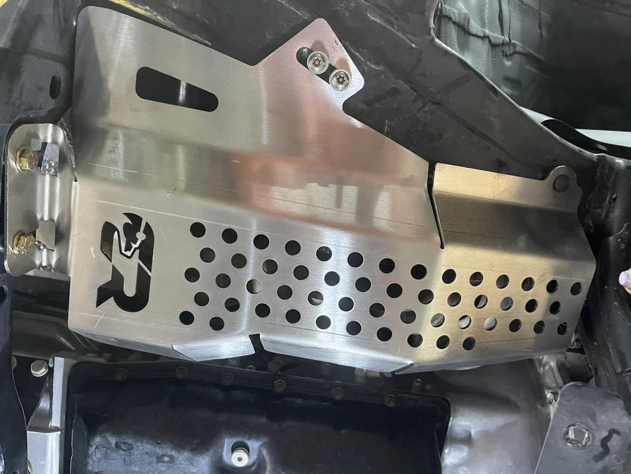

Finally got my Cat shields installed today. Was able to use all the supplied hardware and security bolts. Possibly because, as MrBlah mentioned, I don’t have the braces. My C4 skids are so wide and the angled up flanges on the skids are at least 2” high, the braces had to be removed for the skids. I forgot to take a pic with the skids back in place.

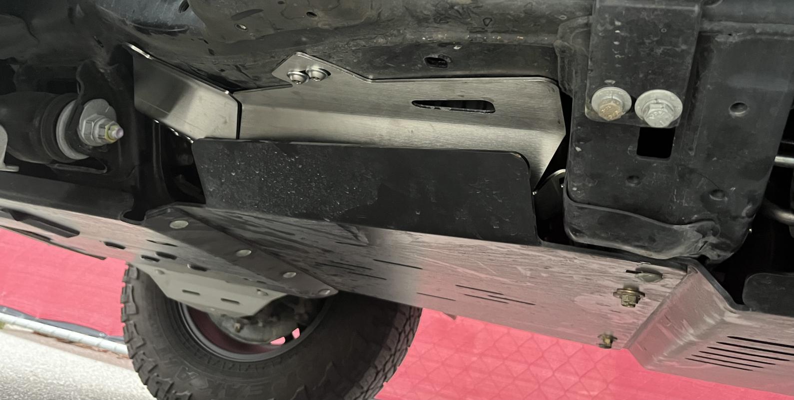

Mr Blah, here is a pick of my C4 skids back on and the driver side cat shield. Notice how the braces were removed. Thanks for your and everyone else’s input.

What is the purpose of the brace, or does removing is hinder the support in any way?
They just add a little rigidity and protect the cats. They don’t effect anything if you have skids in that area. I haven’t had them on for two years now. If you have aftermarket skids, they have to be removed sometimes depending on the skid design. The full skids tied together act somewhat like a large shear panel and stiffens things up. Since mine were removed, the supplied security bolts worked perfectly. If you plan to reuse them you will probably need the longer M8 x 1.25 x 40 mm long bolts that others have mentioned. If you don’t have skids I would reinstall them.
