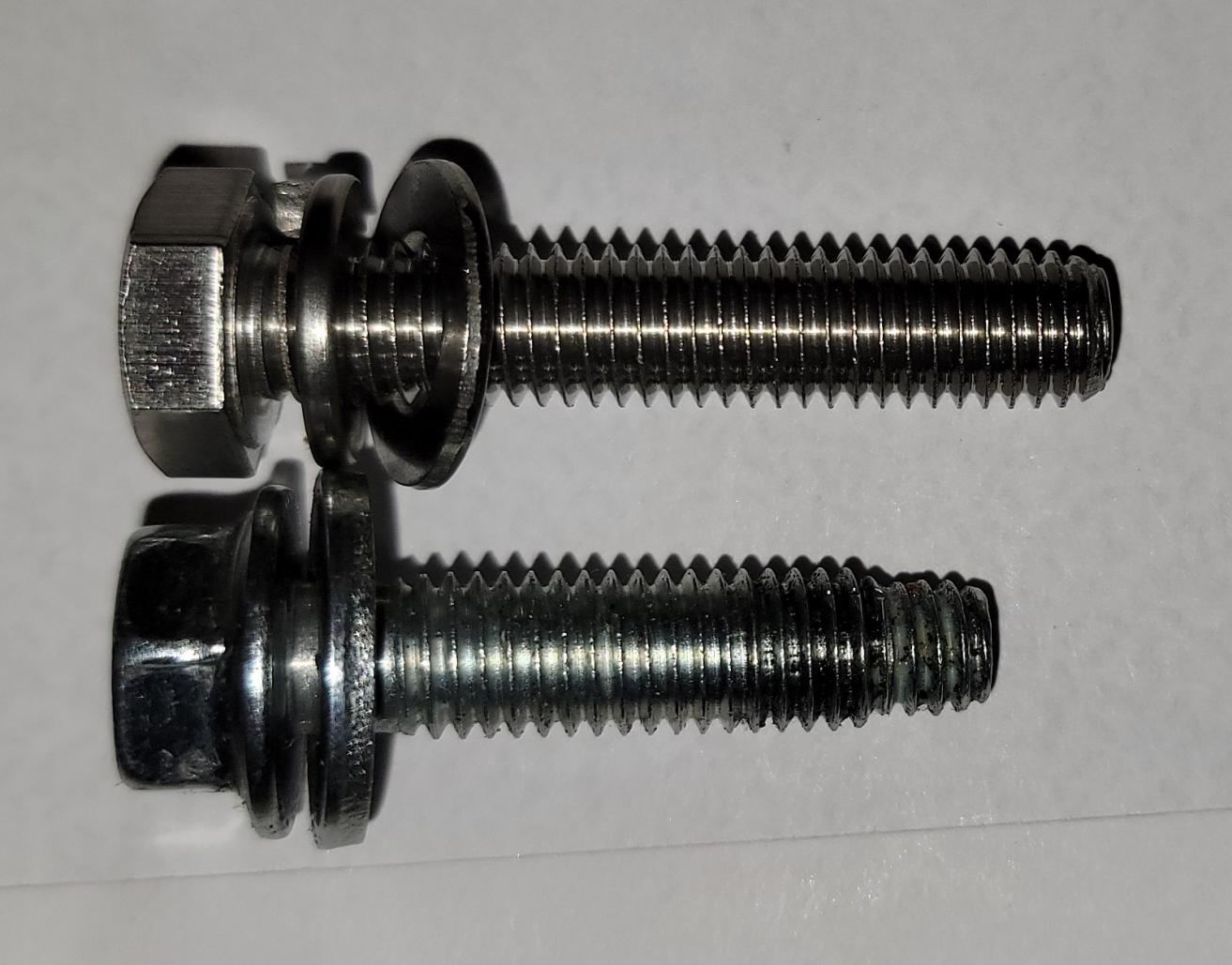

I just installed them. The factory bolts for the outside cross bar are too short after installation.
Top bolt is replacement, bottom bolt is factory.
Trying to make the picture smaller. lol.
The factory hardware is fine if you are not reusing the crossbars. My C4 skids required removal of the crossbars. I think they overlooked that not everyone removes them, especially if they don’t have skids. They need to quickly update the length on these fasteners so that customers don’t have to run to the hardware store.

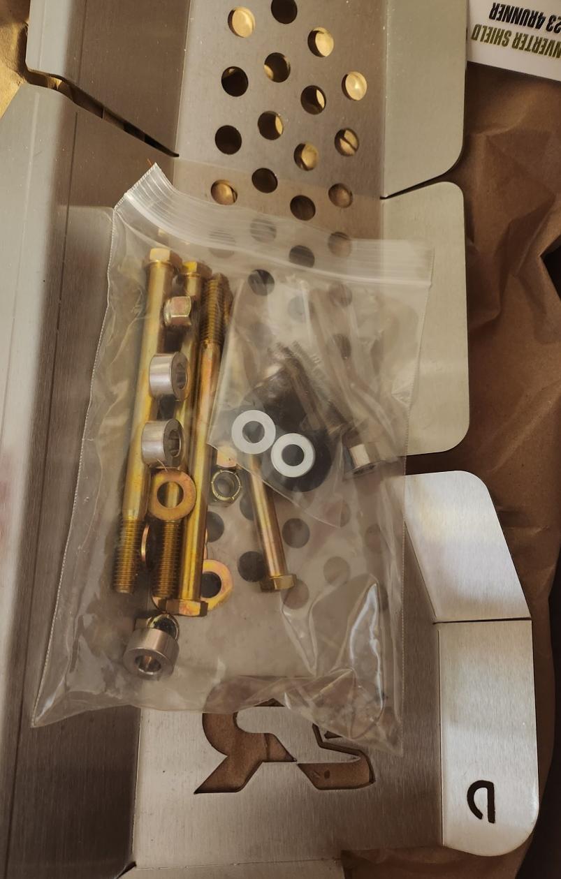

Installation bolts included. Delivered a couple weeks ago.

Of course it came with bolts. I am saying the FACTORY BOLTS are too short once the shield is installed. Did you think I went out and bought all the bolts to install them? Have you installed them yet to find out that with the crossbar they may be to short?

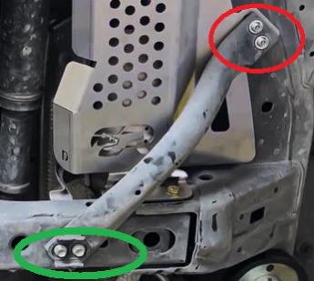

So you say "FACTORY" you mean Caliraised or Toyota? Factory means Toyota to me everything else to "Aftermarket"
Red circle are the tamperproof supplied bolts. The green circle are reused OEM bolts.

The only reason I can think of to have to purchase more hardware in addition to what is supplied is.
Not starting all fasteners before you tighten them. If you do not start them before you torque them then you will need to buy longer bolts.
