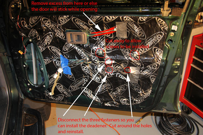

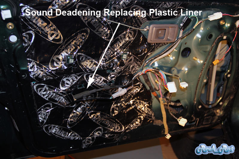

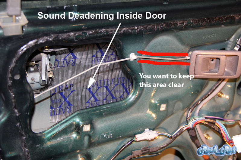

It's been a while since I had made any progress on my sound deadening. I didn't see a need to remove my door panels until I was ready to install new speakers. That time has come. (I went with the Alpine SPR-60C 6.5" Car Audio Component System). This is more than sufficient to meet my current needs and will also support future needs for my either of my sons when I pass this down to them in the future.
Door Panels (for the noob)
  • Removed the arm rest by just lifting up and then removed the two cross-point screws that hold the panel in place.
  • Removed the single cross-point screw that holds the door handle in place.
  • Removed two fasteners on fore and aft of the panel.
  • Removed speakers (five screws)
Sound Deadening
  • I used two 9" tall lengths of the Rattle Trap Extreme for inside the door panel.
  • After removing the plastic (not sure what it's there for, vapor barrier, protect the door during manufacturing, up for discussion I'm sure, ????) I installed a sheet and a half of Dynamat Extreme
  • Completely sealed the door and trimmed as necessary.
Lessons Learned
Do not completely seal along the path of the door handle. When you pull on the handle it articulates outward contacting the sound deadening material causing it to "stick"
The only reason why I used the Dynamat is because I had a package of the door panels from a while back and didn't want them lying around. I still have plenty of Fat Mat left over. I also opted not to use any closed cell foam inside the door.
So now I can say I'm 99.5% complete. I still have the two remaining doors in the back to take care of. Nobody sits back there - not in hurry to finish.
I don't see a need to do the roof.
I have a lot invested in this project but from start to finish, it's been fun and well worth the effort. I couldn't imagine what it would cost to have this done "professionally", and to be honest with you, it still wouldn't be completed to my satisfaction.

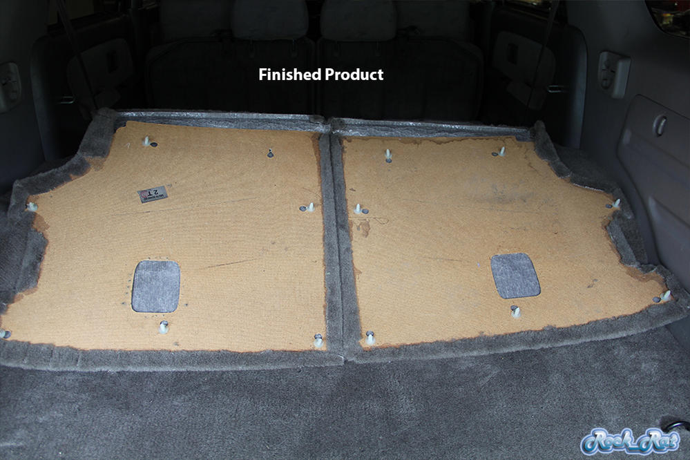

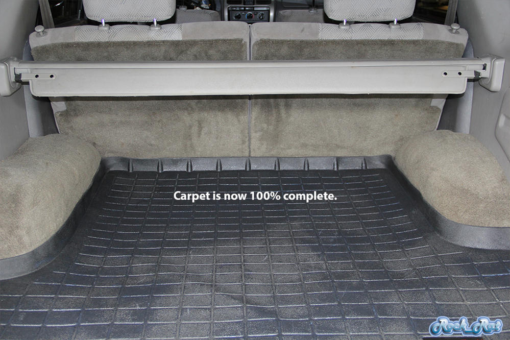

Carpet Installation Complete
I finally finished up my carpet installation. All I've had left to do for the past ...hmmm...at least a year(or two) now is carpet the back of the rear seats. Anyway I did the complete write up in my build thread but here's a pic on how it turned out.
This should just about finish up this thread/project with the exception of adding sound deadener to the rear doors.
